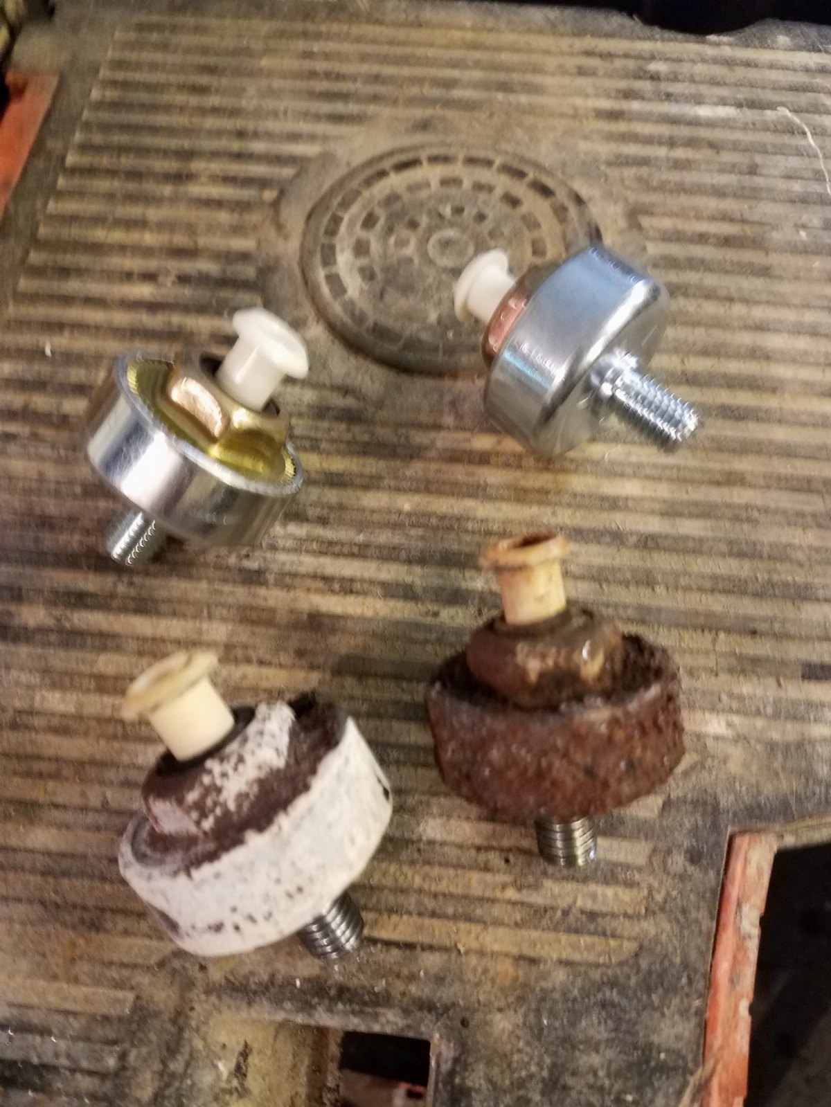

I have an '06, but i'm sure the engines are very similar. I replaced the knock sensors about a year ago and if i can do it anyone can...OK, maybe not my brother in law, but not too hard.. Time consuming but not too hard.
There are several youtube videos on how to do the repair. Basically there is a lot of "taking off stuff" to get to the sensors which are under the intake manifold.
Here's a pic of the new versus what came out of my engine...
Hahaha, that's how I feel about my brother, he cant change a flat tire.
I believe yours is a Gen III, only because you said they were under the intake manifold
