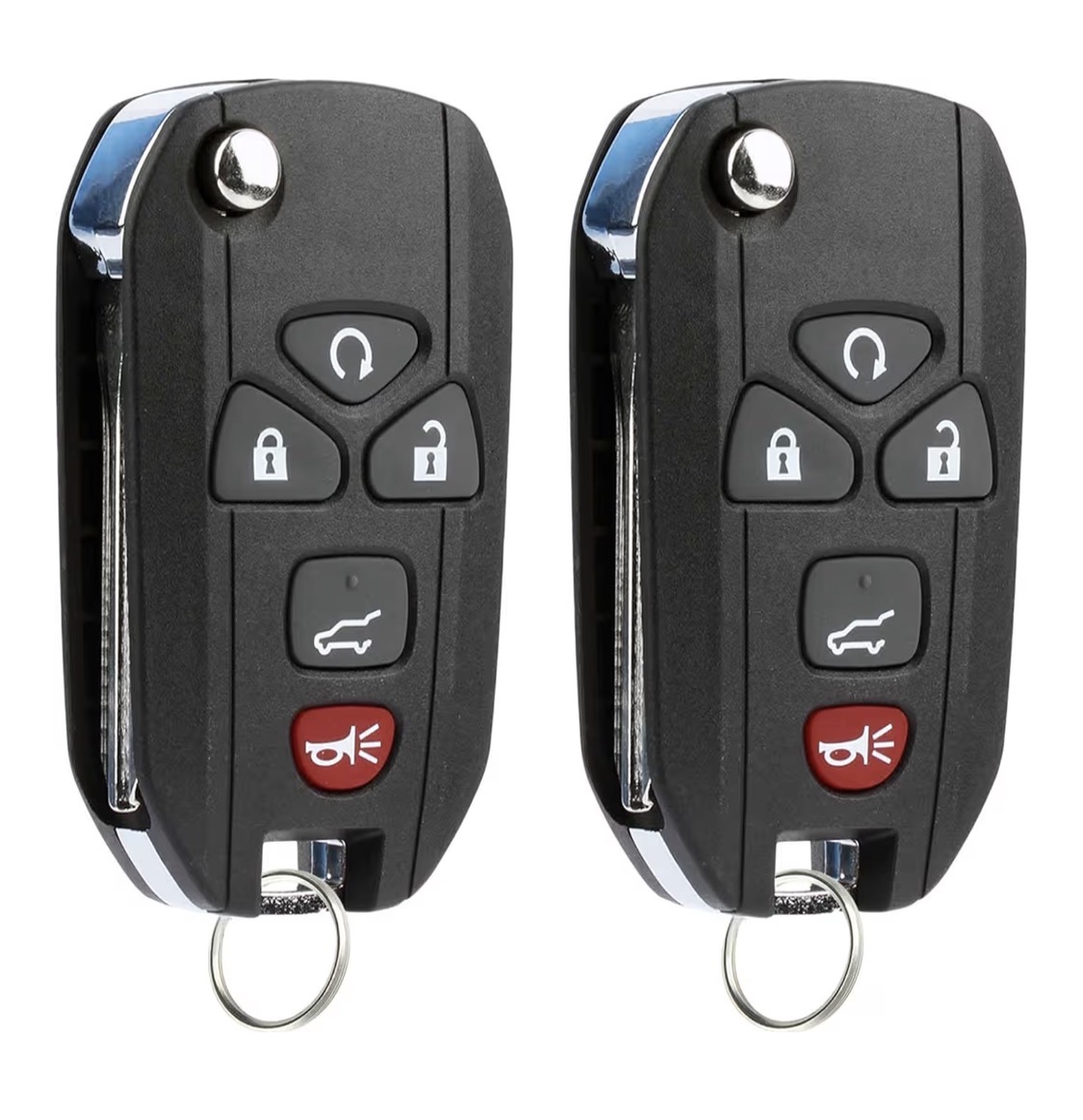

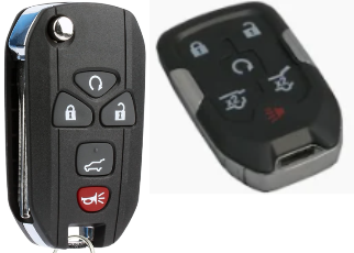

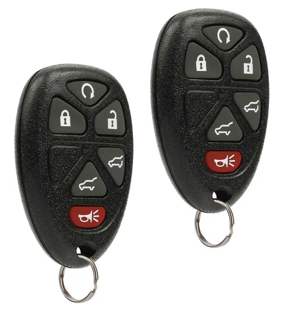

For our Tahoes, we have these fobs...
Our 2013 uses the one on the left from Amazon (link), our 2008 uses the one on the right from Boost Auto (link). Either will work on either year model. You can program these yourself in a couple of minutes. Some people use scan tools, but all they really do is step you through the process.
Note that the flip out key on the left fob is useless. There isn't enough room around the ignition for it. You just continue to use your original key. The fob on the right does have a pullout key that i believe can be used as a valet key. I don't use it myself, so unconfirmed.
