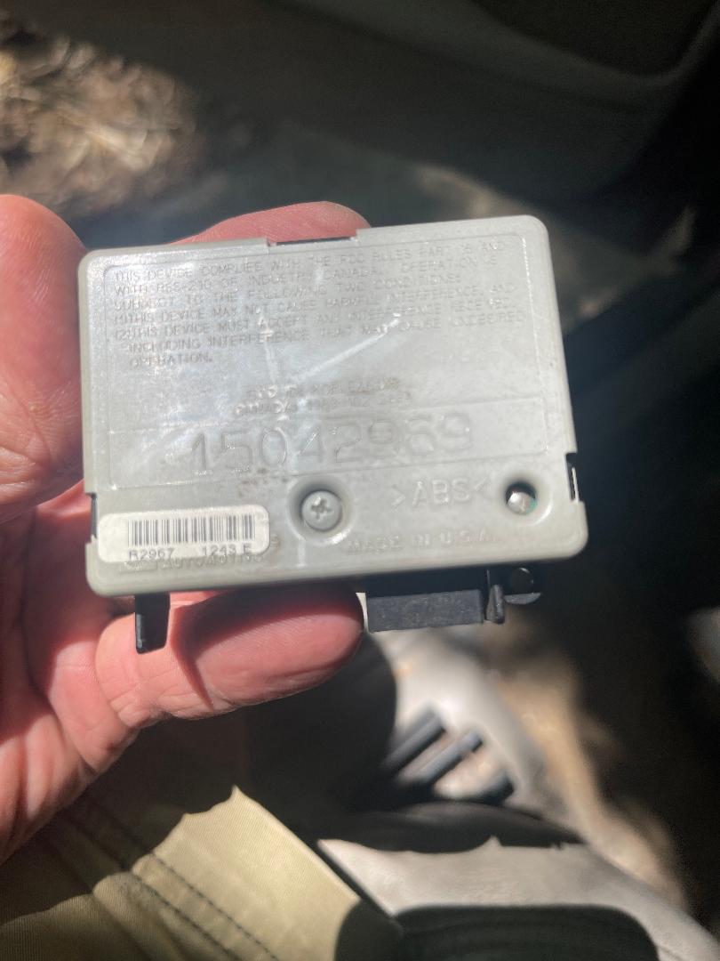

I'm assuming mine is the module. I have new batteries in my fob and still does the same. I can hold the fobs by the windshield and they work. The module is discontinued so I will see about getting a used one to see if it works. It looks like this has probably happened before on my Yukon because when I went to take it out the tabs are broken and it is just sitting under the dash.

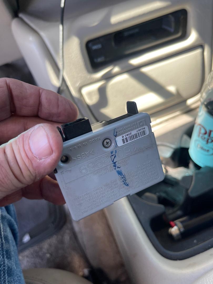

Finally got a used RKE Module from the junk yard this weekend ($8- they are $40 to $75 on Ebay when you can find one that is the correct number). Just put it in and key' fob works now. My second key fob doesn't work but I assume its the battery or the buttons. I'll mess with that one and get it working.
