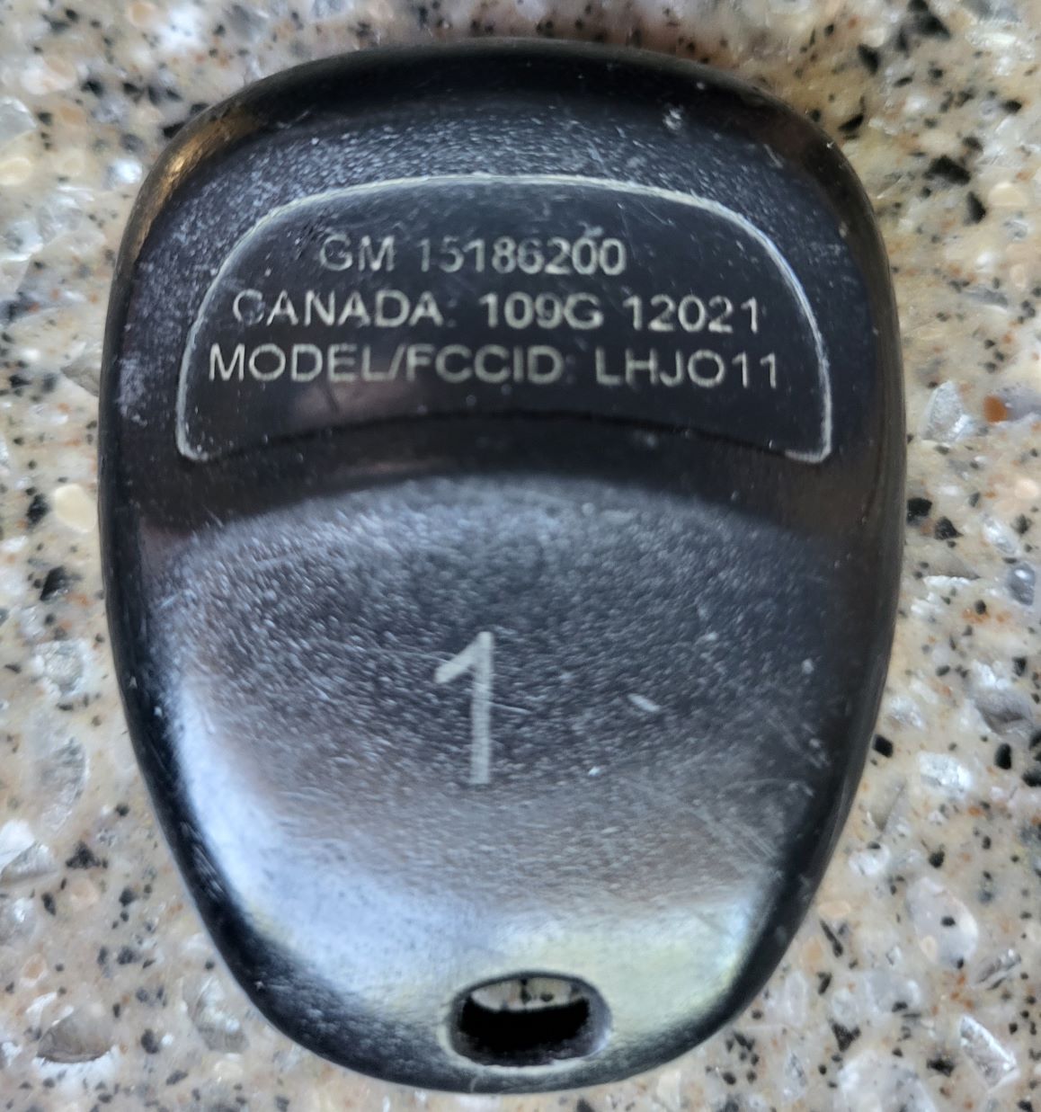

Long ago I picked up two aftermarket FOBs for my '04. When I went to program them, the OE (Driver 1) FOB wouldn't program, but the new ones would. I recall attempting the programming a couple of times that day but couldn't get it to accept that OE FOB. But the two aftermarket FOBs were accepted and programmed.
Note that once you initiate programming -- successful or not -- it wipes all existing programmed FOBs out of the BCM.
If you have your OE FOB, look on the back to see what the FCC ID is; your replacements need to be compatible with your OE FCC ID, as @Tonyrodz noted. Here's mine, but yours may be different since it's an earlier model.

You could always pick up some new fobs cheaply from ebay or Amazon. Just make sure the new FCC #s are compatible with your old one. Cheap and quick. You could find 2 for $20 or less.

Thanks for all the replies. The original I have doesn't have any markings on it, so I'm thinking it may not be an original GM unit that would have come with the truck. I did order a couple new ones and found a local locksmith that I'll have program them for me. Hopefully that'll do the trick.
