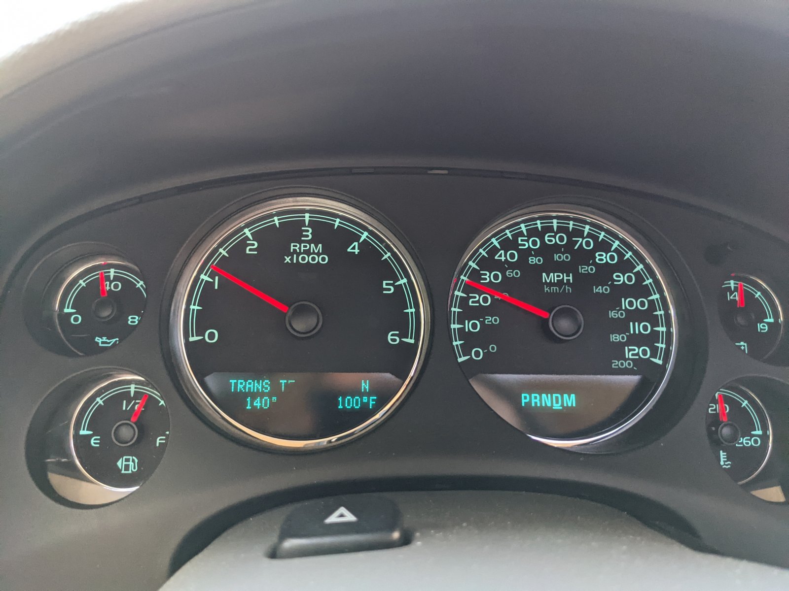

With your TruCool mounted in front of the Rad, have things still been good regarding coolant and Trans temps?
I got these pictures in stop and go traffic. I will go up the mountain tomorrow. Highest my trans got was 145 today and it was 97 degrees out. My fans did kick on to HI 2 or 3 times though. I also had the A/C blasting.
I didn't hook up my tech2 to check engine temp, but the dummy gauge stayed at the normal center spot it always is at

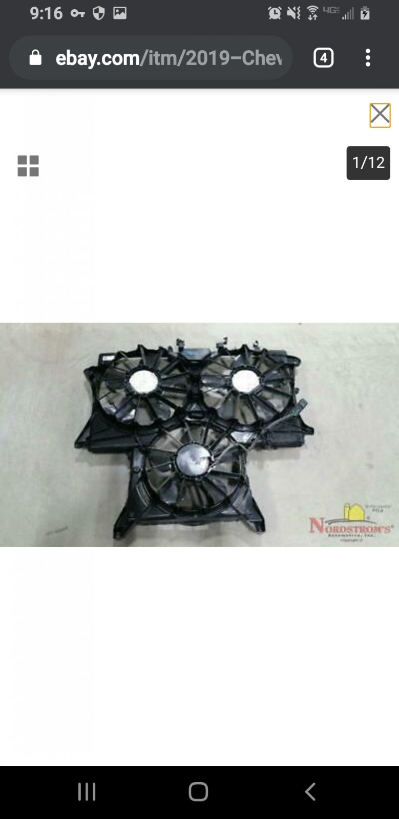

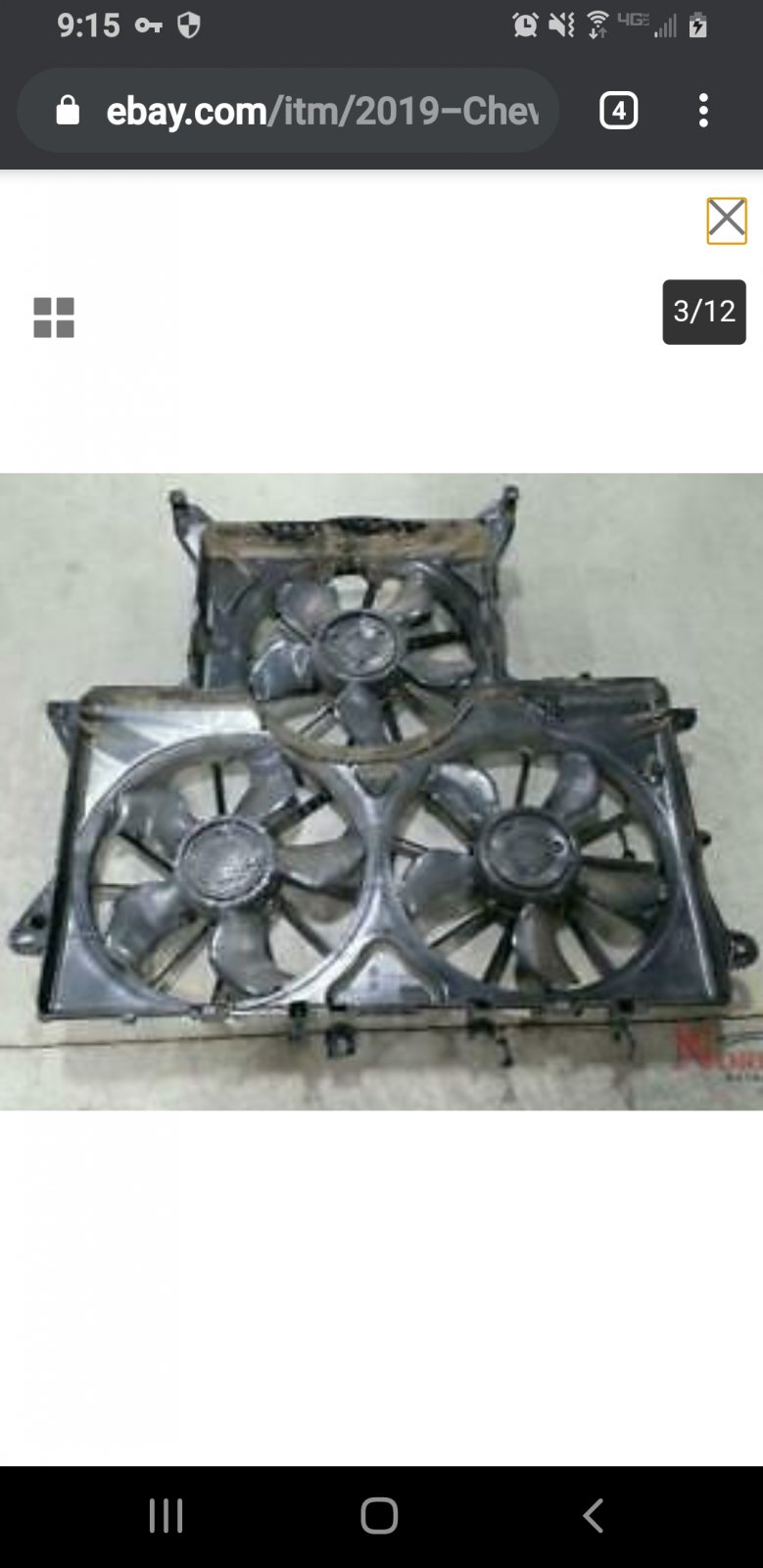

Maybe someone should modify one of these to work in our style...haha
You’re thinking outside the box, but why stop at three? Four would make things a little more even down there. Haha.

Holy sheep $hit. I don’t think I’ve pushed mine over 98mph. Which is sad considering I’m running a 6.2l.
there is no room, so unless you stacked them with reversing motors it won't work
