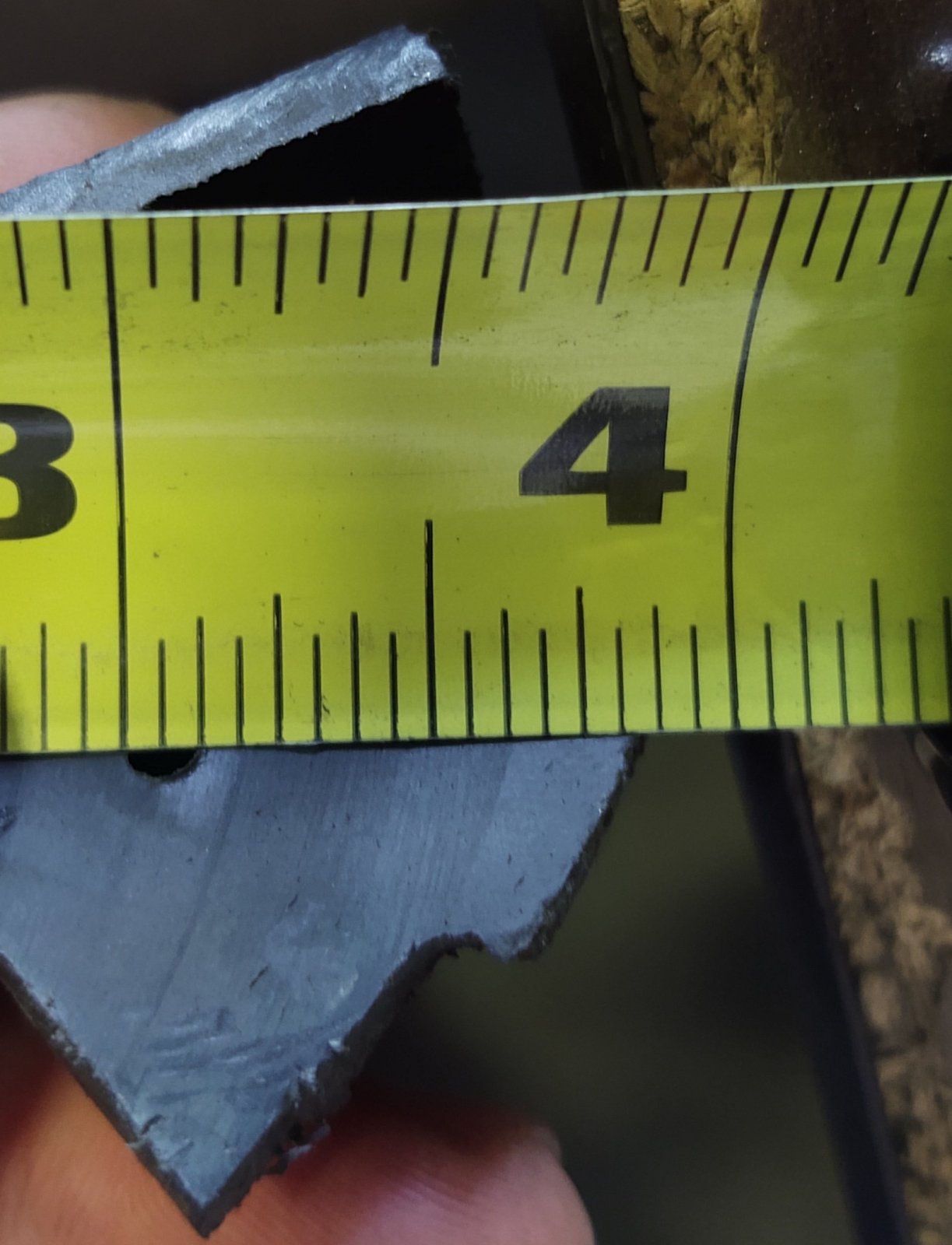

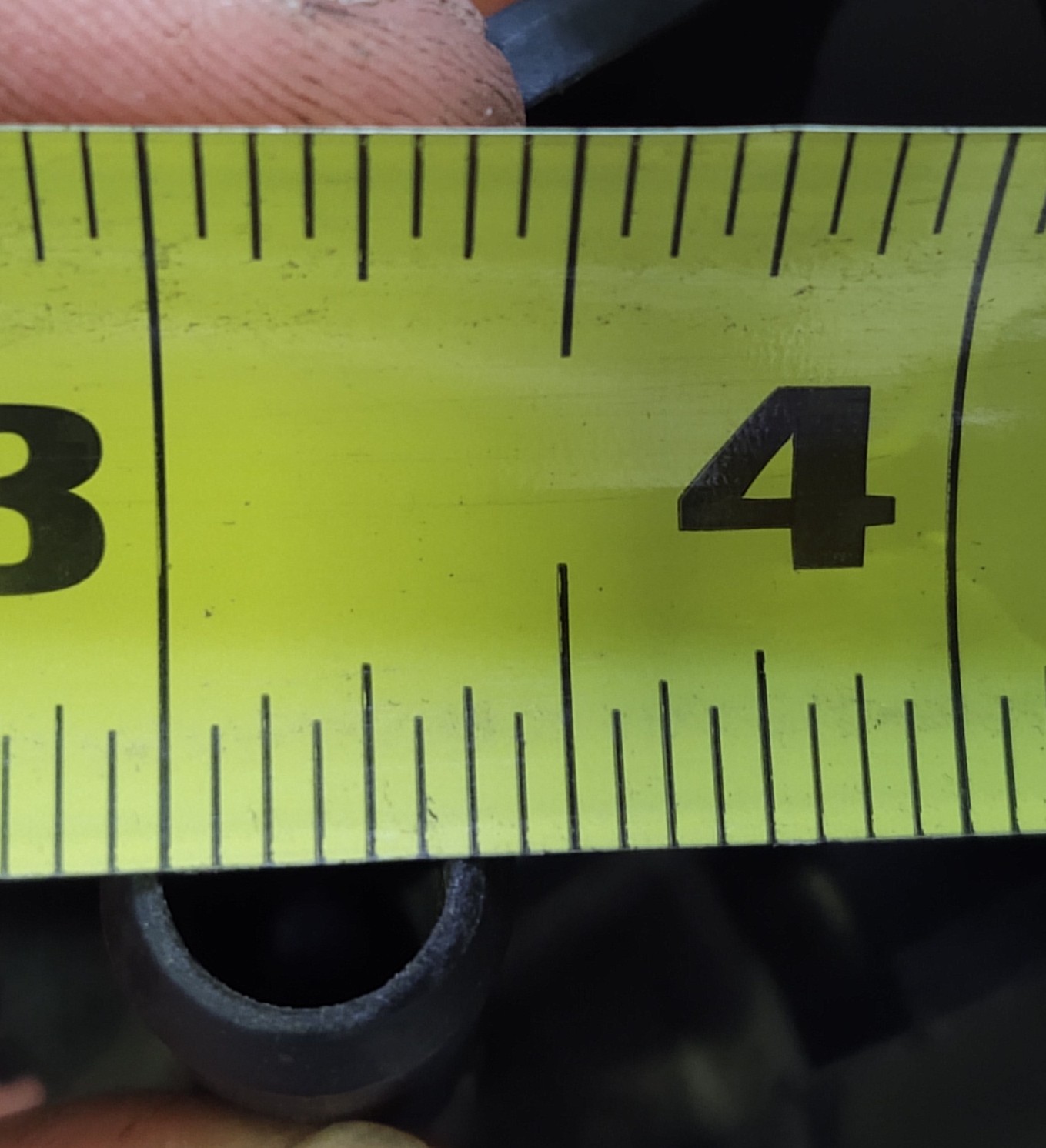

Mutilated the junk stock end tank.
ID for the overflow is 3/8"
But on the inside of the tank, it's only 1/8" for the restrictor.
So now I know what to aim for on the Cold Case fix.

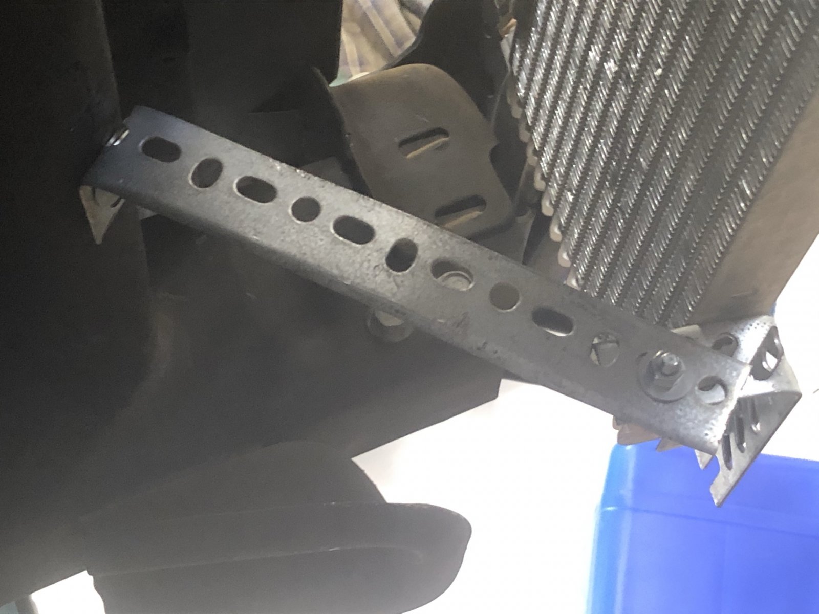

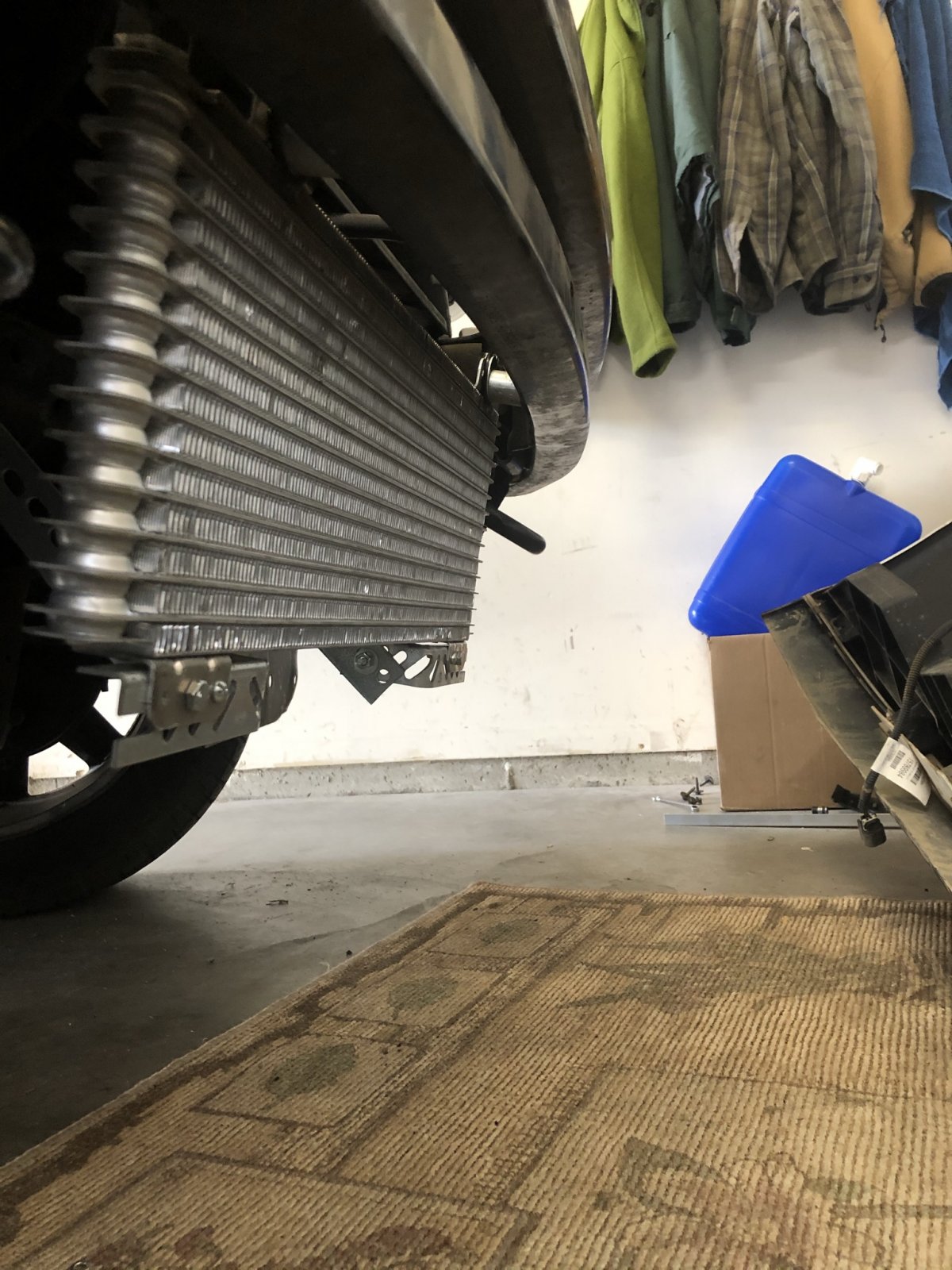

Yeah, I have mine in front of the radiator only because that's where the factory auxiliary cooler already was, but when I put the supercharger on, the intercooler for that will be taking up the real estate I'm using for the true cool that I put there. So I'll end up finding a spot underneath somewhere, likely putting a fan or two on it. But that's a good little ways down the road still before I need to worry about that.

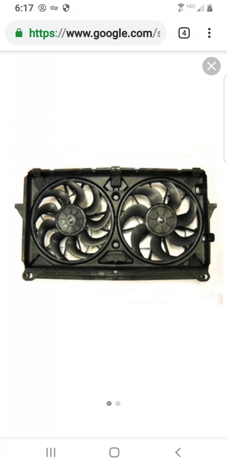

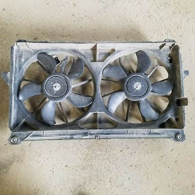

fans should both turn at the same speed there is no left/right control, I believe the 7/9 blade design is only for noise control, then they went to a 5/5 blade

The 7/9 is rimmed, the 5/5 have no rim - both shrouds look different in the front too. I have both styles of these fans, all 700W motors. Honestly I don't know which ones flow best, but I find:
7/9 rimmed is in my 06 Sierra Denali with LQ9 all stock and original radiator with 186k on it, temps sneak up just past the middle line in 95+ degree weather, these fans are much quieter, even on hi.
5/5 is in my 09 Tahoe with L9H and mishimoto radiator and I haven't seen anything over 200 degrees, not even in 100 degree weather. These fans are very noisy, but that's a small price to pay to keep things cool. With the windows up, I can't hear them.

I have the 5/5 setup. Im surprised that I don’t have enough air moving thru that radiator at speed to keep things cool. I know the driver’s side fan has a high speed but have never heard the passenger side fan hit a higher speed. Should it? I have read somewhere about getting an H P tuner (?)to change settings on one or both of the fans. Is this someone at a performance shop can do? Looking for answers.
30,566
48,047
I could be wrong but there is 2-fans, 2-speeds hi/lo, 1-relay. no way for them to spin at different speeds unless one motor is defective.
