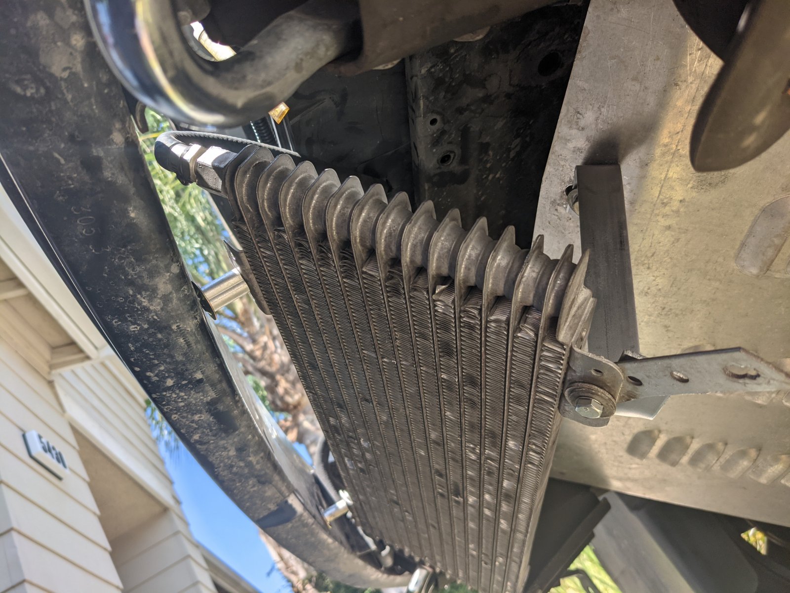

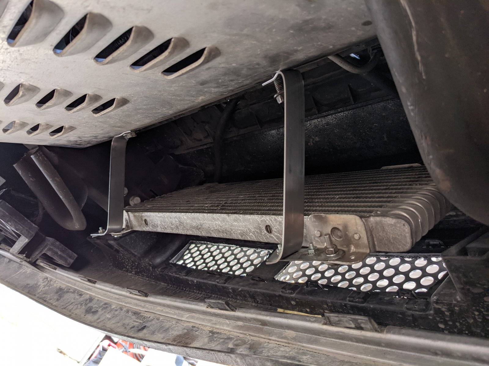

So far Dropping the Tru cool to the lower grill area there are holes on the inside back of the front bumper and they line up pretty well with the Tru cool mounting tabs, so do the 2 top bolts of the splash guard/skid plate, I just need some 1 1/2" metal to make the last 2 brackets

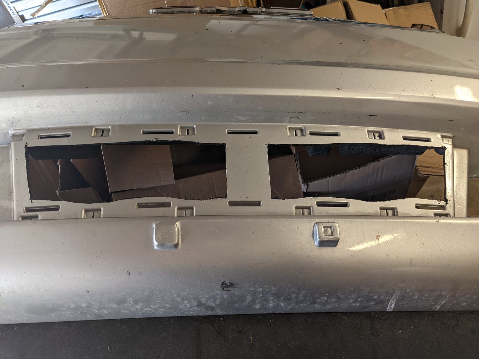

I made a 500 mile trip on Sunday, I have the tru-cool mounted in front of the radiator as pictured above, since my transmission was rebuilt with extra clutches and etc, it seems to run a bit warmer than it used to, at 7-8000ft elevation and 90deg's ambient, ac going and moving at about 75-80mph transmission heated up to 193, that was not the issue, the issue is this made the coolant heat up to 230deg. turning the ac off seemed to help a smidge and coolant temps were then up and down to around 220-225, so I am planning on moving the tru-cool down to the bottom grill and doing like others have and opening up the lower grill holes, just have to figure out some kind of mount. not sure how much air flow it will get at that lower grill or if will effect any other cooling I am thinking probably not because the lower part is below the center of the bumper cover that should be splitting the air 50/50? up/down

I am 99.99% sure it is only because of the tru-cool being in front of both the ac condenser and radiator, I almost have it all back together I just have to go grab a new ambient temp sensor when I went to move mine back where it should be the plastic clip is all brittle and broke, $6 part so may as well just replace it.

All wrapped up, test drive around the area trans ran about 150, after I warmed it up real good and let it sit and idle it sat at 165 with no fan, its about 95degs outsideView attachment 343853
This set up is so much better than in front of the AC condenser/radiator.
