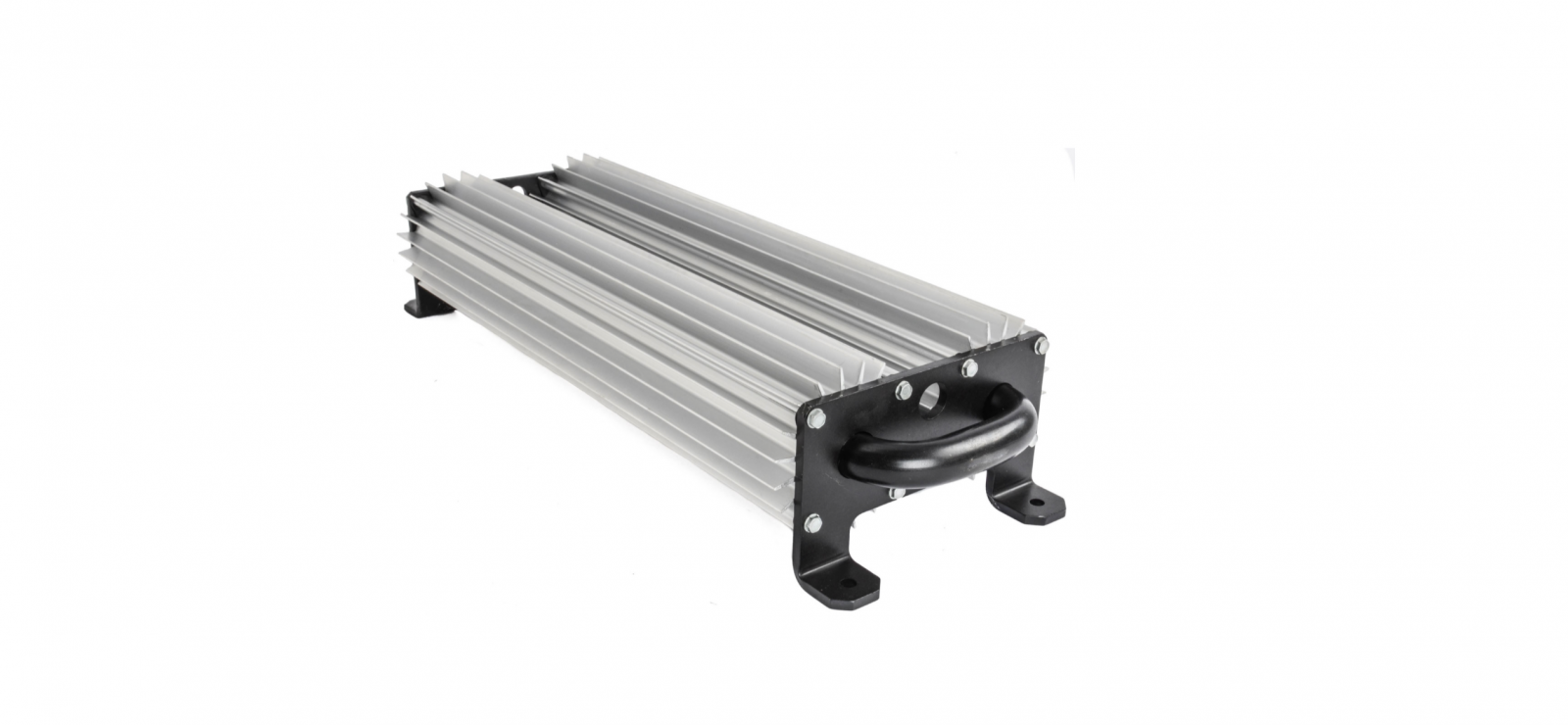

Have you guys seen this or one like it. Granted we are all partial to either the Tru-Cool or the Derale, but this design seemed like a great idea for mounting in the lower bumper area.
I considered this type of cooler, but it's also passive and couldn't find the BTU rating for it anywhere. Hard to believe that it would cool as well as a plate and fin style cooler does.

Those type of coolers are basically for race only type apps... Good for cooling for
a few minutes at a time... But NOT for a regular driver, esp not for a tow vehicle...
So stay away from it
there was one review
"Running on a TH400 with a 5500 stall (yes high slipping when cruising) This cooler was not enough on its own. I had to install a second cooler in addition to this one. Product itself was high quality and like the inline filter feature."
I used a flex a lite first before the tru-cool, the flexa lite is a tube style like that one, it didn't really help at all.

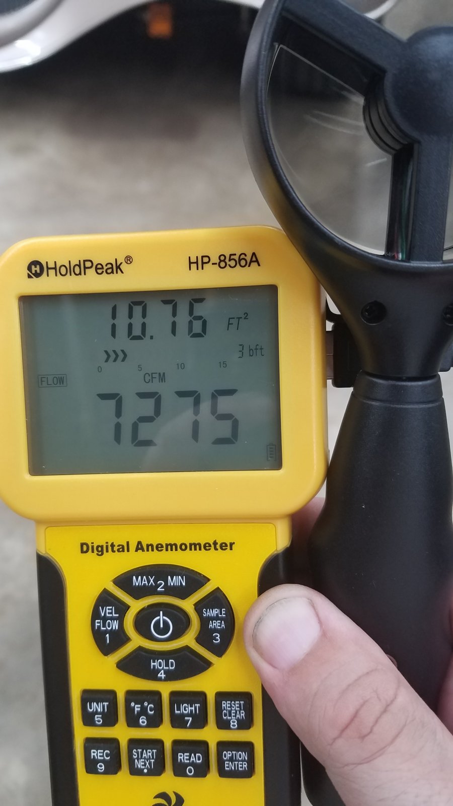

So for future reference I just measured the cfm of the 700w 7/9 rimmed blade (k5l) fans both sides measured approx 2300 cfm on high, measured inside the engine compartment right up against the fan, can anyone measure the dual 5 blade non rimmed 700w? You just need a anemometer

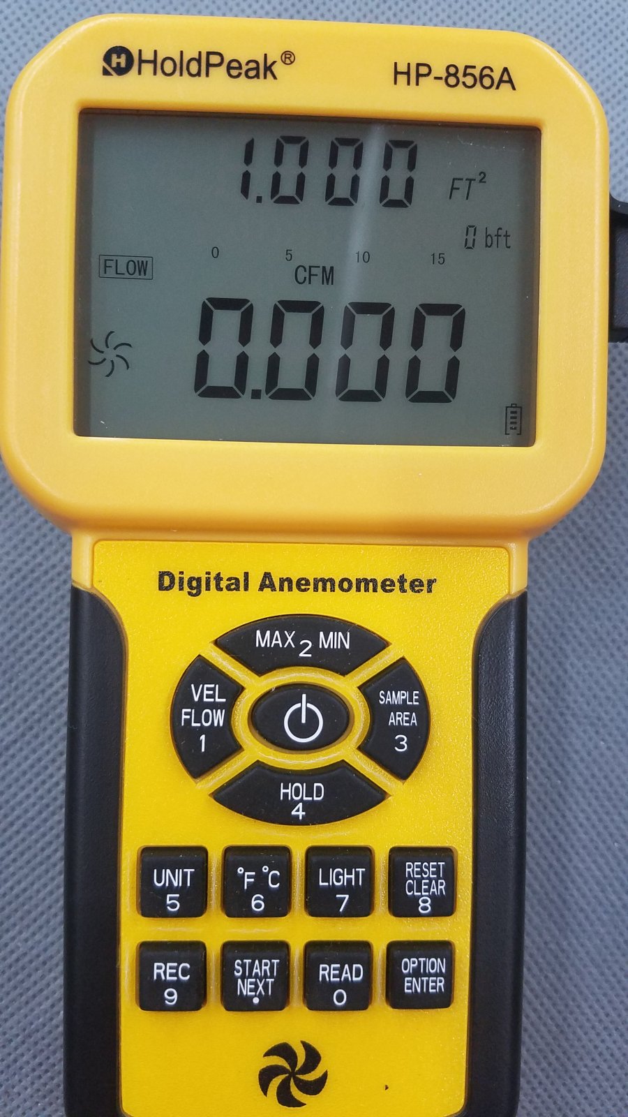

I have this same meter and wanted to get a comparison reading on my fans. What settings did you use for your reading? I know you can enter in a sq ft variable before taking the cfm reading
30,566
48,047
I just pushed the button until it said cfm, then made sure the fans were on high, usually you can make them go high with the ac on and idling, mine is tuned to make the fans come on at a lower temp.
Apr 11, 2018
7,124
14,375
St. Louis
You have to have a sample area set. The meter does remember the last one entered. It's the top number on the screen and is in squared feet. 20210712_103141.jpg
