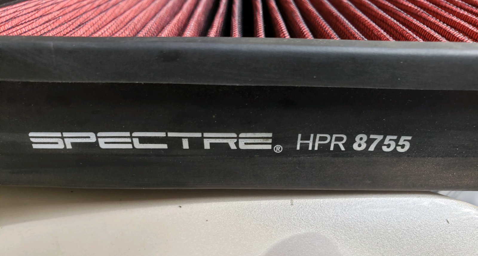

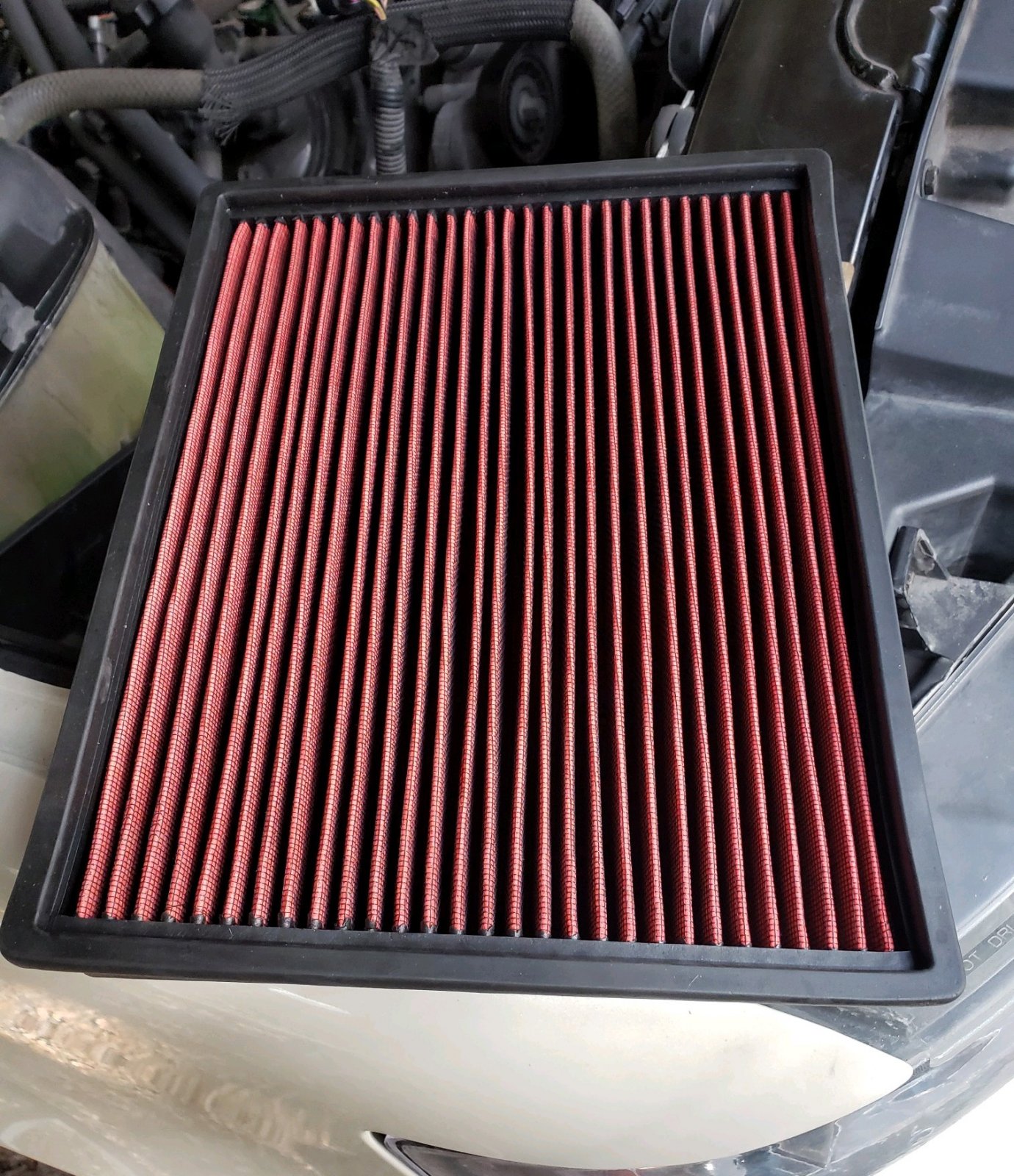

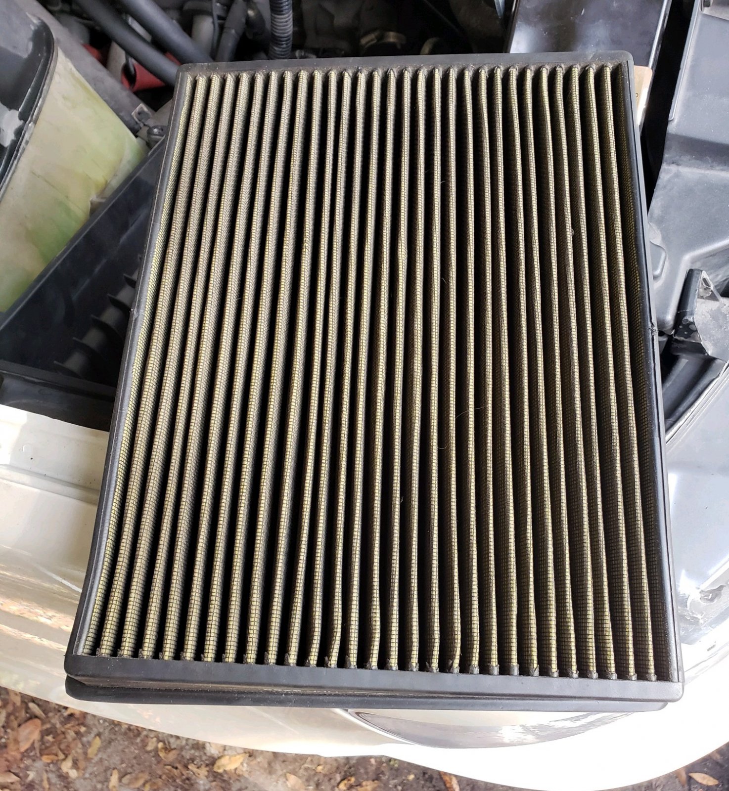

Also, I accidentally lied to you about my "K&N" filter... when I pulled it today to clean it I realized that it is actually a Spectre HPR8755.
The last pic was before cleaning and re-oiling.
Well, damn. I wonder if that's where the elevated silica level is from? Did you happen to check the inside of the intake tube for dirt?
This reminds me of the lawsuit K&N won against Spectre:
"...The federal court also addressed claims by Spectre regarding the independent laboratory testing of its Speed By Spectre hpR filters, which were advertised as having been "proven to filter 99.6% of particles." The court found that the company did not select an air filter from a production run for these tests, and instead used a specially designed test filter, providing no basis to find that any of the filters actually sold to consumers would have the same efficiency as the test sample."
Huh, never heard of that. You never cease to amaze me with your obscure knowledge... lol
I did wipe the inside of the intake tube and there was nothing to speak of to be seen on the white napkin I used.
This filter has been in since well before I started doing UOA and it has never been a problem before. I think it was just time to clean the filter. It was dirty, not as bad as some I have seen in the past but dirt did come out of it when it was cleaned.

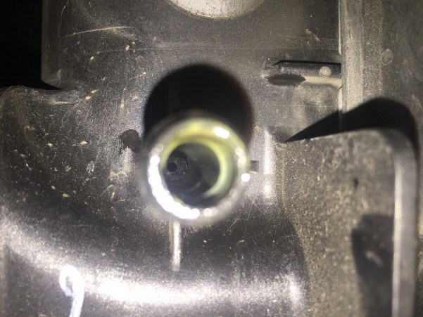

BTW, I found a pic of the factory rad restriction orifice:
It's tiny! So, it obviously has a significant function.
I tried to take a picture of my original but never could get a good angle. I couldn't see that in mine.
