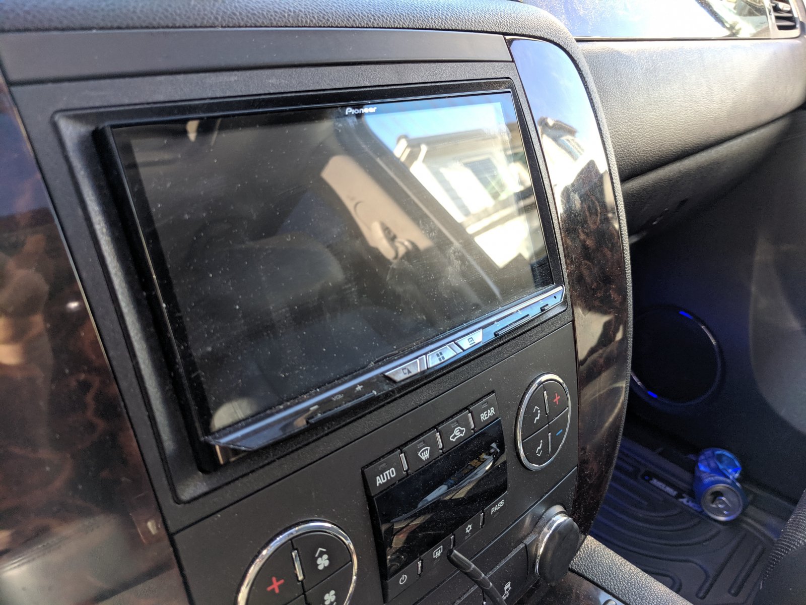

Well I got the Kenwood installed.
I guess the Metra dash kit "fits" the Kenwood and it was partially my misunderstanding the directions. The pics make it look like the stereo has to slide into the dash kit from the front, which it would not do. In reality the radio slides in from the back which leaves it sitting too far back in my opinion, which I why I said it didn't fit because it just looks wrong to me.
I searched a few different places and all the dash kits make the HU recessed which I did not like... so I ended up modifying mine as follows...
Before/unmodified...
You can see how it's set back... I did not like the way it looked.
So I trimmed the back side of the dash kit to make the stereo sit flush with the dash kit.
After/modified...
This is the way it should have fit right out of the box in my opinion.
Anyway, it's all in and working beautifully. Now I just have to get used to the new interface and where all the stuff is in the different menus and what not... mainly the whatnot... lol

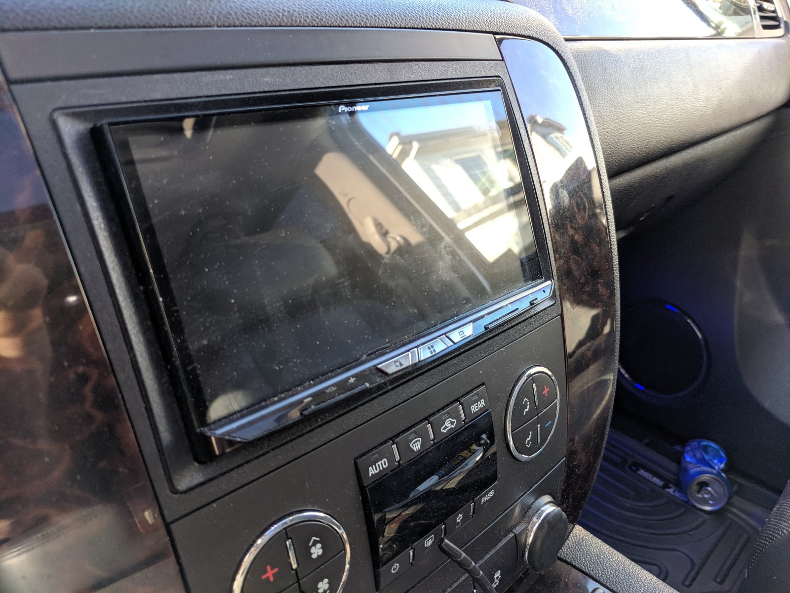

That must be a Kenwood thing. Both the Pioneers I just installed didn’t have anything that would keep the HU from sliding back flush, and there were multiple threaded spots for the attaching screws to go into so the kit ends up flush. I’m surprised the Kenwood wasn’t the same. Anyway, glad you got it in. I spent all day installing compressors so we both should get attaboys lol.

Looks great! Agree that I would prefer it to be either flush, or even slightly protruding.

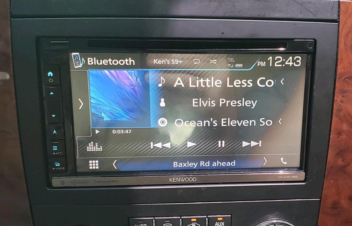

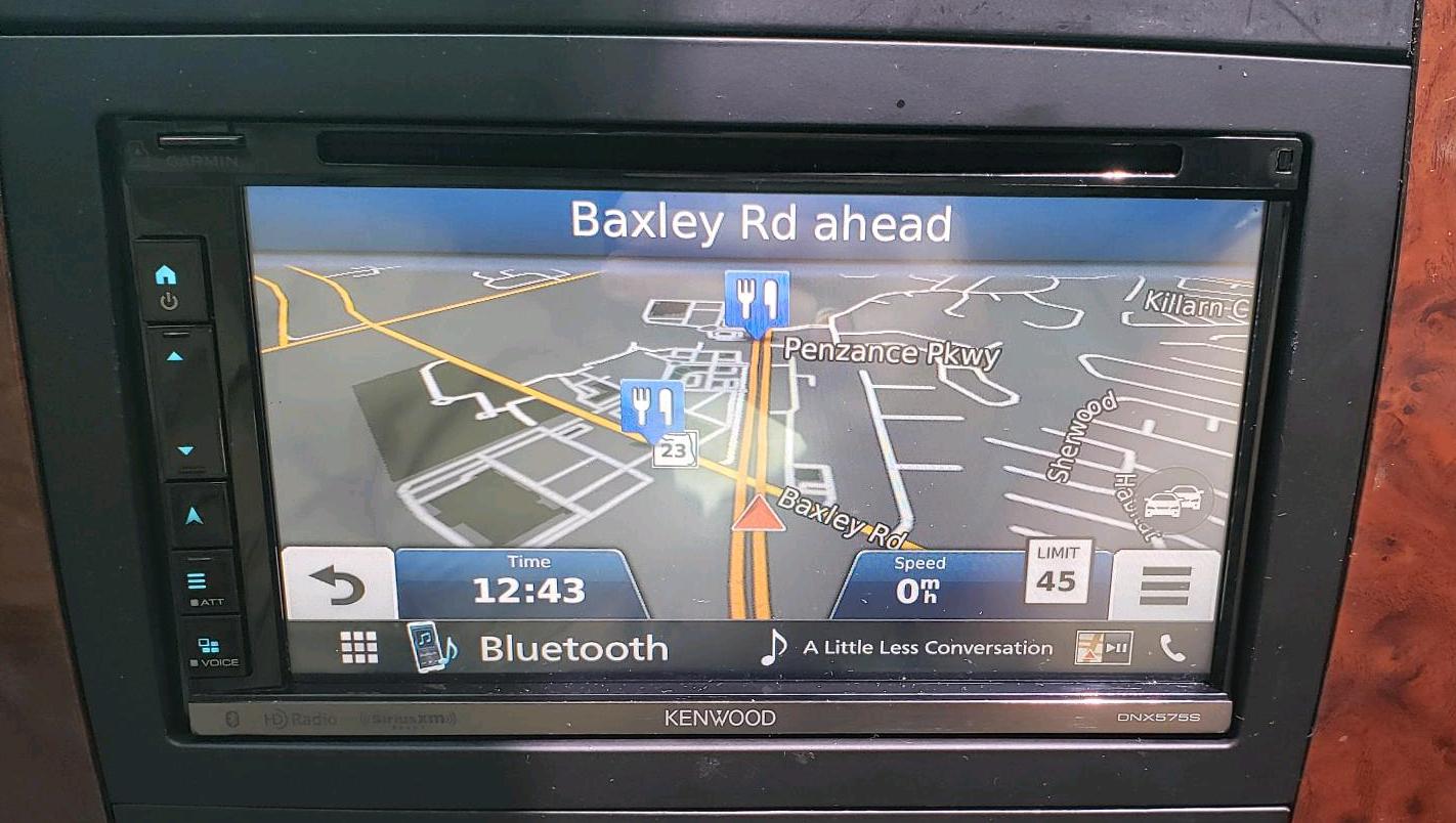

Got a couple pics for you today so you can see how the navi works.
You can see the name of the cross road you are approaching at the bottom when not on the navigation screen...
And you can see what song is playing at the bottom while in the navigation screen along with what source it is playing from...

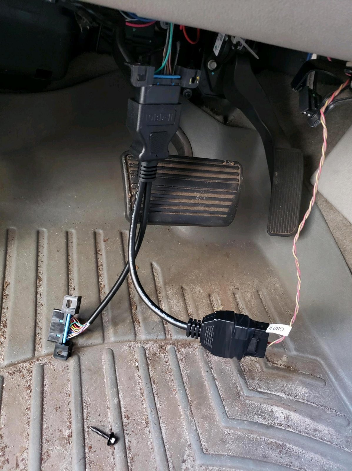

I received my OBD2 splitter today. I hooked it up and got it mounted...
This is after I mounted it in the factory location...
It accomplishes one goal that I had which was to be able to hook the data lines to the OBD2 port without splicing into the trucks harness and without just plugging the stereos connector into the port and seeing the wires hanging out from under the dash.
I tried using the gauges on the HU and OBD2 dongle with my phone and the Torque Pro app and it was EXCRUCIATINGLY SLOW.
It also makes some of the gauges not work on both devices.
If I turn the HU off it works as expected on my phone.
The moral of the story is... the data coming through the canbus lines is just not strong enough to feed both connections at the same time.... oh well, you live and learn, at least I don't have wires hanging out from under my dash and if I need the torque pro app for something I can't do with the HU I will just turn the HU off while I use the app... simple as that.

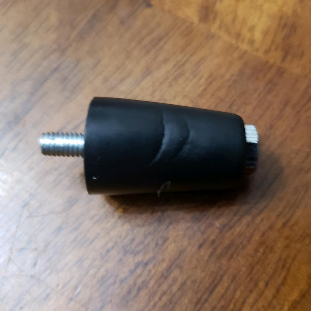

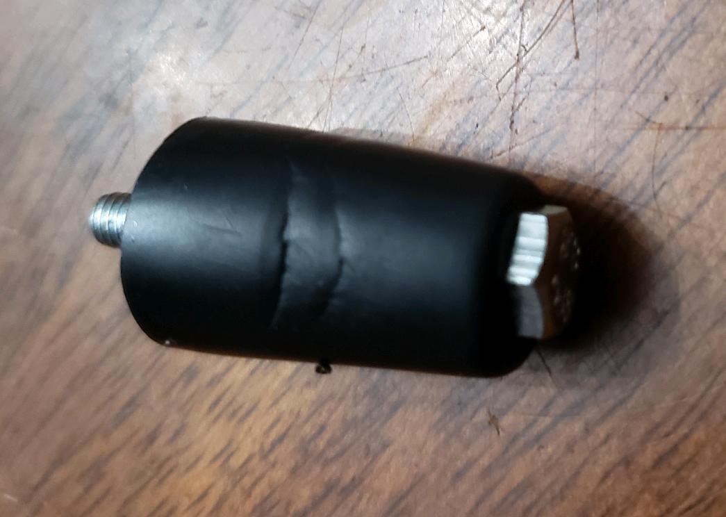

Also wanted to mention that my Kenwood didn't come with the little rubber piece that goes into the hole at the back of the dash.
I was going to re-use the one off the Rosen but the bolt was bigger in diameter and wouldn't screw into the Kenwood.
I ended up removing the rubber from the bolt on the Rosen and drilling a hole all the way through it and getting a bolt from the hardware store that fit the back of the Kenwood and mounting it that way...
More than one way to skin a cat as they say.
