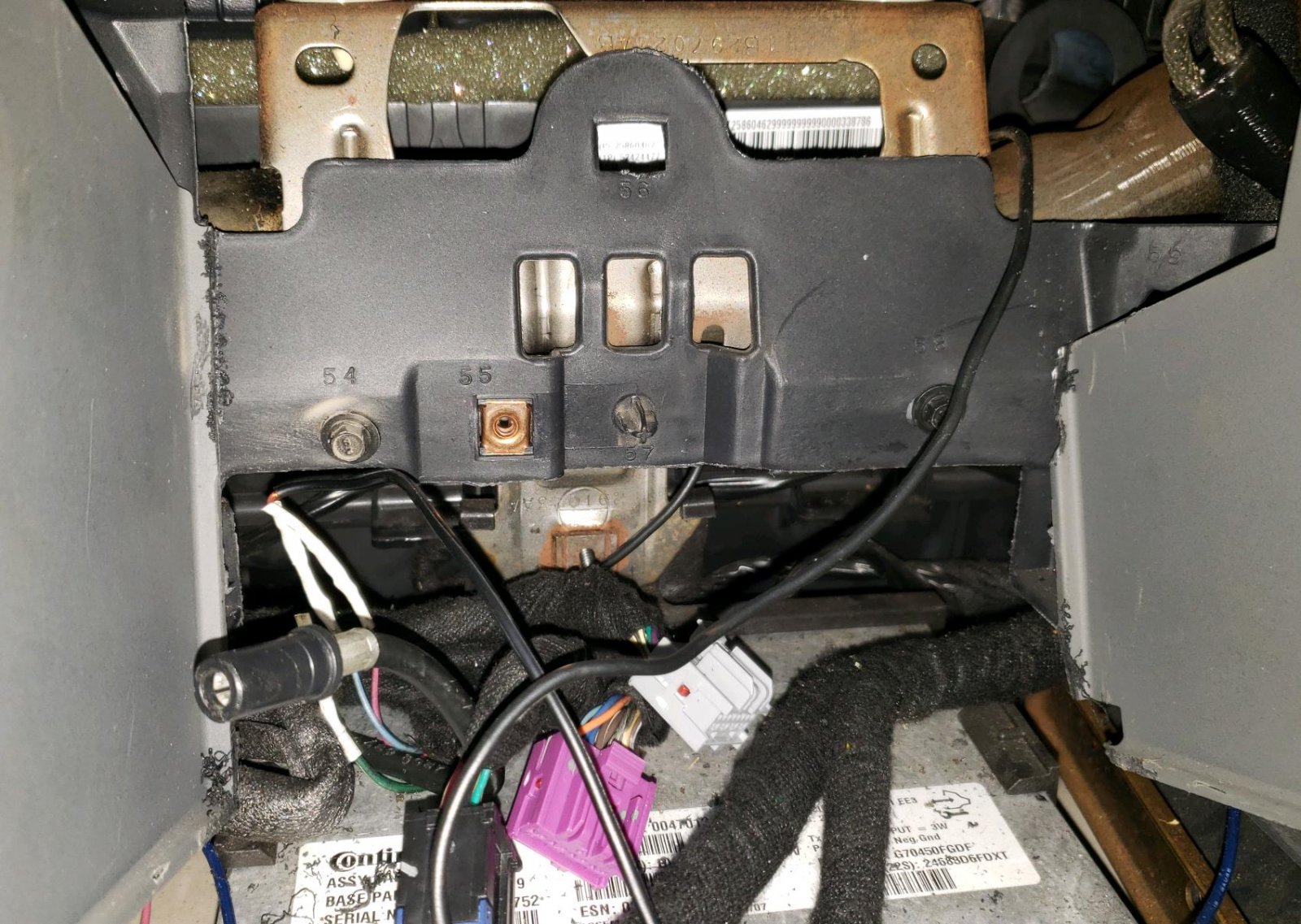

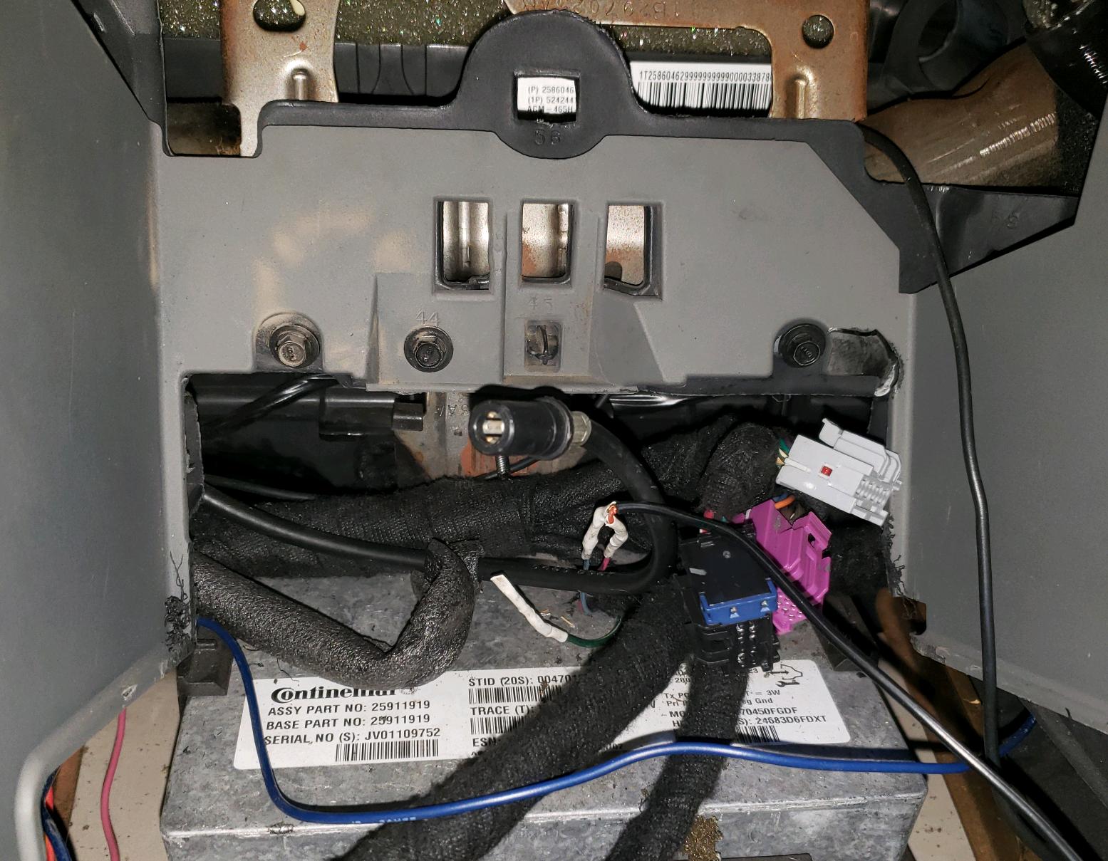

I went ahead and pulled the Rosen out along with all of its wiring harnesses since the Kenwood should be delivered any time now.
I also went ahead and cut some of the plastic out to give me some more room and hopefully make the install easier.
Here is the first piece I cut out of the bottom...
Then I started up top... before...
Removed this piece...
More black plastic behind the grey...

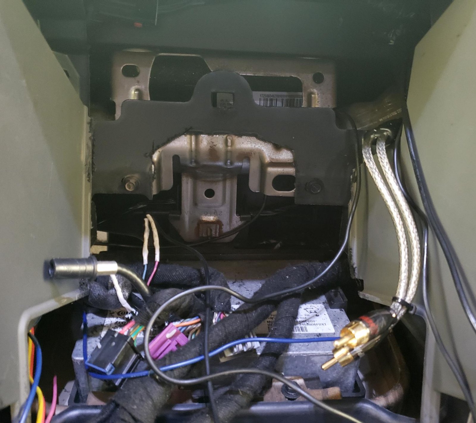

I trimmed a little more just for good measure and this is the final result...
I wanted to leave the square hole up top in order to support the back of the HU... plus there is not much to be gained beyond this point without cutting metal.
Now I hurry up and wait for UPS...
You may end up cutting metal, fyi. Lol.
I hope not... the Kenwood I bought is the one that Crutchfield says fits my Burb... so I shouldn't have any issue I hope.
The Rosen had a ton of wiring harnesses and external door chime speaker and all and it fit in there without trimming anything so this new one should just about fall into place... lol
Hoping for you, too. I have never dug around in there on mine, just read a lot of guys cutting that metal brace out of the way.

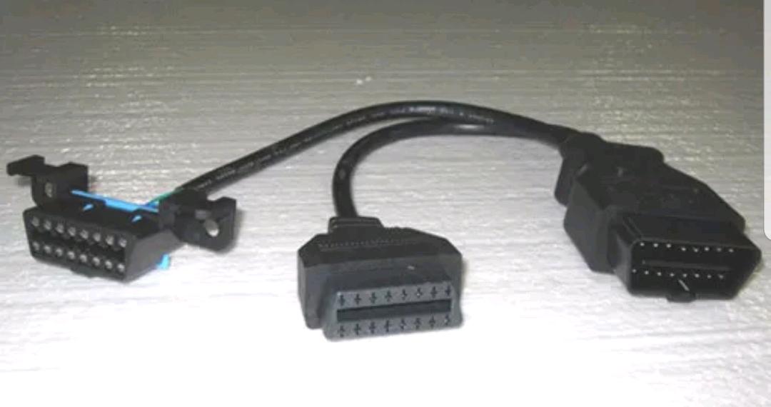

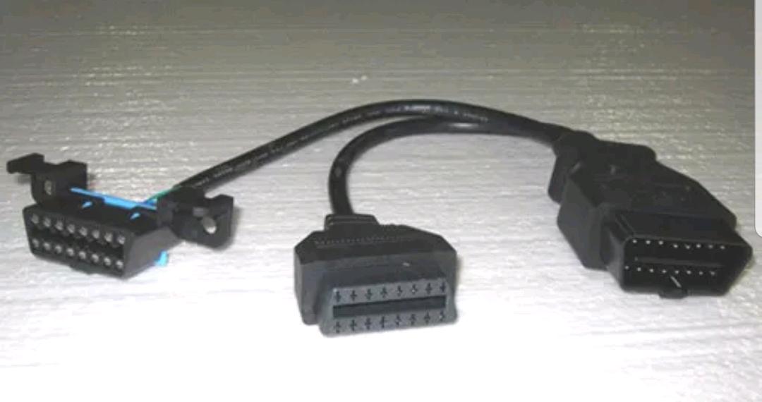

I also forgot to mention that I bought a Y-splitter for the OBD2 port under the dash...
This way I can unscrew the original from the bottom of the dash and plug this into it and plug the OBD2 plug from the Kenwood into the one side and remount the other end that is designed to be mounted back to the bottom of the dash and it won't even look different than it did from the factory and I can still use my bluetooth adapter with the torque pro app on my phone if I need/want to.
I know i could have just spliced the two wires in behind the factory connector but i didn't want to hack up the trucks harness.
I like that. I could use one of those.
I was able to cut the same plastic from my 08 Silverado and fit all the harnesses and adapters in by sliding them into areas below and to the side in the back. The stuff takes up a lot of room, and it has to be nestled into place as you slide the HU into place. I spliced into the OBD wires, but I’m pretty sure it was only one wire from the HU that connected to it.
That's my plan as well.
The Kenwood has 2 wires... high and low for the canbus system.

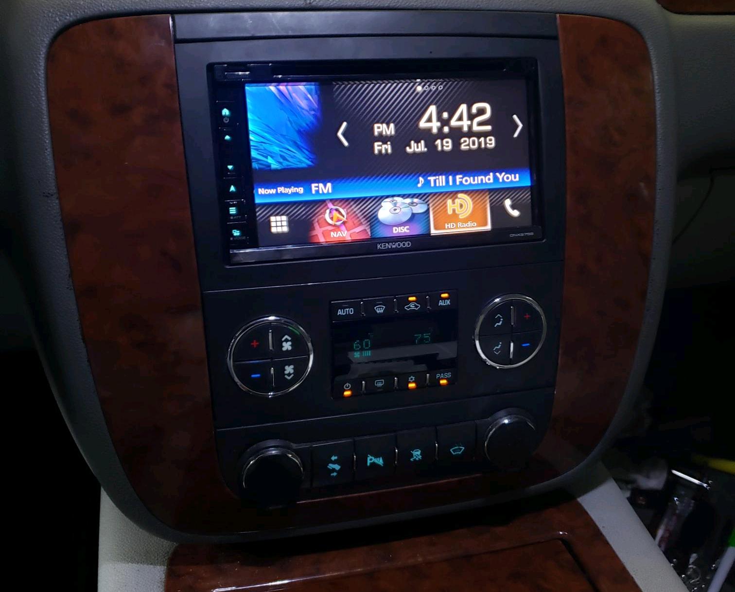

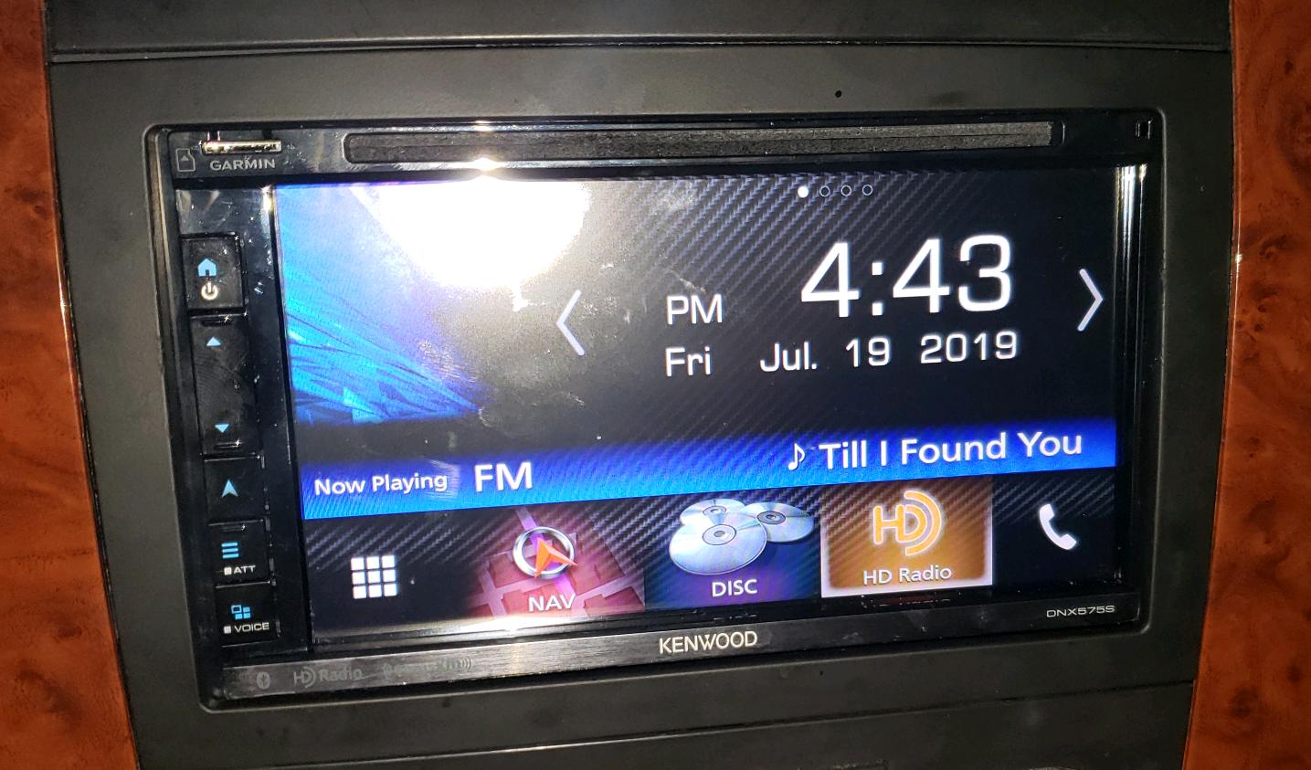

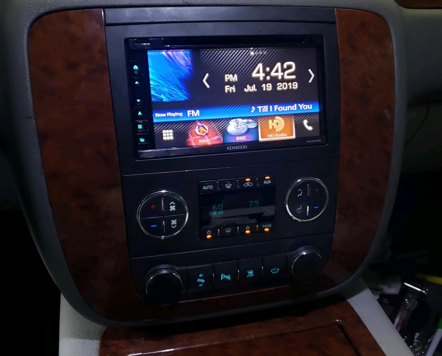

Well I got the Kenwood installed.
I guess the Metra dash kit "fits" the Kenwood and it was partially my misunderstanding the directions. The pics make it look like the stereo has to slide into the dash kit from the front, which it would not do. In reality the radio slides in from the back which leaves it sitting too far back in my opinion, which is why I said it didn't fit because it just looks wrong to me.
I searched a few different places and all the dash kits make the HU recessed which I did not like... so I ended up modifying mine as follows...

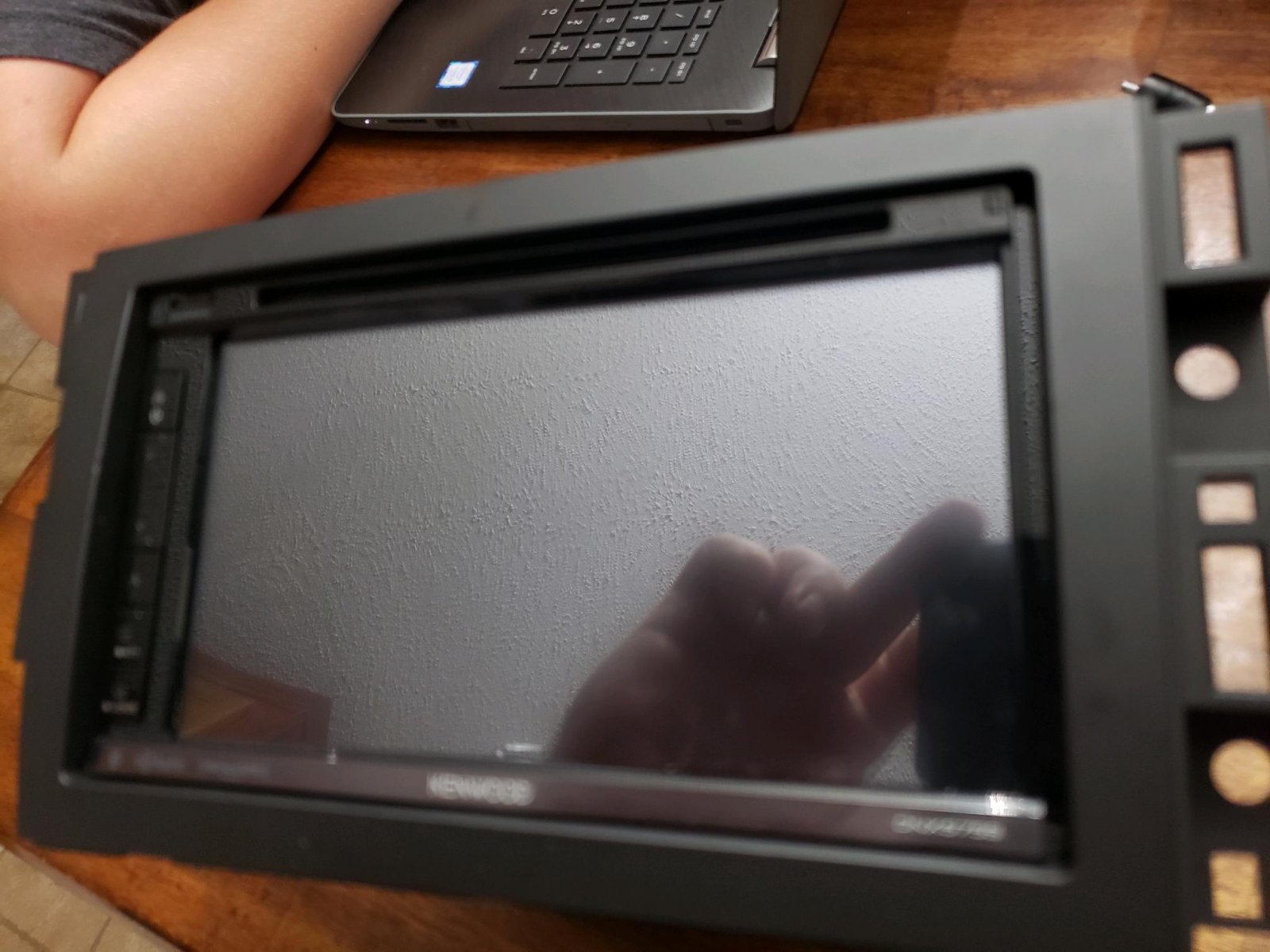

Before/unmodified...
You can see how it's set back... I did not like the way it looked.

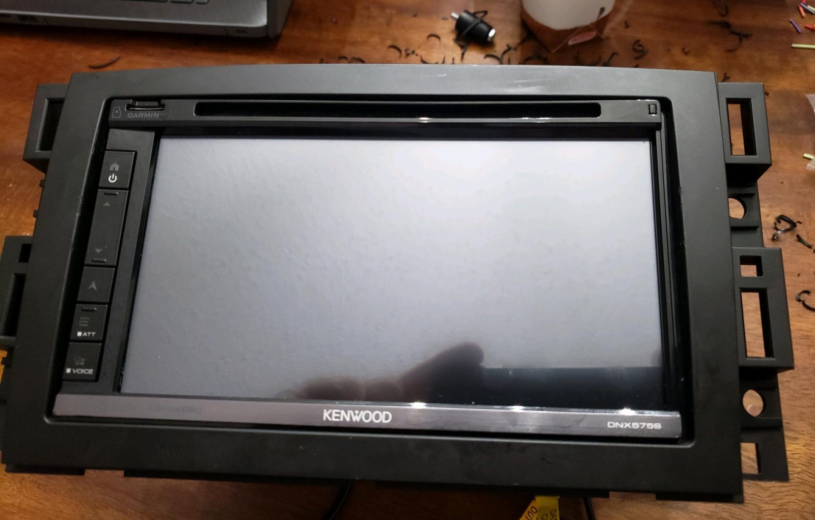

So I trimmed the back side of the dash kit to make the stereo sit flush with the dash kit.
After/modified...
This is the way it should have fit right out of the box in my opinion.
Anyway, it's all in and working beautifully. Now I just have to get used to the new interface and where all the stuff is in the different menus and what not... mainly the whatnot... lol
I guess the Metra dash kit "fits" the Kenwood and it was partially my misunderstanding the directions. The pics make it look like the stereo has to slide into the dash kit from the front, which it would not do. In reality the radio slides in from the back which leaves it sitting too far back in my opinion, which I why I said it didn't fit because it just looks wrong to me.
After/modified...
Much better.
