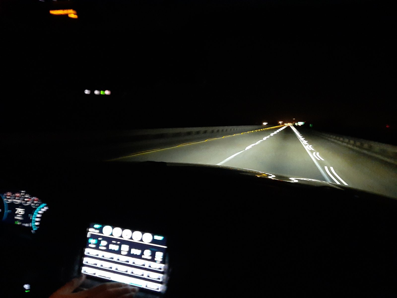

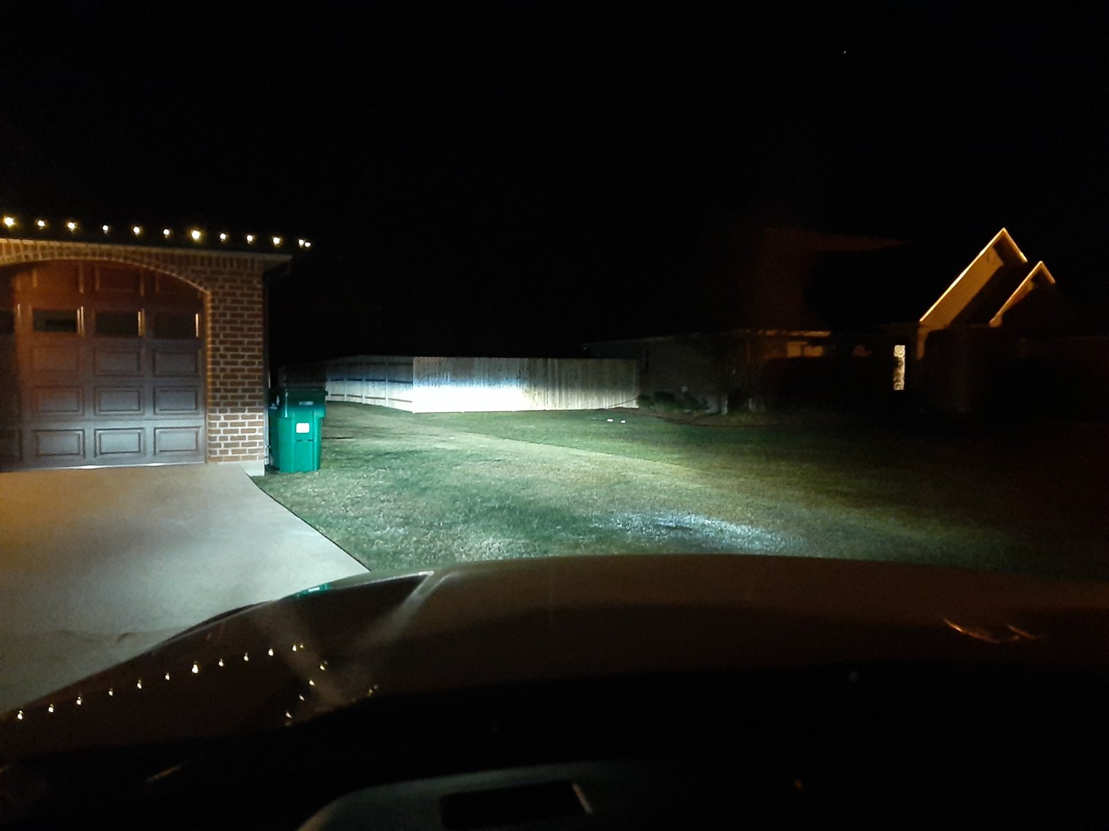

20201201_183346.jpg 20201225_052719.jpg this is a Morimoto 2 stroke 3.0, i have them in the low beam currently (as pictured)...doing fogs next, then highs.
well worth the 200$

View attachment 267089 View attachment 267090 this is a Morimoto 2 stroke 3.0, i have them in the low beam currently (as pictured)...doing fogs next, then highs.
well worth the 200$
+1 for the Morimoto 2 stroke 3.0's!
I have OSRAM CBI's in my low beams and the Morimoto 2 stroke 3.0 in my high beams. The Morimoto 2 stroke 3.0's are very bright in the high beam position and the high beam pattern didn't change it just became brighter. I also like how the Morimoto's are more of a 5000K color than 6000K (like most other LEDs), color is better on the eyes and more usefull.
