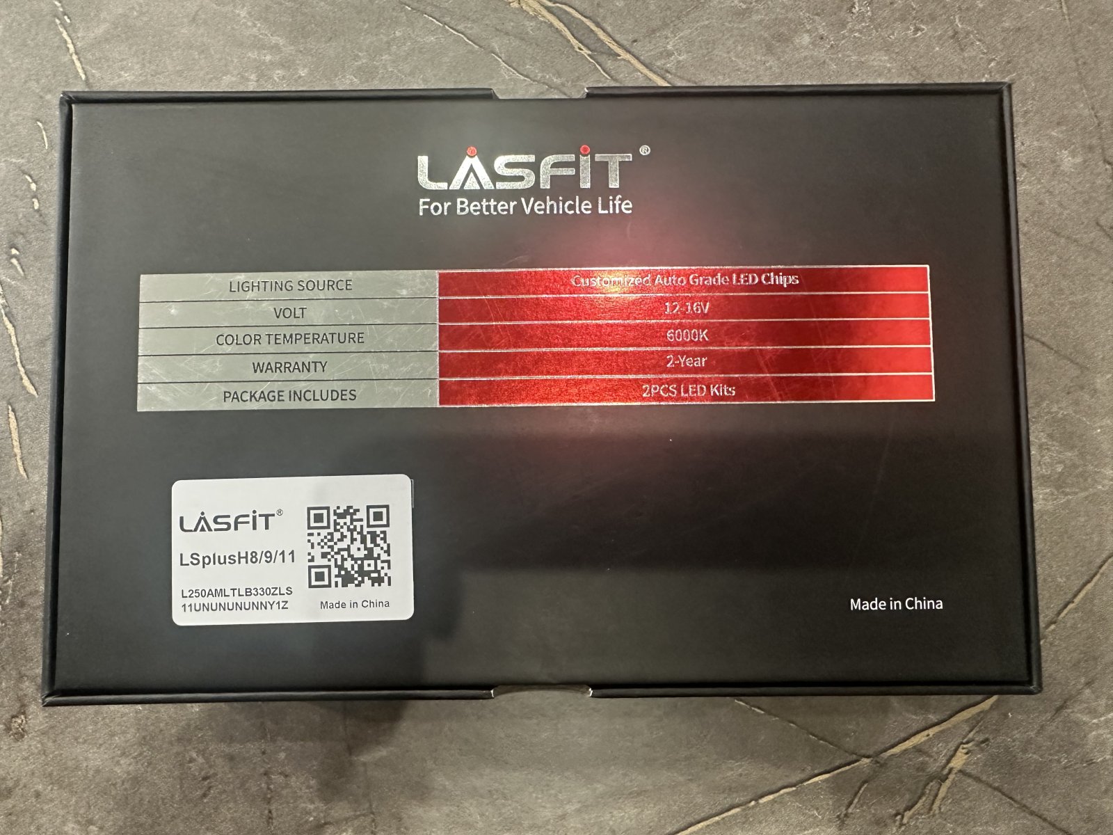

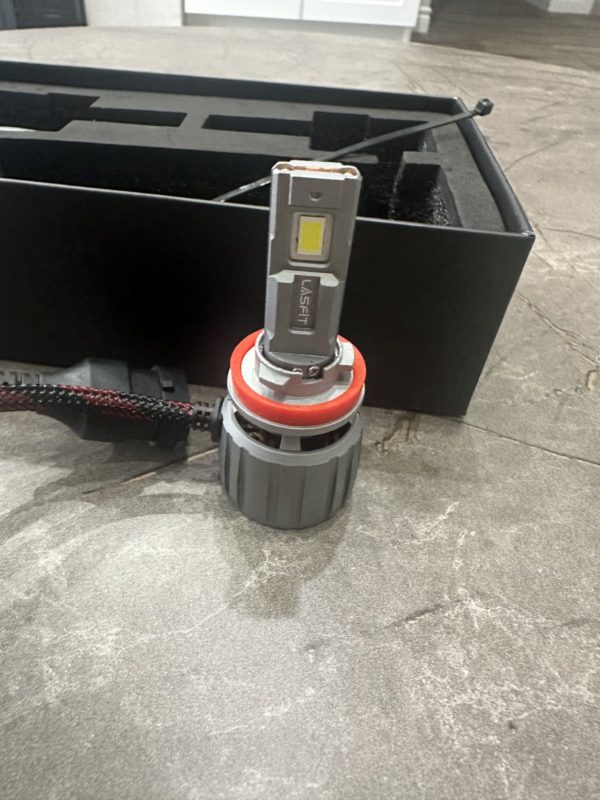

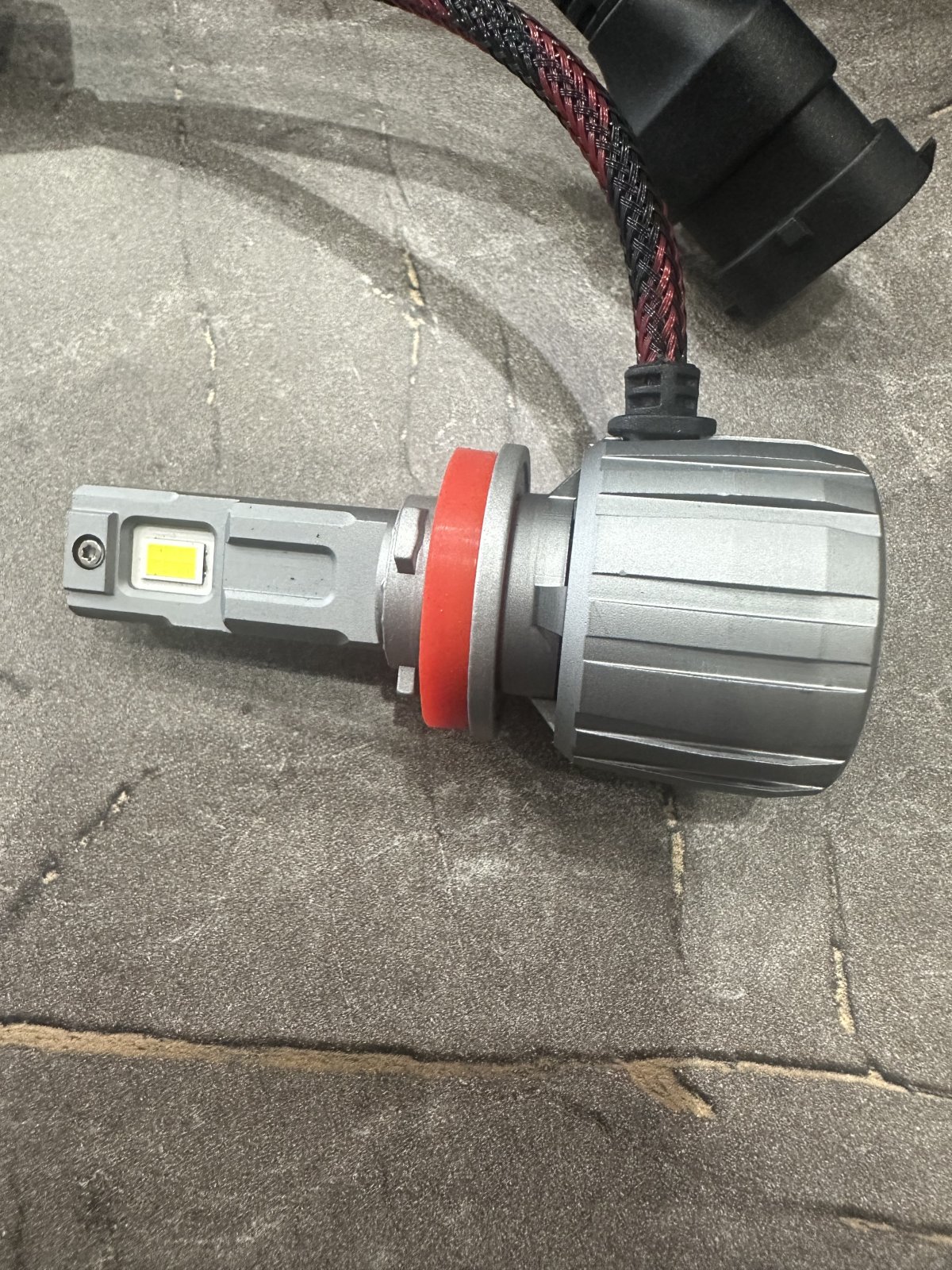

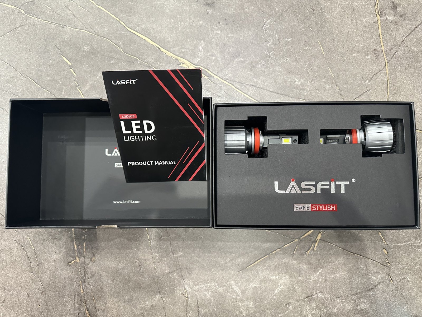

I Installed Lasfit LS Plus Series H11 LED’s to replace my stock halogen bulbs in my low beams on my 2018 Tahoe LT

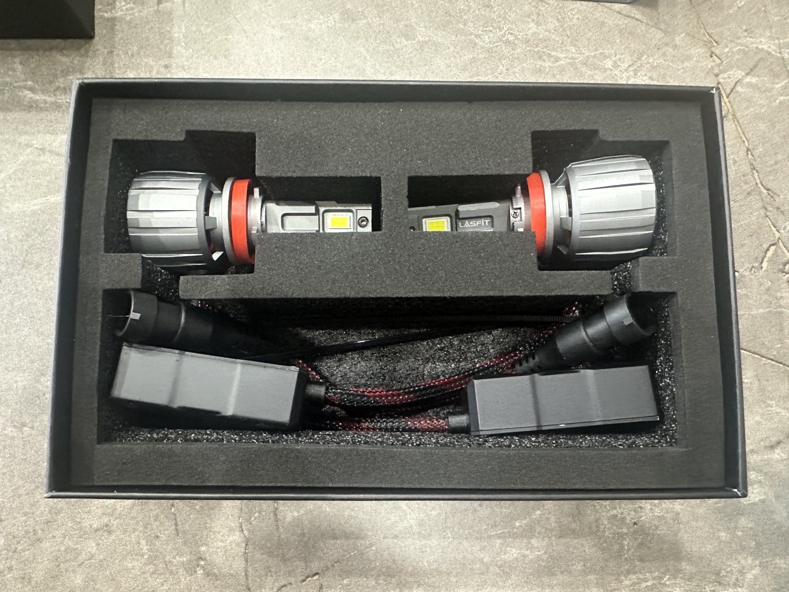

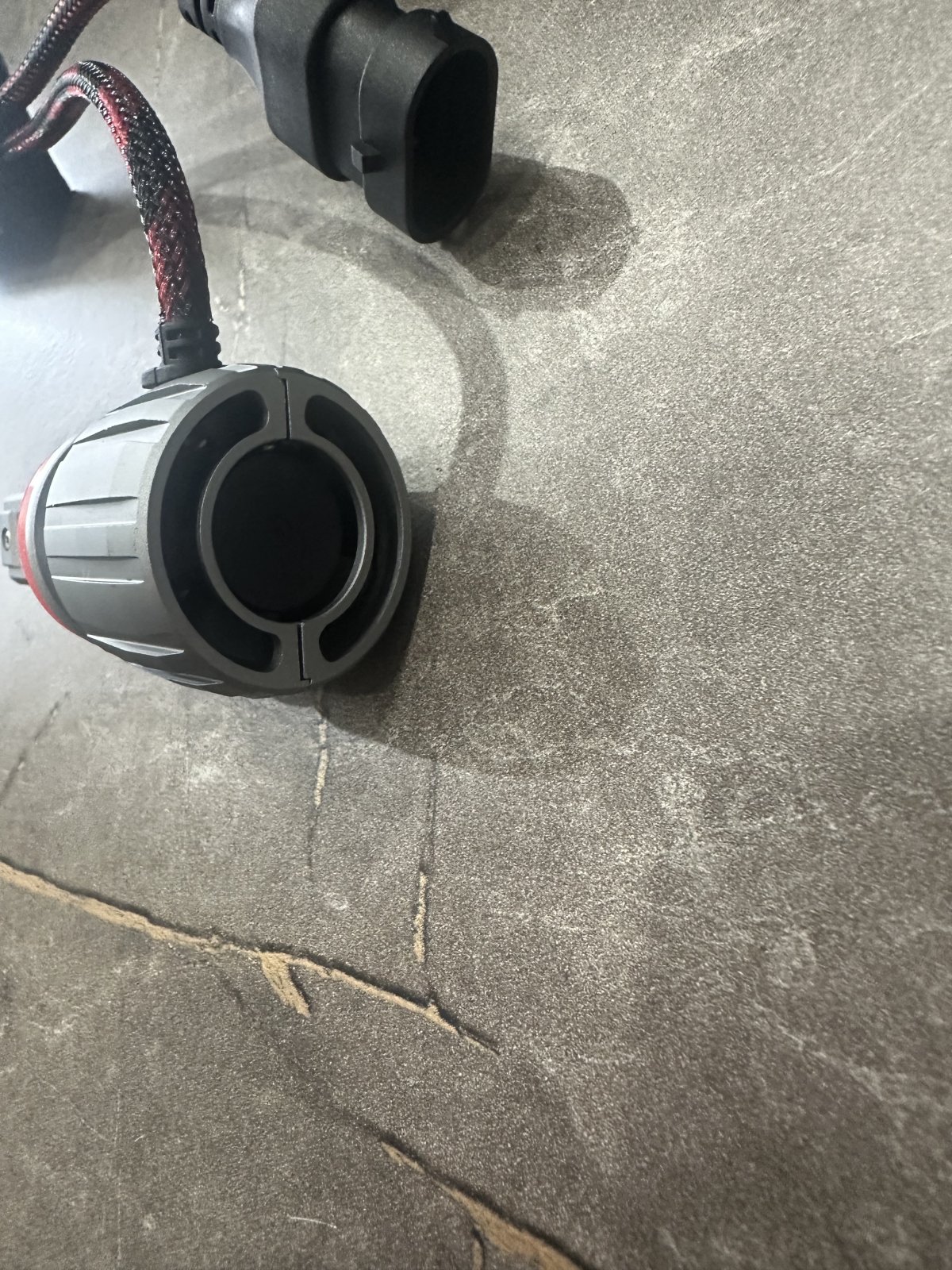

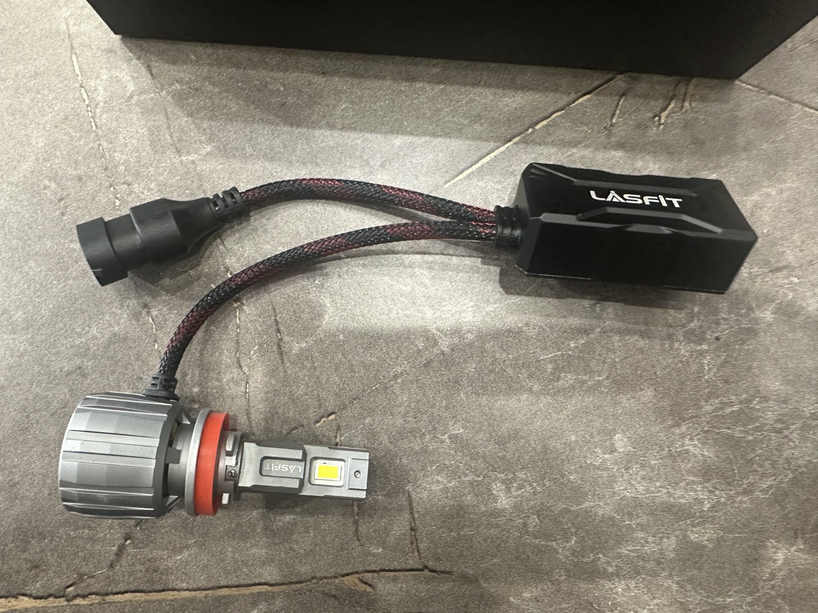

The build quality feels solid without any cheap feel to them.

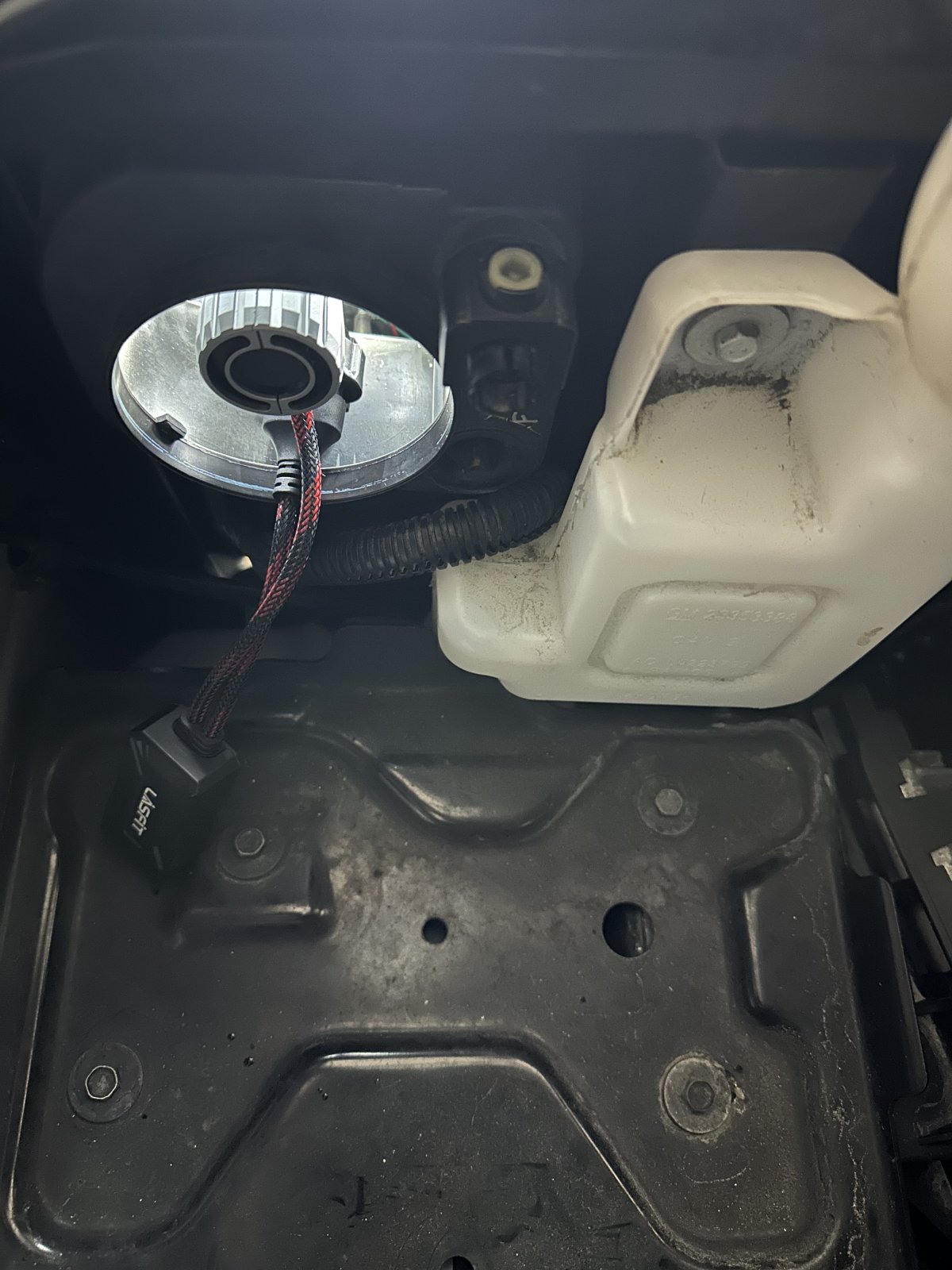

Installation was very easy, they are a true plug and play, non polarity sensitive. Make sure the led’s are facing the 3 and 9 o’clock with the wire cord facing down at the 6 o’clock position.
They cleared the stock dust covers with no problems unlike some other brands.
Also they did not throw any lights or codes on the dash and did not cause any hyper flash

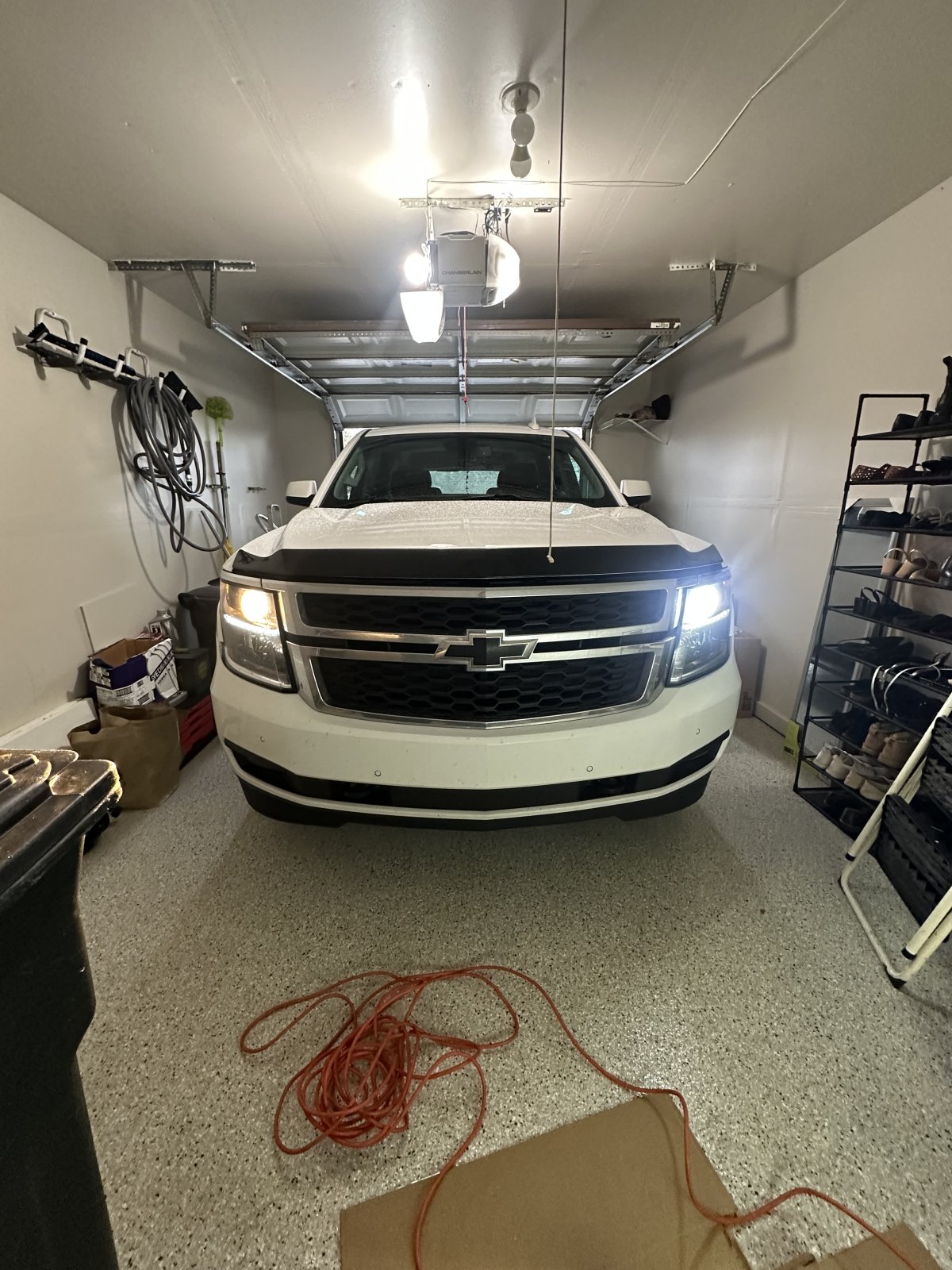

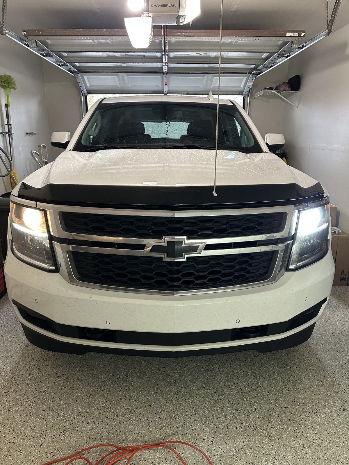

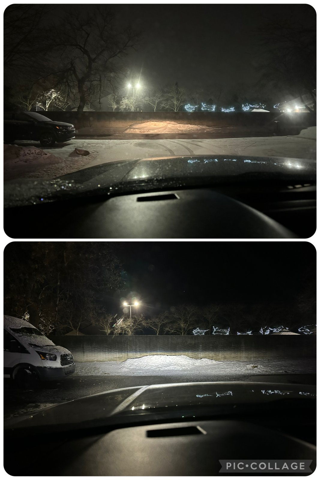

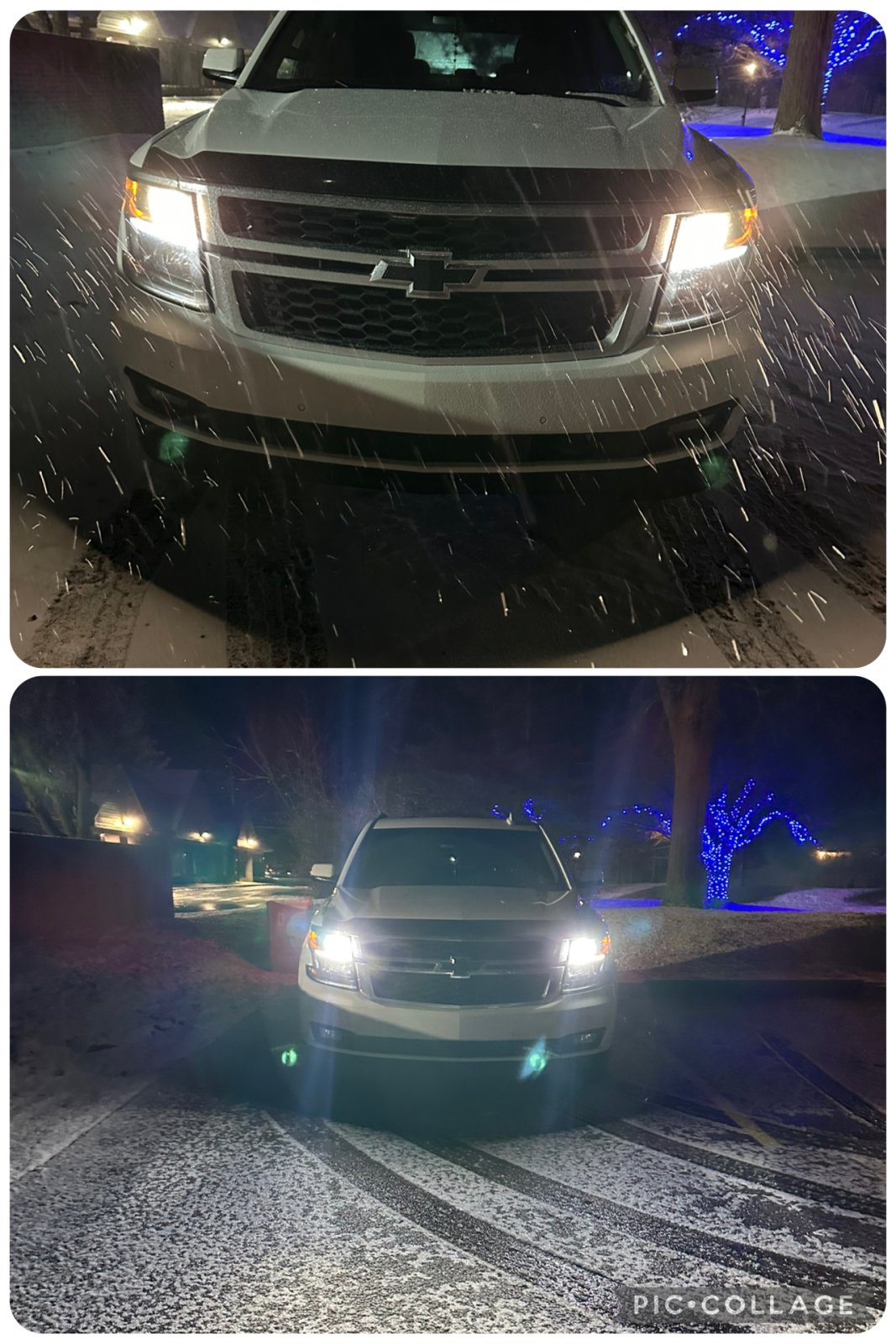

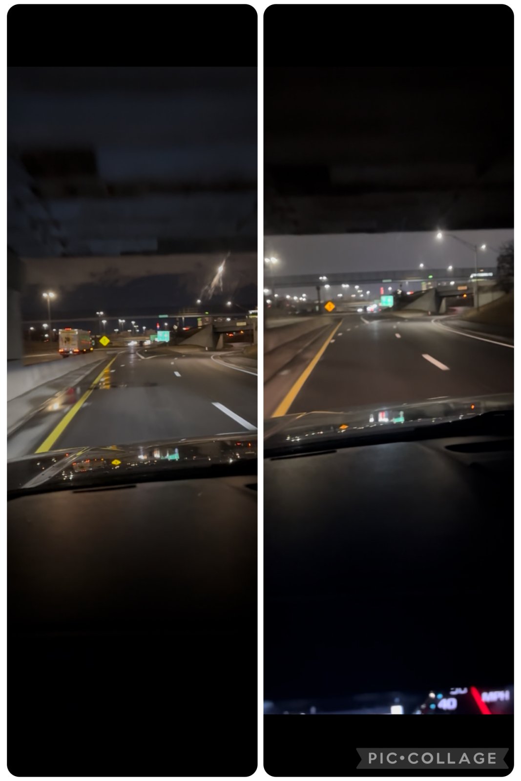

They give out a perfect beam pattern and cut off and have not noticed any negative reactions for other drivers so I think they are set up perfectly. They are 360 degree adjustable as well
The color matches up perfectly with the oem Day time running light strip. These look like they came from the factory
They make a world of difference in brightness at night and can see much better in rain/snow as well
They made my 8 year old truck look so much more updated. The pictures really don’t do them justice and sorry about the picture quality not being the best due to weather not permitting
I recommend these to anyone wanting to upgrade your halogens and to see better and be seen better

Great comparison pics!
Multiple threads on here with LED bulbs working very well with the K2XX low beam projectors.

I like the thickness of the gasket on the bulbs. Looks like a real good seal!
