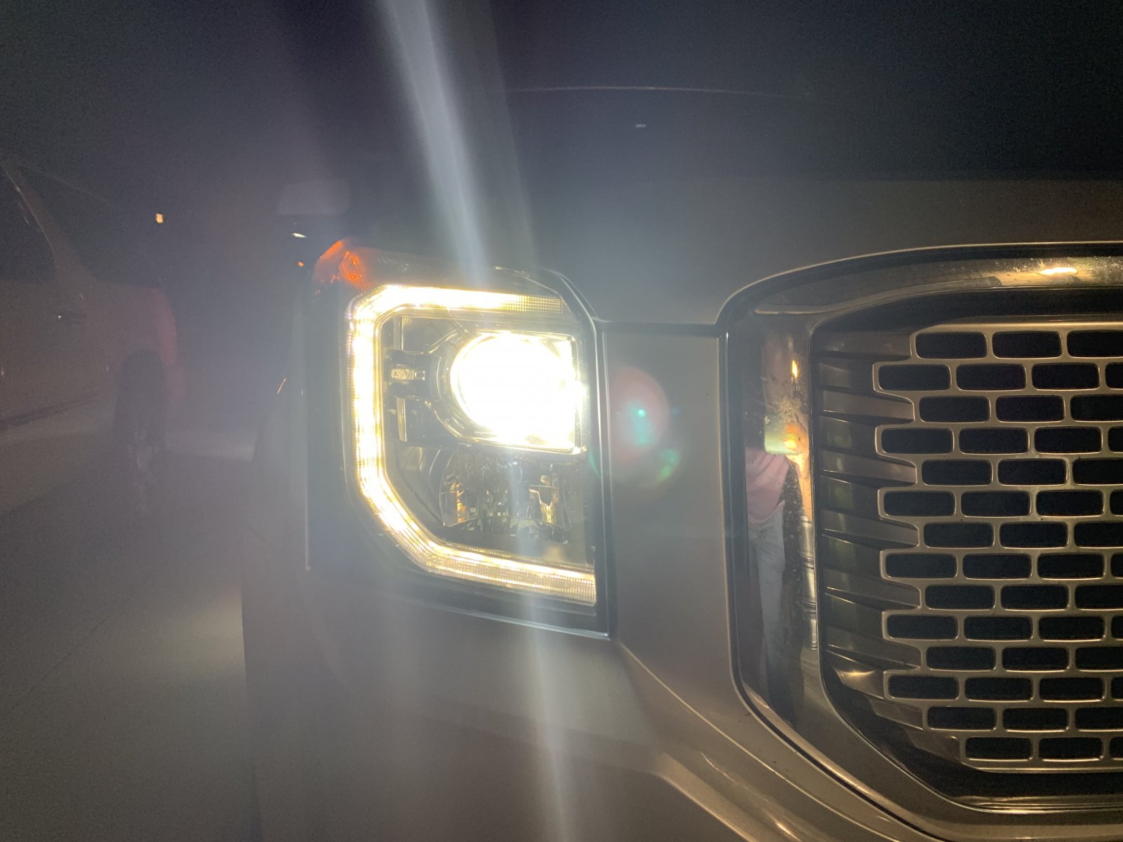

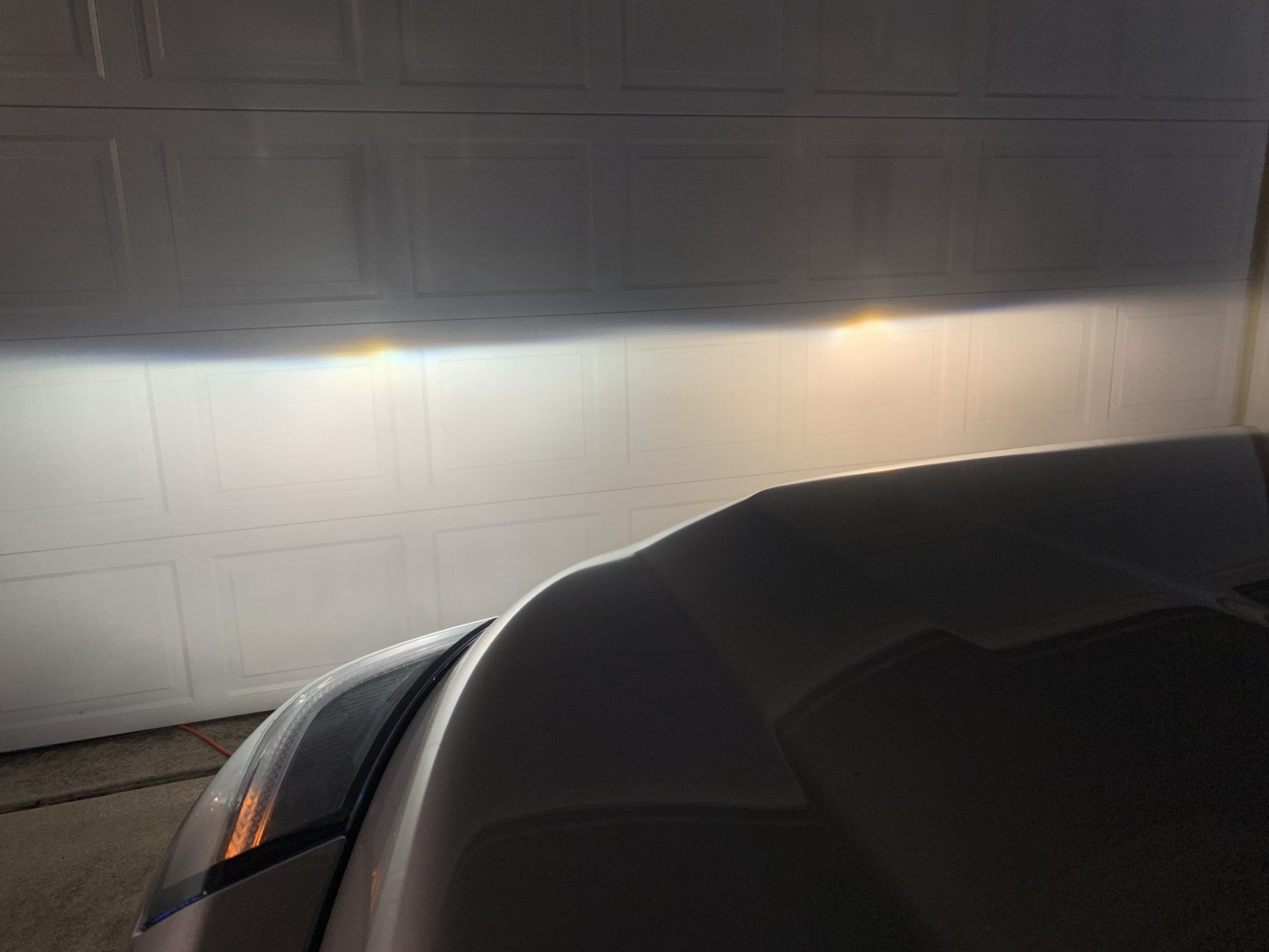

‘15 Yukon XL Denali. OEM stock HID on the right (passenger side) and OSRAM CBI D3S bulb on the left (drivers side).
The OSRAM CBI offers a color closer to 5000K more white without decreasing light output. In fact I think they are brighter.
This is plug and play as all you have to do is swap the OEM D3S low beam bulbs out for these. Again these are HID’s and since your Denali already has factory HID system all you need is a whiter bulb. I feel they are brighter and the color matches the LED DRL strip and my LED fogs nicely.
It’s hard to capture headlight photos and color comparisons from in front of the headlight. They never represent the true color in real life.
I would be cautious about purchasing OSRAM bulbs from Amazon. There have been some counterfeits sold through Amazon, which is represented in the significant price difference of Amazon and other legit retrofit headlight sites. I picked mine up from HID Concept because they had the best coupon code at the time, but also check The Retrofit Source or Lightwerkz. you should be able to find a Black Friday special at any of those sites and maybe get about 15-20% off.

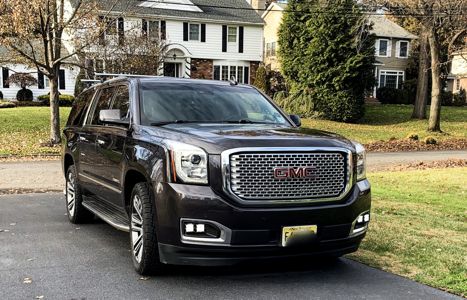

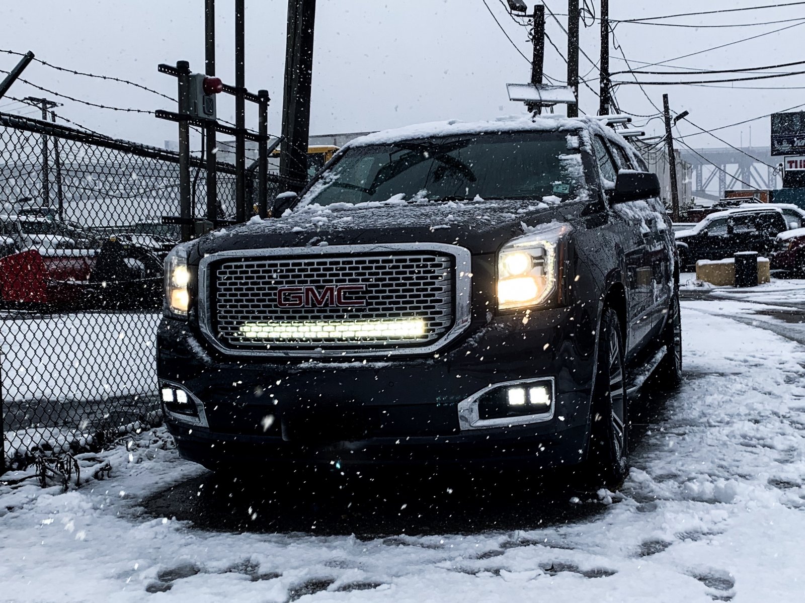

I did it, got the Rigid D2 installed in the fog housing. And 30” bar behind the grill to come on with the high beams. And also modified so the fogs and high beams can run at the same time.
View attachment 235386 View attachment 235385
Very cool. Been searching the forums for a how to on this and this is the first string i've found that someone has done it. What method did you use to enable all lights at once with your yukon? They don't make a fleece module for these late models, do they?
battledenali
battledenali
Oct 21, 2013
64
39
New Jersey
I guys that did my custom fab work managed to get them to all run at the same time. I believe he may have done it in programming but I could be wrong. If not its just how he wired them in. My LED bar turns on with my highbeams as well as the fogs. But the fogs can also be turned on with the factory fog button. They are some mad scientist over there. EuroTech in Mahwah NJ. Look them up they do awesome stuff.
