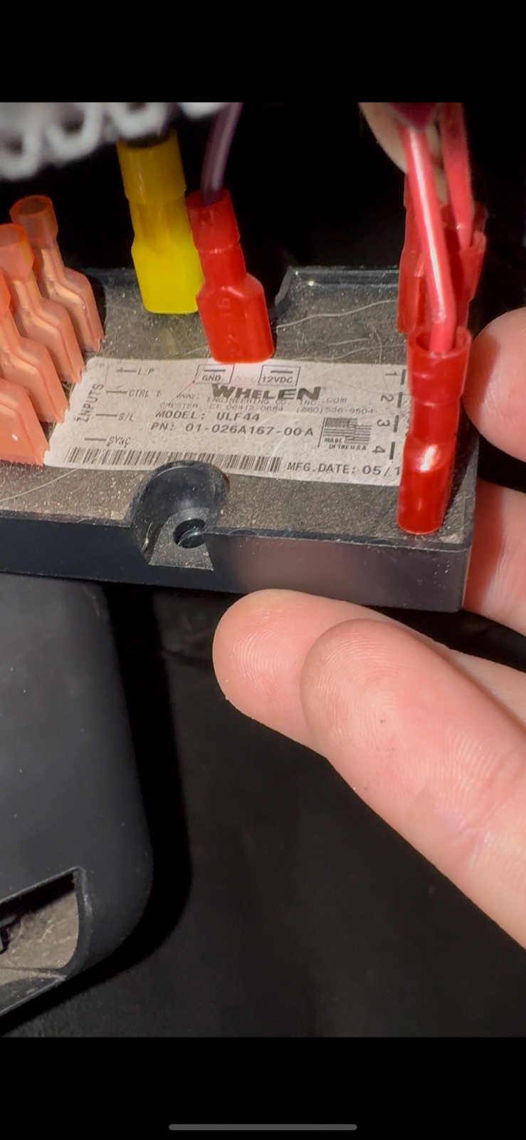

Thank you both for the suggestions! Yes there wiring that are cut that are coming from the bottom corner on the passenger side, thru the cover of the blower motor, runs behind the radio which i checked there and no connections there, and it ends up under my steering wheel. I have a 2008 GMC Yukon same engine and rwd as my 2010 tahoe that i am using also as referrence and i found this which my yukon DOESNT HAVE.
Could that be the culprit??

From looking up the part number, that is an LED flasher. You will have to trace the wiring and see if that is in the high beam circuit and interrupting it.
I would remove any extraneous components and wiring no matter what.
Cool thanks! Yeah i will trace those cables and see where they end up at. Also planning on taking all that wiring out too since it's useless and just a mess.
