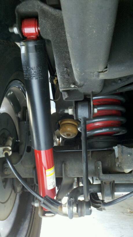

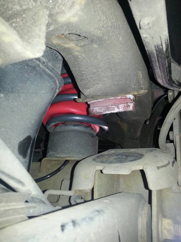

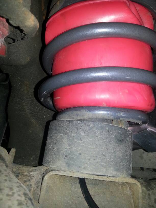

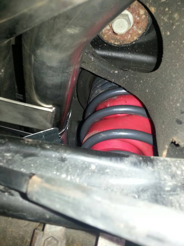

These are the pic. Before inflation. ..

Seems like the coils are to low for the airbag to fit in properly...or is it the they were installed wrong?

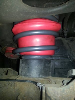

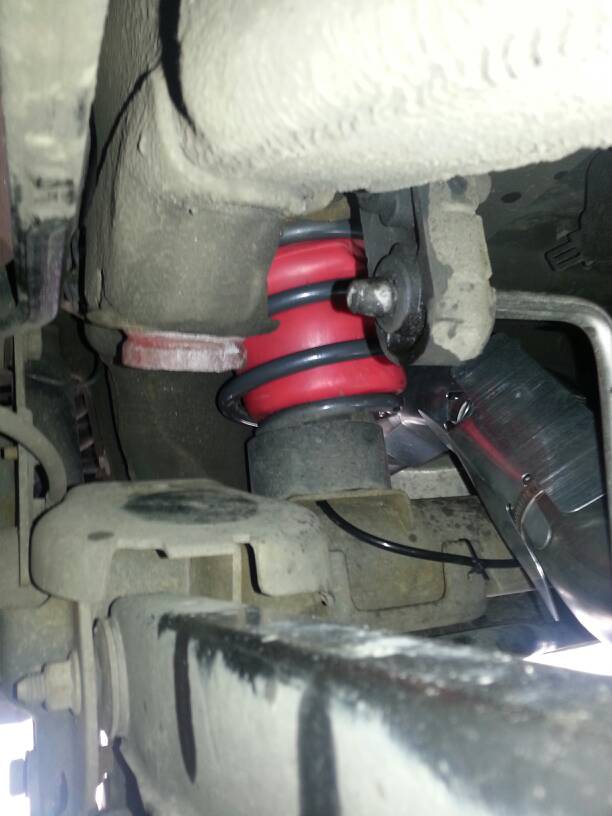

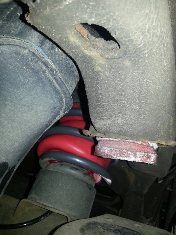

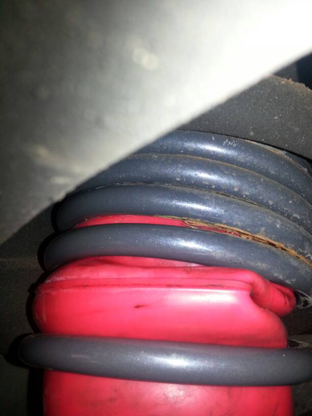

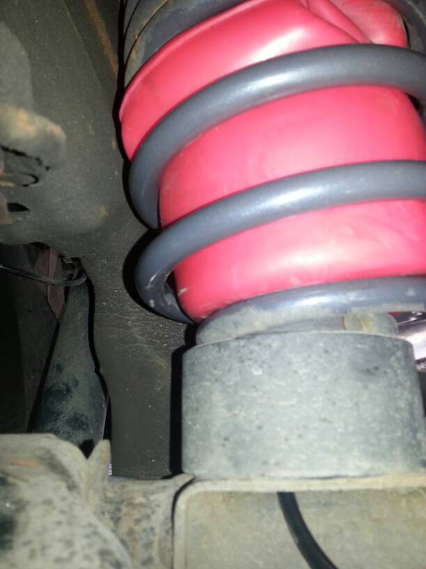

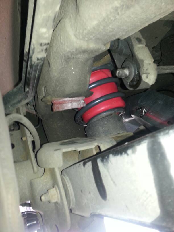

These are after inflation of 6.5 psi...

Does the coils look right?... this is the 5305 2"-3"/4" belltech set from tony....is this the way they arw suppose to sit?

So... is it the bag or the coils that are wrong...or both?... what can I do ti fix the bagm

totally wrong part number just saw which you ordered. PM me ill set you up with the right one.
