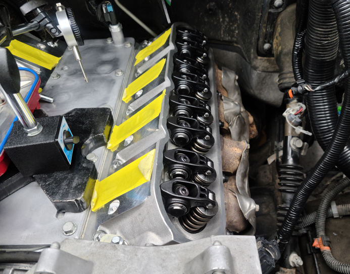

Rockers installed!
1.8 ratio.

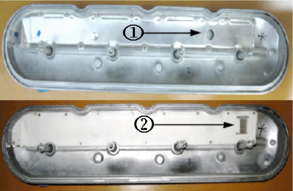

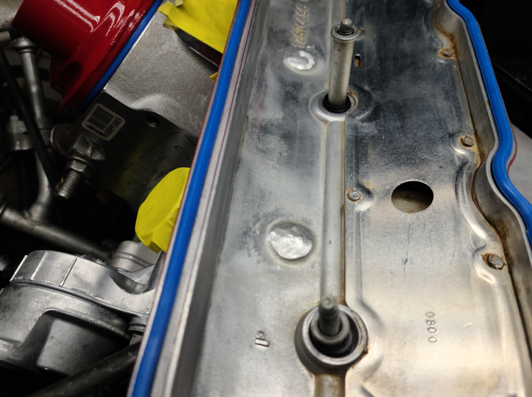

I decided the valve covers looked a little tight.
One of the Q&A answers for these on summit racing had an image of a modified valve cover.
So I decided wth.
The other valve cover i went slightly through the middle bolt.
so i cleaned it up real nicely, I'll just seal up the bolt with the same stuff i used to seal the intake rocker bolts...
:jester:

I also followed the instructions and cleaned the crap out of the rockers.
ultrasonic cleaner and lots of air cleaning until i was happy.
The trick flow pushrods i used were real bad.
nice coating, lots of metal picked up by the magnet i had at the bottom of the tank.
And i still had to brush out the inside of the pushrod until it shined.
:nolol:
Pushrods left my cleaner nice and brown.
I'm glad i did those last!

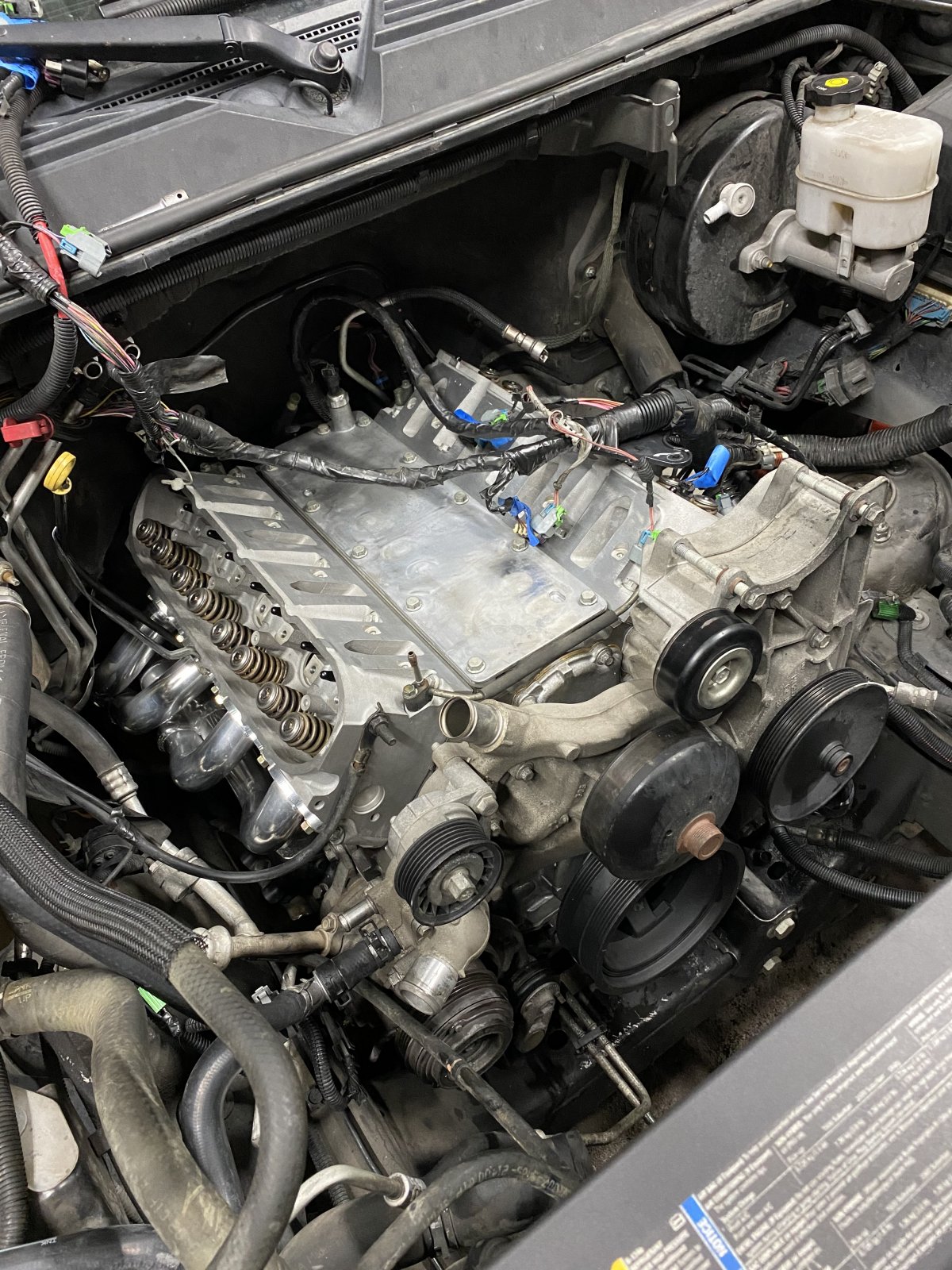

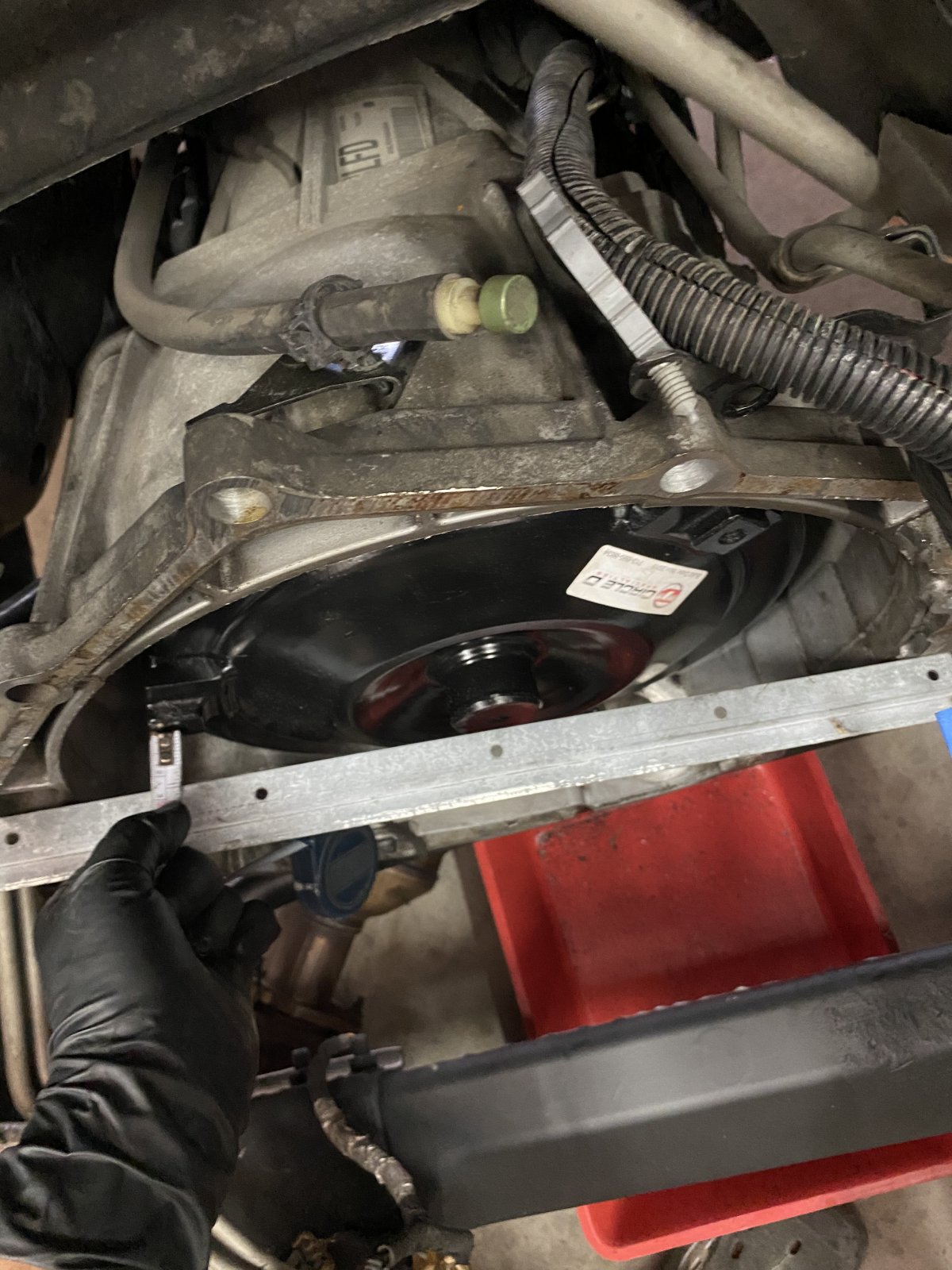

I nearly put the intake on last night, then i noticed a little metal bracket i missed on top of the transmission.
Holds the vent lines.
So now i get to try and remember how that attached on there...
:yaoface2:
funny shaped little thing, it's not making it easy!

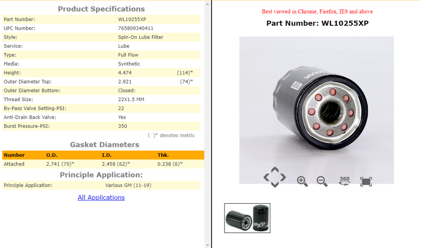

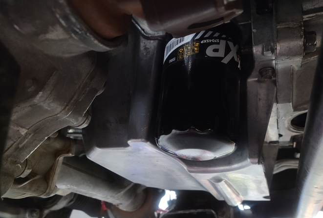

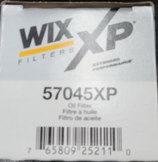

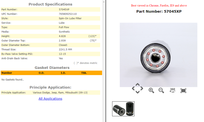

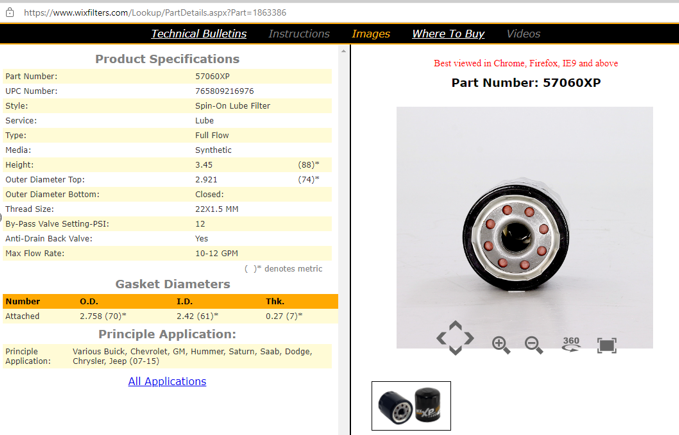

So i noticed a little while back that the filter for my wifes 2011 buick enclave v6 has a larger capacity filter that appears to be a match for the tahoe.
I did her oil for the first time the other weekend, and noticed that the prior owner put on a different filter.
Slightly larger capacity than the one that the car calls for.
So i went
:hmmm2:
I ordered a couple to check out.
Tossed one on the hoe for it's first run.
Pretty much flush with the bottom of the oil pan!
I'm thinking this is a winner!
PN:57045XP
Just Fishing
Just Fishing
Can't fix stupid
Aug 30, 2020
4,499
10,114
Utah
I take it all back,
This is the correct one for the enclave.
22psi bypass valve!

That bracket mounts with the vent hose toward the firewall, I think. I can't remember if the fuel line goes on the same stud or not. I remember it being a *****. Much easier from the top than it was from the bottom though:ehcapt:
45,012
:yaoface2:
This one?
Does this help?
You can see the vent sticking up here (green tip):

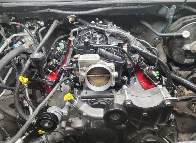

@iamdub
thanks for that.
last night i did some fiddling and i think i got it pretty close.
I had removed one of the rubber vent lines in order to get the nut off, and it sorta lost it's position. :crazy:
I got the intake on, and primed the oil system last night.
Nearly 40psi cranking w/o plugs or anything plugged in.
I also flashed what i think will be a good startup tune.
it has 6.2 fueling with the 6.0 2500 hd truck spark map.
Looking pretty good IMO.
I also noticed the intake rocker bolts left a tiny hanger of metal.
I suspected that would be the case, i wish i ran a rocker bolt through before installing the heads. :banghead:
But each intake, i was able to pull out a little piece of aluminum from the pass through bolt.
Here is hoping i didn't score something.

but then i ran into an issue.
Mid throttle/ish, is started to get a reduced power message and the hoe would start to run like ass.
Super rich.
rich is bad, especially during the break-in cycle.
it rinses my bore and rings from the expensive break-in helpers.
Code: p0606
That comes up as a generic ecm fault.
so either something went funky with my tune, I missed a ground, or i shorted something out.
When installing the engine, we did manage to lightly crush some of the wiring that routes above the intake.
I did some mild cleanup and taping, i didn't find anything broken.
Just some damaged insulators
wrapped those damaged wires with some super 88 and called it gtg.
( I'm making a note of that as i might need to do more checking of that wiring harness later)
I also got a pretty solid air bag warning message, I remembered the guy that helped me get the engine installed pointed out that he damaged a sensor.
That's the first place i'll start, maybe I have a short.

On a positive note, my pushrod length so far seems to be good.
One step below 7.4 seemed to be about right with the original heads, and that seems to have carried over with the afr heads.
