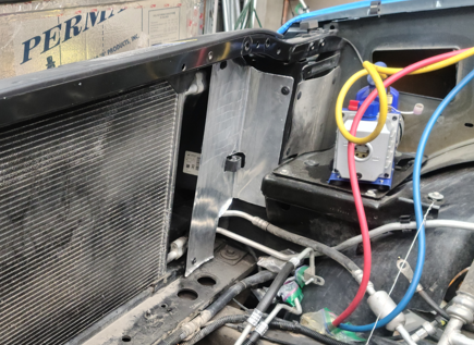

Aluminum radiator baffle thing, hopefully i don't hate it... lol
Not much left of the original, so i did my best to make a template from it. :gr_grin:
I found I had some push button center lock retainers that fit the holes perfectly.
So at least it will be easy to remove if it's annoying.
I used a screwdriver handle to make the little checker board looking lines.
stiffened it up by quite a bit.
I'm assuming it will make a terrible noise on the freeway, so i plan on using some rubber weather stripping on the ends.
:D

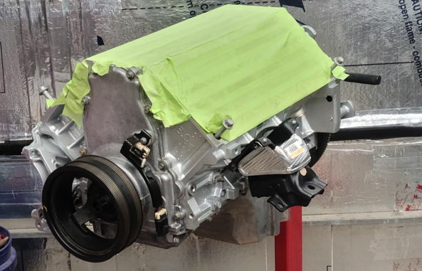

and i have the block buttoned up and ready to install for the most part.
Only pending part is the flex plate bolts.
the stand does not give me enough room to tighten the bolts down, so it looks like i need to break out the engine hoist.
Just Fishing
Just Fishing
Can't fix stupid
Aug 30, 2020
4,499
10,114
Utah
The machine shop also did me a solid.
the little yellow marks, he did that on the crank, flex plate, and the harmonic balancer.
lined them all up, and it looks like my little timing color marks line up with TDC.
Not that i'll ever use them, but it's nice knowing they are now somewhat close to a reference point.

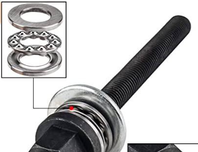

Also last time i did the harmonic balancer, i used the old crank bolt to install.
serious pita.
This time around, i copied the idea from my SBC balancer removal/install tool kit.
A bearing makes all of the difference.
https://www.amazon.com/gp/product/B07RTG6F97
So easy, so smooth!
Only complaint is that the little ball bearings were not captured.
(Or maybe they were captured but the little tin shield flexed out, who knows!)
I didn't notice that when putting the tool together, only when going to remove it from the crank.
Little steel balls falling and bouncing into all places!
I ended up pulling the balancer after realizing the machine shop marked it to line up with the same color mark on the crank and flywheel :D
Used grease on the installer tool bearings for the second time around (after finding all of the little ball bearings). :rolleyes:
totally worth the $20 imo.
Just grease those babies, and plan on storing in a ziplock bag.

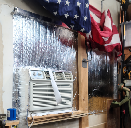

Spent some money yesterday and got some insulation to help the AC out.
used foam behind this and built it up to give me a nice flat surface.
Against the glass is a nice layer of tinfoil, then i went to town with the foam sheets until i had the thickness i wanted.
The board going right through the middle of the window is a left over of the framework i built to support a boat restore project, it joins to the top of the garage and a big beam.
it gave me some hard spots to mount rings, and some pulleys.
The final plan is to use it to help support some boards and metal that I'm going to install to add extra support and security to that window ac unit.
I also had an issue where the AC unit froze up on me once, i think i need to angle the unit in the back to aid with drainage.
so the piece of paper there was an easy way for me to see if it's still flowing air or not. :)

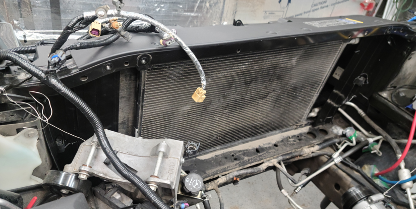

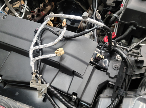

Did some cleanup of the wires and repaired/replaced some of the plastic corrugated shielding in some spots.
re-wrapped the harness where i saw a need with some fresh super 88
Silver parts, got the idea from the oem starter connector.
it has some nice heat shielding on it, seemed it's probably because the harness is under the exhaust manifold, I found i still have some nice heat shielding tape left over.
so i decided to shield the wires that route up under the exhaust manifold.
The stuff i used,
great stuff, sticks very well.
but they do have an optional spray sticky to help this stuff stick even better.
Mostly this tape is to be used to seal between larger sheets of heat shielding.
but i find it's great for smaller projects like shielding electrical.
If you want to go full bling bling, the gold version
I hear the gold stuff is better, but it's also twice the price.

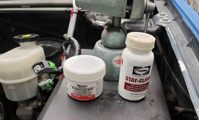

While i was in there, i decided to clean up a nice set of ground wires that bolt to the side of the block.
I tried flowing Rosin into the connector in order to clean up the wires, but i still couldn't get solder to stick.
so i went a little more aggressive.
used some AC grade stuff, "Harris Stay-Clean"
Just have to be careful to prevent it from running up the wire.
used some cleaner after flowing it into the connector with heat, then followed up with rosin.
I used this trick on my vette, but i had it flow right up the wire a few times.
the concern is that it would corrode the wire long term, but this stuff does clean up pretty easily.

And for the harness,
there was a bit of plastic corrugated shielding that had rotted out, right where a wire mounting spot is.
the connector, i might have been able to disassemble non destructively, but i decided fk it.
shielded that ***** up, and stiffened up the broken spot vs risking a one time use connector.

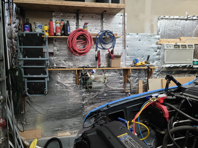

Started work on what I plan to do to the entire garage.
Main place i need it is against that wall, the back wall, and the ceiling.
I won't get too much further until i get the hoe out of there.
I like how much brighter the garage is already getting!

And i completed the radiator baffles
I decided to rock some gorilla tape to give it some thickness and prevent the sheet aluminum from damaging anything, flopping around, or making noise like a kazoo driving down the freeway.
:jester:
Doesn't show up well, but they are pretty black.
The other side is pretty seamless, i did my best to keep the ends of the tape on the inside of the engine bay.
thought is that they would be less likely to flake and come apart this way.
Incase anyone is looking, the little plastic holding clips appear to be 1/4in or 6.4mm per my little kit.
Kit: https://www.amazon.com/gp/product/B01IXXNP9S
I didn't get a good picture of it, but prior to blacking it they really stood out in the grille view.
I wasn't sure if i liked the look or not.
but now it blends right in.

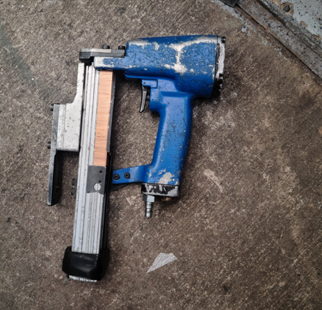

Also on the insultation on the wall...
so i have an addiction to random tools.
one day i walk into a pawn shop and start going through their air tools, one tool got my attention
A massive stapler!!
It has a little adjustable plate so it can crimp the ends off like an office stapler.
i was hoping it was one of those staplers that shippers use to staple boxes shut.
What i found was close, but not quite.
It's the stapler that shippers use to assemble shipping pallets, mostly to fasten a thick cardboard side to a wooden pallet.
it can also crimp the ends off, but it does have a limited range since you need to get the plate on the backside.
Playing around with it, I found i can staple two 3/4 boards together if i have long enough staples.
Turns out it's obsolete since the staple size is no longer used.
On eBay i bought a couple cases of obsolete staples for less than the copper is worth as scrap.
Paid something along the lines of $40 for it iirc.
These are the shorter staples i have, but i do have the long ones.
I used this stapler to attach the insultation to the wall.
If i manage to hit a stud, it will go into the wood.
I have also used this stapler to fix a rotted fence.
used the full crimper action to full on staple planks together... :jester:
I'm doing my best to avoid wires with this thing.
i had to go around a power outlet, so i totally did it with a single hand, and avoided the stud. :waytogo:

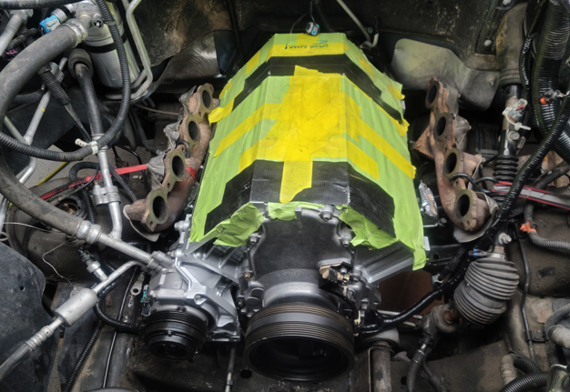

And we dropped the engine in last night!
serious pita since i decided to install the chain down at the lowest head bolt point.
the little L shaped bracket really got in the way of the exhaust manifolds.
My helper was really good at just helping me remove the hood.
so he was my go-to guy.
Worth the wait for that guy.
While he was in the engine bay, he was kind enough to get the engine mount bolts started, along with the upper engine to trans bolts.
Afterwards we went out to dinner and i bought that guy a few rounds.
:happy160:
All bolts are just finger tight, or at a minimum started by a few threads.
This weekend I'll start tightening things down.

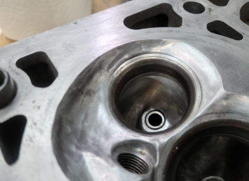

So here i was, it was after midnight.
working on these heads all night.
Removing metal, cc'ing the heads.
Then it seemed like i was loosing fluid when cc'ing the heads.
I see this around the valves.
This looked much worse until i cleaned it better, but i swore it looked like i went through the heads!
I nearly ordered those $2500 heads right then and there, but slowed my ass down and took a pick.
then i remembered that this was the head that I hadn't fully finished, a little hump of aluminum still exists.
And this head doesn't have nearly as clear of a gasket line as the other head has.
making it harder to get a perfect line as I open up the chamber.
I suppose i need to grab one of my new head gaskets to scribe a nice little line.
my impossible to replace head gaskets...
:yaoface2:

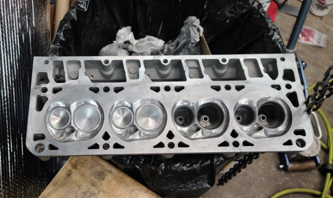

Well I'm accepting that i planed this build out poorly, and I should do it the proper way, by yanking the engine apart to swap out the correct pistons (and loosing $400 for the pistons that have been modified by the machine shop), and loosing the money spent on the balance to have it done again.
or by running a silly sloppy quench/thick head gasket...
:okay2:
My head modification turned out OK.
I ended up with a tiny bit of overhang of my selected 4.1" head gasket into the chamber.
Granted, the gasket would still be on the block, and not in the actual combustion chamber.
I could get a slightly larger dia head gasket to make me feel better, but there is not much available right now...
:yuno:
But overall I'm not happy with this much material removed without some sort of actual reference from another set of 799 heads that have been modified to this chamber size.

My heads where they ended up,
