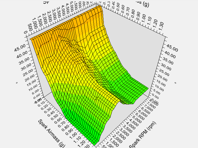

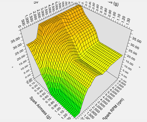

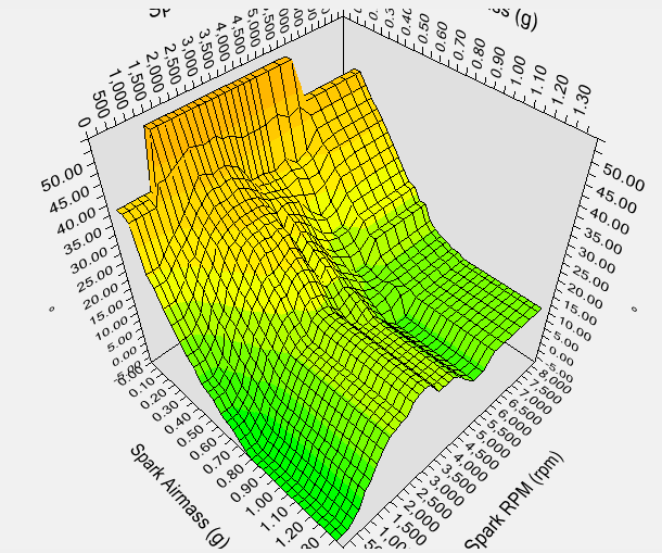

So just for general reference.
6.0 trailblazer SS High Octane timing.
6.0 2500 HD timing.
6.2 escalade timing
This is just a general overview, other tables add and remove from the table.
So i loaded up the HD timing first.
Runs a little better, More top end!
No real pinging notices in the log, maybe 1 degree.
I like it better than the SS timing, engine seems smoother.
So then i decide, wth lets load up the 6.2 timing
Oh baby!!!
Me likey! :boobs:
More power everywhere.
the hoe is happy.
logging, i'm seeing just a few degrees of timing retard due to knock sensor input.
Not a huge amount, but enough that i put it back to the 2500HD timing for now.

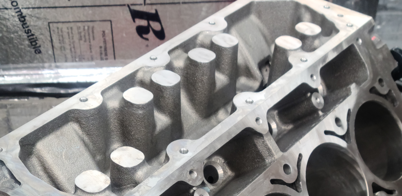

Then i remembered something, the 1.8 rockers.
I did some reliving of the valve cover to prevent this issue.
It's possible that in this area of rpm, i have enough oil pressure that the rockers are moving up more and hitting the valve cover.

If they are even slightly coming up and hitting the valve cover, then there is my issue.
So my task later today, pull the valve cover on the driver side.
if I see signs of contact, more reliving.
and I'll probably do the same to the passenger side if it's found.
from there, I'll probably bite the bullet and order some spacers and the updated valve cover.

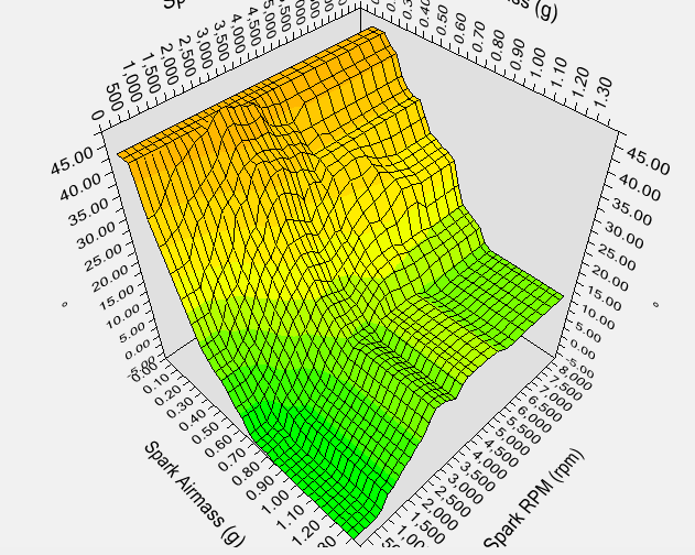

Well, i did some timing adjustments in the tune.
Reduced the overall timing in the 10 degree and over cells by a few points in the high octane.
Really reduced timing in the low rpm high load table.
(500-1000 rpm)
And the high load timing jump, i made that a little shorter, reducing timing for high load overall.
Then went through the low octane timing and matched thst up, and using another timing table to match up the expected timing reduction.
Then knocked a good 5-10 degrees from that.
Seems to run fine, but my low rpm torque sure suffered!
Doing a little logging with the tech2, im no longer seeing that 2 degree of timing retard.
And the misfire map looks clean.
For now it's good enough to drive around town should i need to.
