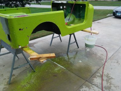

Did a lot of wet sanding today, lot of prep lot of elbow grease, upon elbow grease, upon elbow grease! The guy that put the wrinkle coating, rubberized, s*** job on this tub, I could kill him right about now! But, in between sports biking training, life, kids, wife my own stuff and work. We're able to get after it again. You'll see a lot, this month as far as body work. Lots of 80 grit, lots of 120 grit, lots of 200 grit, water, soap repeat!

20190922_123124.jpg 20190922_123148.jpg 20190922_123148.jpg 20190922_123124.jpg Did more sanding and got most of the wrinkle coating off. Now I will use Red oxide primer on top and sand down to find low spots. Then gray primer to finish off low spots. I will be on this tub for alt least 3 weeks.

Keep on picking at her man :) She's going to be beautiful once she's done.
