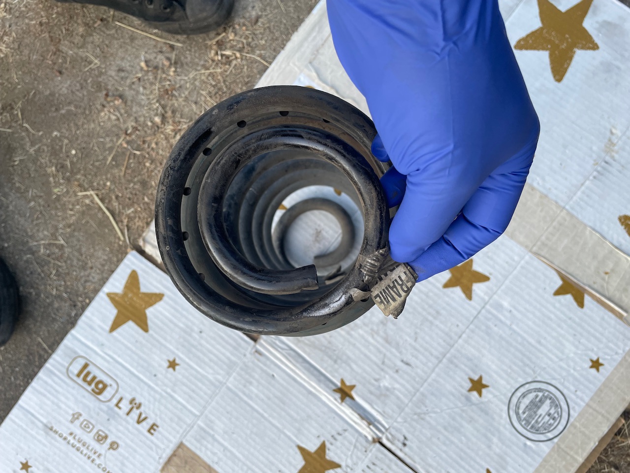

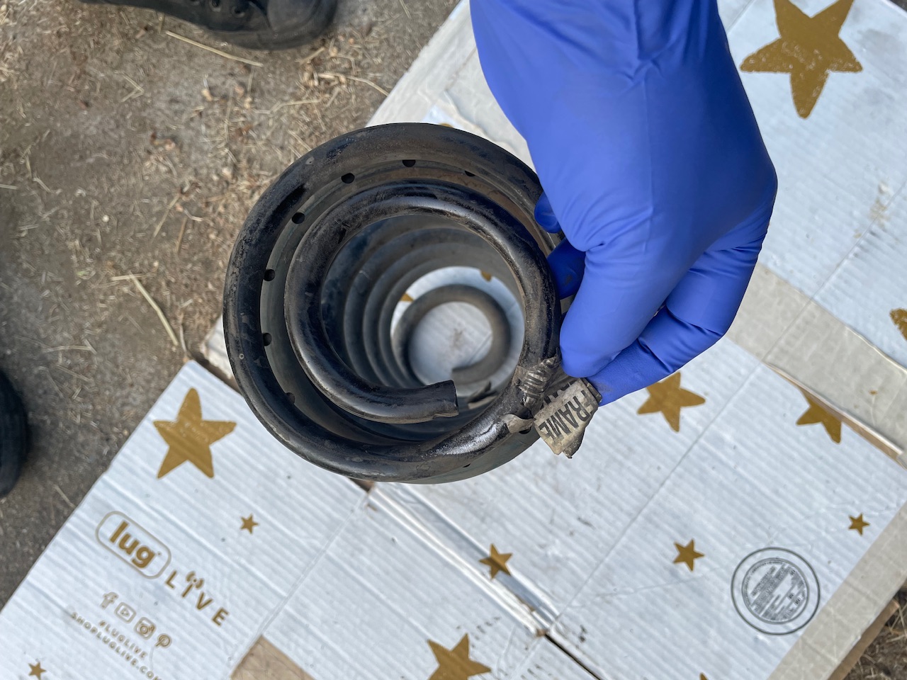

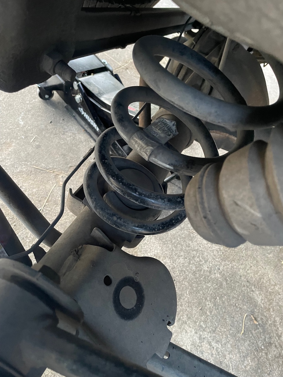

Sticker on top of spring says 'FRAME'. Frame rails are outside of spring perch. Or are they implying 'chassis' like facing inwards? Another part number sticker lower down roughly same clocking. Oh well I have them facing out, where they would be easy to inspect the sticker, and facing the frame rails for these photos.

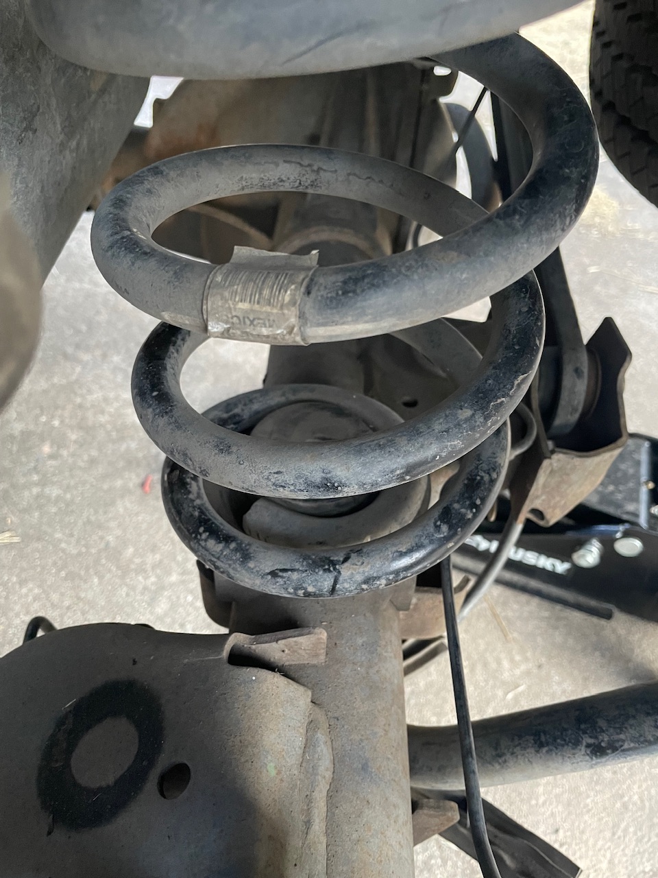

driver side spring, worn because it was upside down im sure. oops.
Photo should be correct direction. (?)

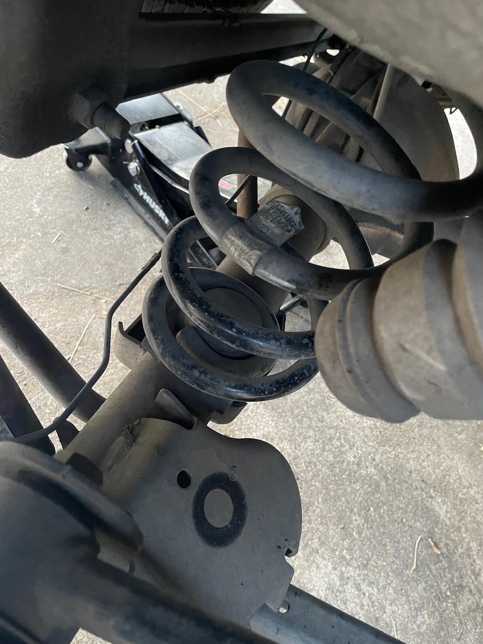

Passenger side
Hmmmm... My first thouhgt when I read that was: FRAME= top, considering the bottom is on axle...
But after seeing your pics I would say your 2 points with "the most" force (if there is such a thing) are out on each end at the widest point possible... That's one of the benefits of coilovers, wider= more controlled
I like that better than mine in the rear... Mine are assisting with axle wrap for gosh sakes lol...
Passenger side
I'll find out in the morning what Perry, the spring engineer, thinks...
Yes frame means top. Pig tail orientation don't mean squat IMHO. Not unless the spring perch is molded with a "seat" for it.

Funny, I hadn't even thought about 'FRAME' meaning 'UP'!! (Why didn't they just say 'UP'??)
That is the most logical answer.. Guess that is the 'orientation'.
And, I would say who doesn't know which side is up?
Yet I had one upside down..
(I remember the spring falling out a couple times when I was installing..)
So I think it flipped on me and I didn't notice, and I didn't inspect afterwards..
because it looks wrong when they are upside down and the truck is sitting on them.
Regarding 5stars post about the spring feeling different, I guess it levels out with the truck sitting on it.
Top of spring has closer windings, so it's probably that end that feels uneven on the ground until the pigtail squishes down.

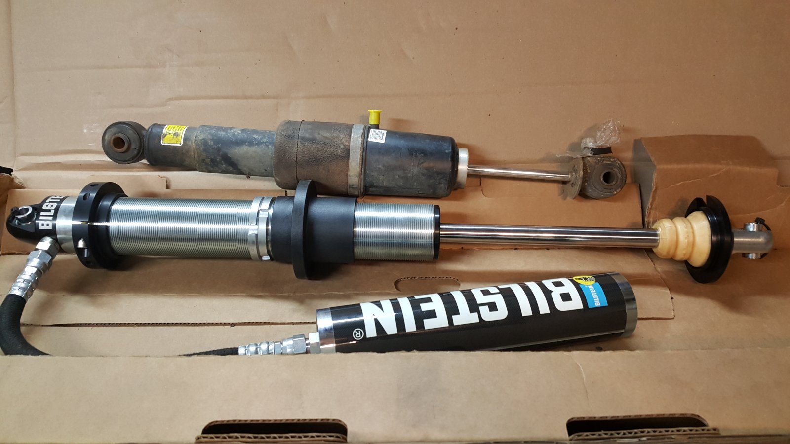

Back in Feb I spent a few days learing how Z55 works. The goal was to determine what size resistors I needed to make the BCM think the ride height sensors and OE shocks were still there and behaving as they should. Very soon (next couple weeks), I'll find out if I got it right or not?
Currently in the process of building a rear 4-link, and installing a different electronic shock control system :D.... IMHO, GM could've made a fortune selling a retro-fit kit like this...
One of the first things I asked SDI about was if they'd ever attempted to get GM's permisssion to tap into the Z55/Z95 sensor feedback system, because essentially, this is a Z55/Z95 system that you can fine tune and/or take full control of, on road or off... GM said no thanks. Ford, Honda, and Toyota however were in...
I bought this:
It was a little of an impulse buy for me (three days research) considering I needed 4 weeks to decide between custom coil springs and coilovers lol. But again the math and the tunability were the determining factors... To retro-fit the Fox Fact Race Series w/remote res front coilovers I have with Dual Speed Compression adjusters was gonna cost $848.. To buy the Bilsteins with the adjusters woud've been $1084 more than I paid for the two I bought without them... That $1932 is only $297 less than I paid for the E-Clik Universal System...
Cross fingers for me that I get this 4-link right and that my welds come out clean!
