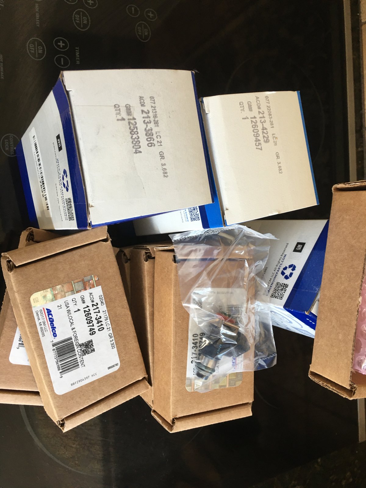

Just curious, what made you want to change the injectors out?

Sorry not trying to take over the thread ...
Running on
e85 it gets P0420 & P0430 DTC
91 it gets P1175 DTC
loppy, intermittent idle and just approaching 170k clicks on an L9H. With that milage and engine run time it can be considered routine maintenance. It's not worth paying for diagnostic time. My Tech2 was poached. This is preventative maintenance against a rich or lean mixture, protecting the cats and improved milage.
Even if, by some slim chance this doesn't clear the DTC, it rules out the injector and o2 issues. That leaves a bad coil(s) or a faulty cat(s). If I have a bad cat, I'd be replacing the injectors and/or o2 sensors anyway. This way, in this particular sitch, I'm simply replacing parts known to outlive their lifespan before they fail. Although they may still function, you don't want an injector to die and kill a motor that's known to run trouble free for 300K or more miles.
This 09 was purchased at 130K three years ago. With no AFM from the factory, running e85 98% of the time, it runs cooler, has no knock/detonation using 100 octane and practically zero sludge in the cylinders as the corn fuel cleans it all out.
