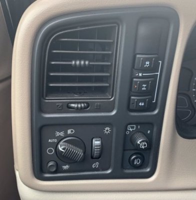

Is it possible that this Tahoe has 4WD/AWD? (pic of dash)

My 2004 Tahoe LT has an Autotrac transfer case that is always in AWD. You can select high range, low range, or neutral. There is no 2WD option.

My 2004 Tahoe is in AZ. I have attached two pictures of the dash switch that I found on two 2004 Tahoes in Autotrader. This transfer case appears to be part of the "Safe and Secure Package" for 2004.
View attachment 253314 View attachment 253315
Auto 4wd. Ie: it puts the vehicle onto 4wd automatically for you.
That’s different than AWD/all wheel drive.
He's right. There were some GMT800 Tahoe's that were AWD, but had a 4 Lo selection. These are rare, but this t case isn't as popular, I've researched into this before. It's a rare t case
