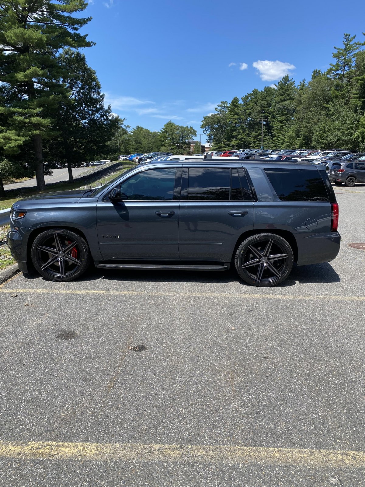

Hi All - I've got a 2020 Chevy Tahoe with the MagneRide option. I had the 2"/4" drop kit from MaxTrac installed which I love but the rake forward in the truck's stance is something that I really want to fix as much as possible. The clearance between the top of the tire and the wheel well is about 1.75" inches lower in the front than the back. Picture is attached for reference.
MaxTrack makes a spacer kit for the front coils (linked below) but specifically says that it's not to be used with wheels wider than 9" or wheels with less than 4.5" of backspacing. I'm running a set of 24x10" Vossen HF6-2s that violate both those requirements.
Anybody have suggestions on how I can level out the front of the truck? Really appreciate everybody's thoughts and input on this. Thanks so much - Matt

If the drop kit diddnt flip the front struts to the bottom of the control arms you could just throw a 1.5-2” leveling kit on the front and be done with it.
If the struts are flipped on the bottom of the control arms maybe look into a bigger drop spring in the rear.
This is why I like coil overs because they give you the adjustability to fine tune your ride height to get exactly where you want to be.

Got it - Really appreciate your input on this. Do you have a leveling kit for the front that you prefer and that would be compatible with the front components from the MaxTrac kit? I did a bunch of research on my own and was struggling to find any front leveling kits that would give me anything more than a 1” rise in the front.
