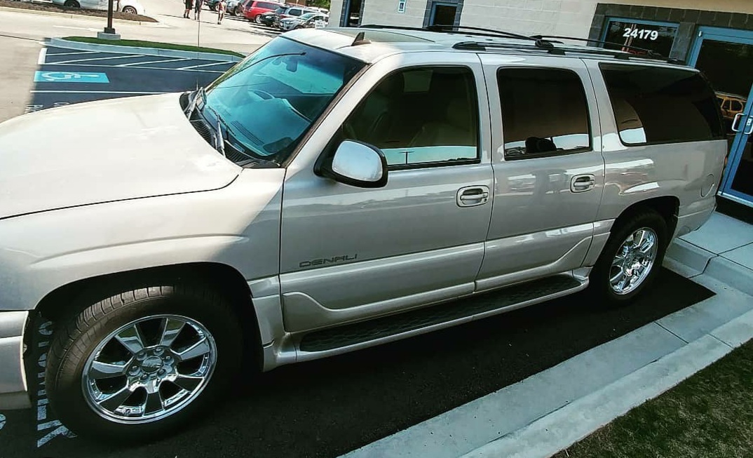

As a kid I grew up with Suburbans - learned to drive on an 89 GMC Suburban that my dad bought new - only new car I think he ever owned, a 99 Chevy Sub shortly after (we needed both - big family!). Since then I've personally owned a 97 (?) Tahoe, 99 Chevy suburban, and in 2018 I picked up a strangely low mileage (comparatively) '06 XL Denali with every option available at the time - still have the window sticker too. Every time I've NOT had one of these trucks, I've regretted it. So, I will be holding onto this one until the wheels fall off...
I've driven it all over the east coast at this point, she's sitting at around 150k miles - truck has been flawless aside from those pesky 20" stock wheels leaking like a sieve. Annoyingly frequent cleaning job is required on them to hold air. Aside from that....she's been a joy. Paint is heat damaged, changer hasn't worked since I bought it but I've been too lazy to fix it (yes, I still use CDs). Wife has since crunched the driver side mirror which is cosmetic but annoying damage.
Also since I was a kid, I dreamed of shoving a big block into a Suburban and making it a sleeper truck. The 454 seemed like the pinnacle of power to me in the late 90s, so while that motor isn't on my radar anymore, this beast of a 6.0 seems like a good alternative. While it won't be a "fast" truck for these days, it could be enough fun for my midlife crisis. I had to replace my muffler a few weeks ago and it woke up the old me lol. I have a vision for this truck, and since I don't have fast cars anymore this itch might need to be scratched. I'm no mechanic, nor will I pretend to be one. Here is my plan, as I start to sketch out the path:

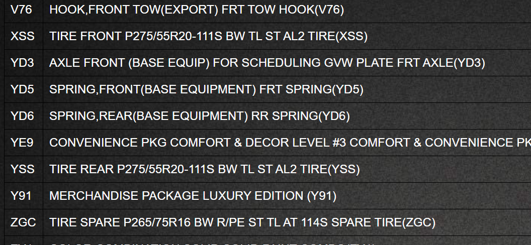

Good plan. Those wheels were GM Accessories for the generation after yours, 2007-2013.
If you put the 4L80, then you'll probably want to change the gears to 4.10 or lower ratio.

Ahh good to know. They look good (better than the Escalade wheels - eww), but aren't in great shape now. Heavy and corroded sadly. Not wheels i would have chosen.

Looking at my build sheet from compnine it appears that the 20" wheels were factory. perhaps not THESE 20" wheels, per se, but my truck had them originally.

Welcome to the Forum from NH.
Pics of the truck, please.
You are already receiving sage advice from the knowledgeable folks on this Forum.
That is a VERY nicely kept truck. I'm sure that you are proud of it.
