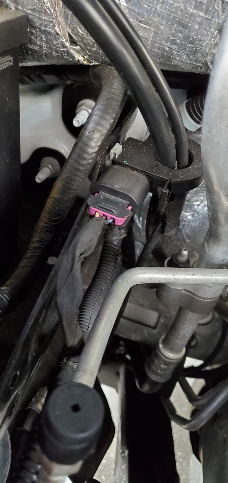

True this. My radio and lights were acting strangely for the longest time and simply couldn’t figure out why. Problem seems to have been fixed after I replaced my cracked and corroded front impact sensors as it’s going on a few weeks without issues.
