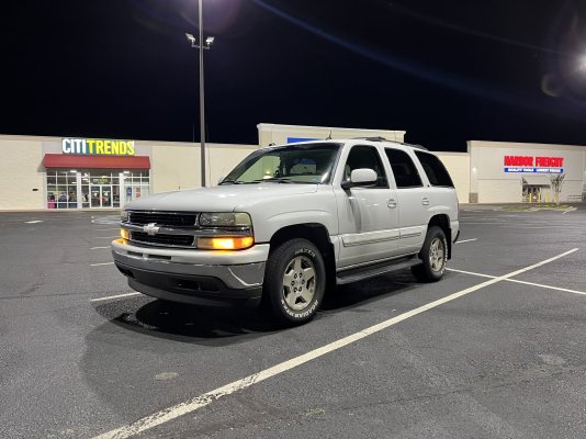

Here’s a picture. It sounded similar to a backfire, but I thought it was a big fuse or something similar popping, since it immediately lost power.
