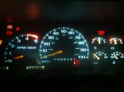

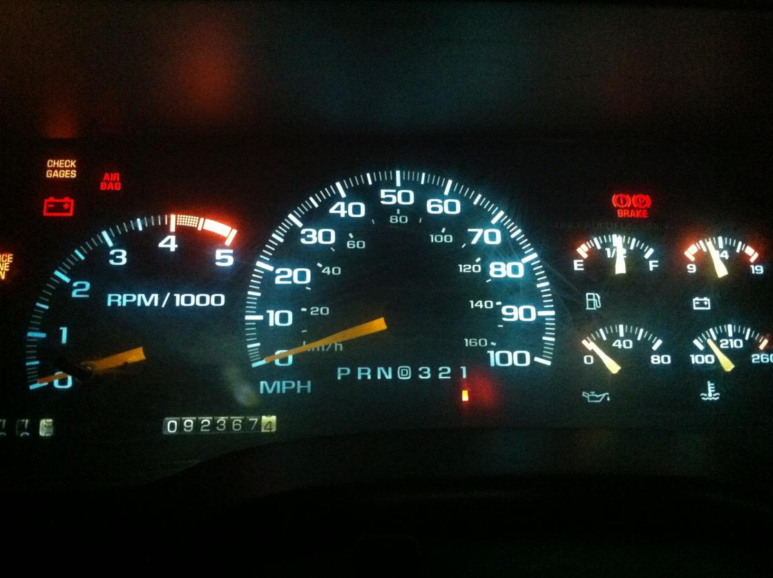

I am also wondering what the white ones would look like in the dash. I dig the blue... it matches the Alpine but with a Pewter Yukon I am not seeing that blue matches too well. So has anyone just done white? I am thinking it might be obnoxiously bright.
they look good
