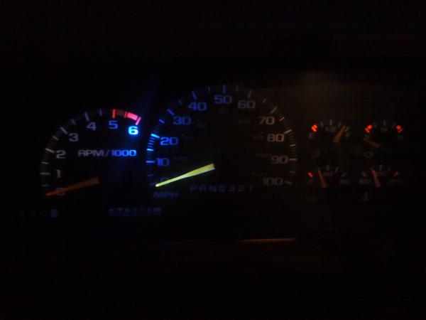

Gonna throw in $0.02 As I was looking for something to this effect before doing it myself, but didn't trip over any good comparison images...
You'd think that's blindingly bright, but blue(at least) comes out, as has been said, with no determent to driving.
What effect are you going for? Multi-colored? That's quite the hot-spot there.

So that picture is comparing 1) no light on the left, to 2) blue in the middle, to 3) stock 194 bulbs on the right?
Sorry, just having a dense moment (a long one) ;-)

No worries. It's stock 194's in all gauge illumination slots excepting the lone blue LED. Being able to see "LED Vs Standard" was something I wish I could have found/seen before I did mine.
To boot, I had to get some indirect ambient light so the phone/camera would even see the gauges that weren't LED lit. Apparently the contrasting levels of brightness were spread out enough that.. Well, ya know.

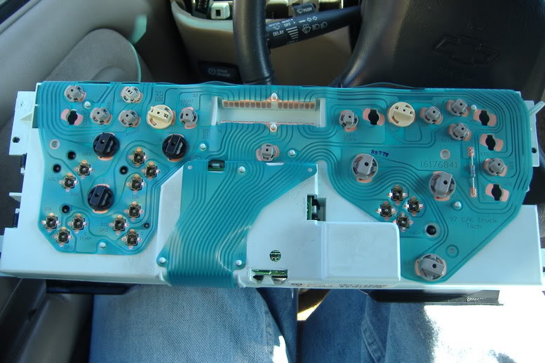

So I have replaced 95% of the interior lights to LEDs. However, I have something strange happening. When I went to replace the lights for the instrument panel indicators the 2 bulbs for the ABS and the Airbag appeared to be a bit different from the others. They had a twist lock base but the bulbs were not removeable. So I purchased 2 new twist lock bases and put some LEDs in there. Now the indicator lights constantly stay lit. Any thoughts?

gotta quetion for you guys.when u do ur led cluster mod the light that u take out of the cluster do they come right out of the original socket or do u have to get special sockets for the leds.The only reason why im asking is because my bulbs r soldered on to my socket but every where that i have reaschered they should pull right out.
gerard
Mar 23, 2011
The problem is that the light. Bulb is soldered to the twistlock socket so I can't pull the light bulb out of the socket.
