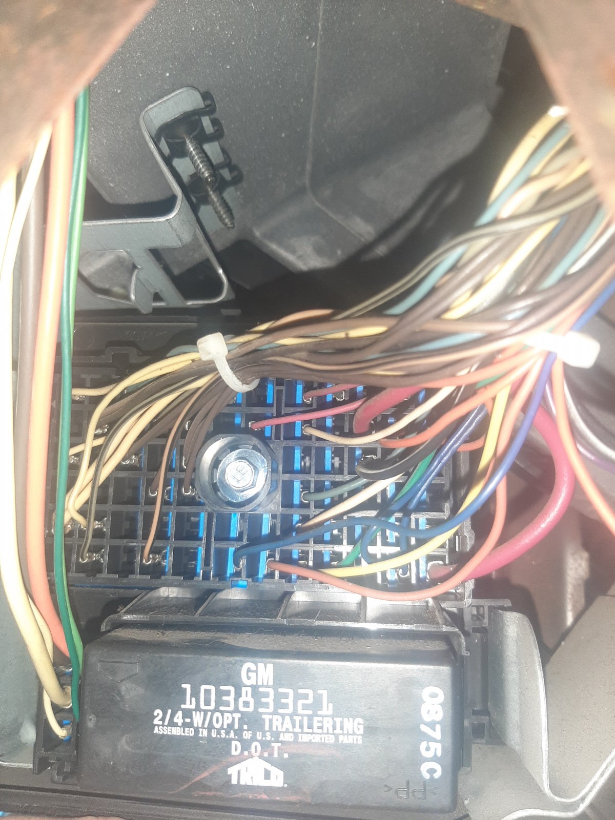

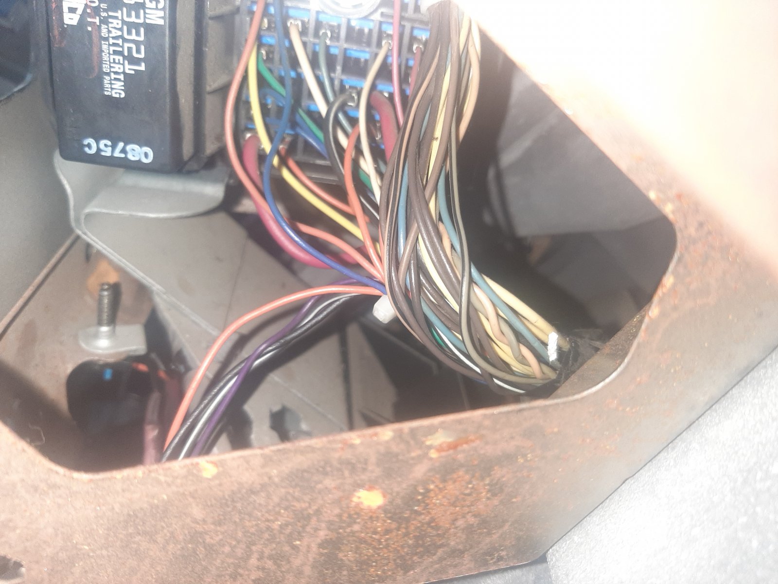

The cable from the pedal sensor to the TAC module has a continuous electrical path. Same for the cable from the TAC module (right side) all the way to the TPS connection. Going to check the other 8 wires coming from that TAC module cable to the fuse box.
Just finished checking and I have flow all the way thru to the fuse block. Noticed a little dirt in the fuse box right where the cables connect. Just going to clean it real good and put everything back. If that doesn't change anything I will move on to checking grounds for continuous flow. After that I'll plug the battery back in and check voltage. Then idk lol

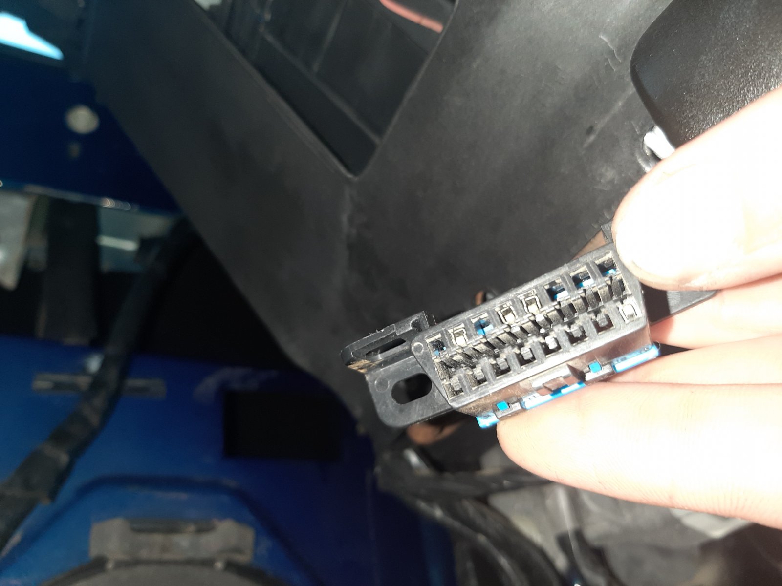

Also this is what my OBD port looks like. Thought this truck had a CAN network but im not sure. That's the first thing I wanted to test. Based off the port, I can't test it thru there.

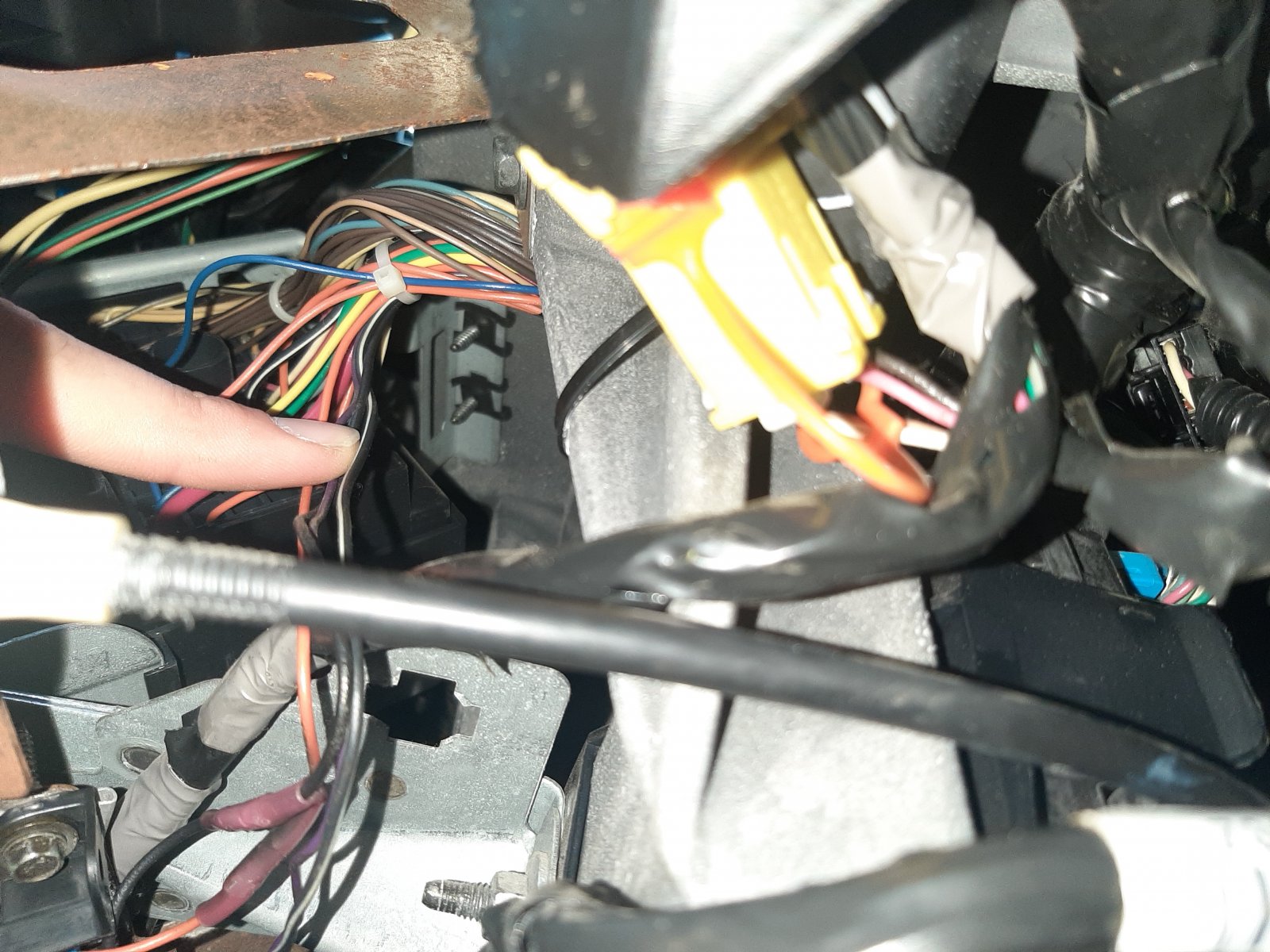

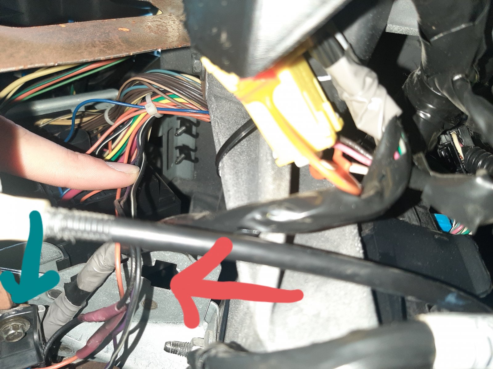

follow the harness for the obd port back and see what's up there should be more than 3 wires
It has four wires that I followed and they just tie into the harness then connect I to the driver side fuse box. I guess I should test continuity? Or keep digging. Seems like it should have more then 4 pins/wires in the OBD port
*Red arrow is the 4 wires from the OBD port
*Green arrow is the OBD port
*forgot to mention that the previous owner had a tracker that was spliced Into the ground and voltage wire of the OBD. Took that out but the throttle response issue didn't change

you seem to be missing pins 6 & 14 which is can bus high & low, has this thing had a engine swap or anything?
No not too my knowledge. Its a 5.3 LM7. When I took it apart it looked pretty dirty and stock.
Thanks for letting me know, I felt like I should have those to test it. Not sure what to do now lol thanks again for the help
