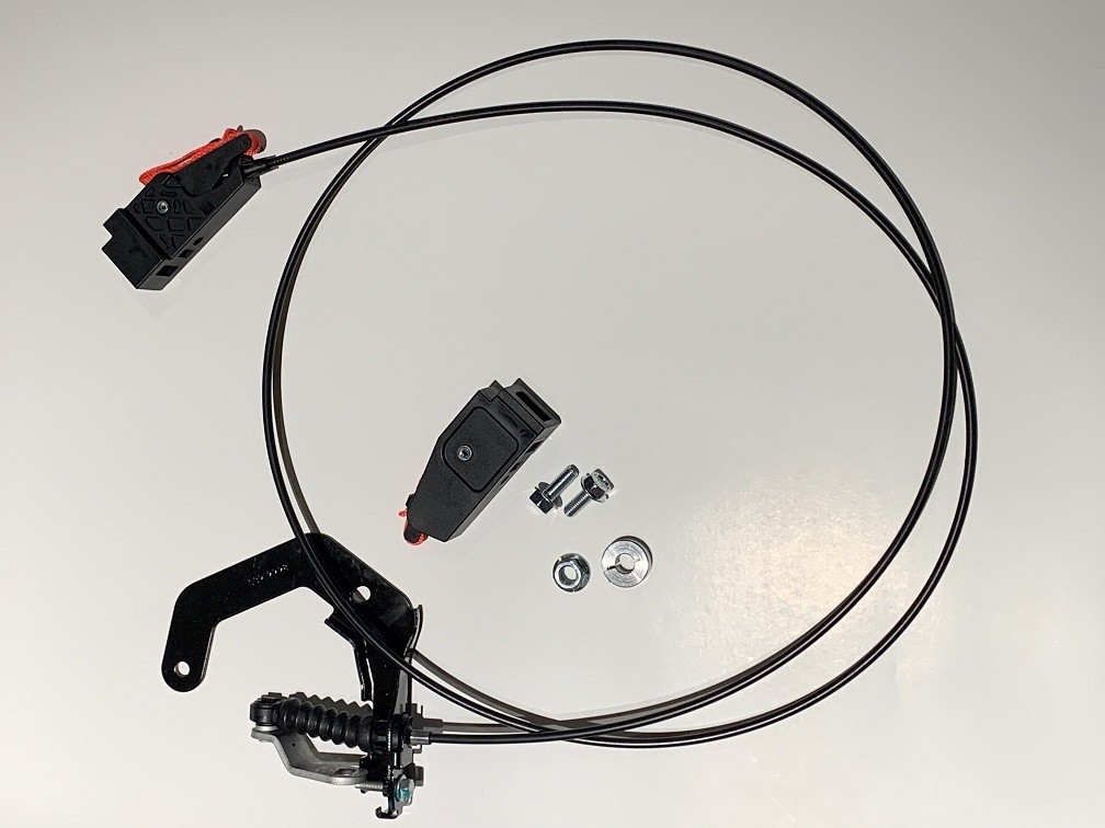

All of the above stated, the transmission park can be overridden with vice grips, an adjust wrench, an open end wrench or even with the GM special tool DT-52910 Manual Park Release Tool.
Depending on the situation, you may need to roll the vehicle to jump start, tow or for some other reason. The issue with manually overriding the parking pawl from under the car is SAFETY. The vehicle CAN AND WILL ROLL. YOU MUST DO THIS CAUTIOUSLY. Possibly even having wheel chocks or someone in the drivers seat to manally apply the brakes.
The tricky part is if the electric parking brake is automatically enabled, this may cause some problems depending on the vehicle electrical system. So this is another thing to think about and may need to be bypassed. Most of the bypass suggestions seem to suggest unplugging the parking brake connectors at the rear calipers, but there may be a fuse/relay that can be pulled rather than unplugging the emergancy brake wiring.
Here are a few good YouTube videos that give you some ideas of what you need to do to bypass the parking pawl in the transmission.
Additionally the GM special tool can be used. DT-52910 Manual Park Release Tool is about $300 depending on the sources you find it available from. I am planning to install this DT-52910 Manual Park Release Tool in my vehicle permemently and possibly route the cable into the driver compartment so the parking pawl can be release from the driver seat. We will see if this is possible. The DT_52910 comes with a 6 1/2 foot cable and you can easily remove the release end but would need about a 1/2" hole to pass the cable end into the driver compartment. A splt grommet could be used to seal the hole and protect the cable jacket. The tricky part would be somehow mounting the release handle as it is really not designed to be mounted, but it could be stored under the dash with some bread ties to be removed for access as needed. Will see how all this goes and if it works out as planned.

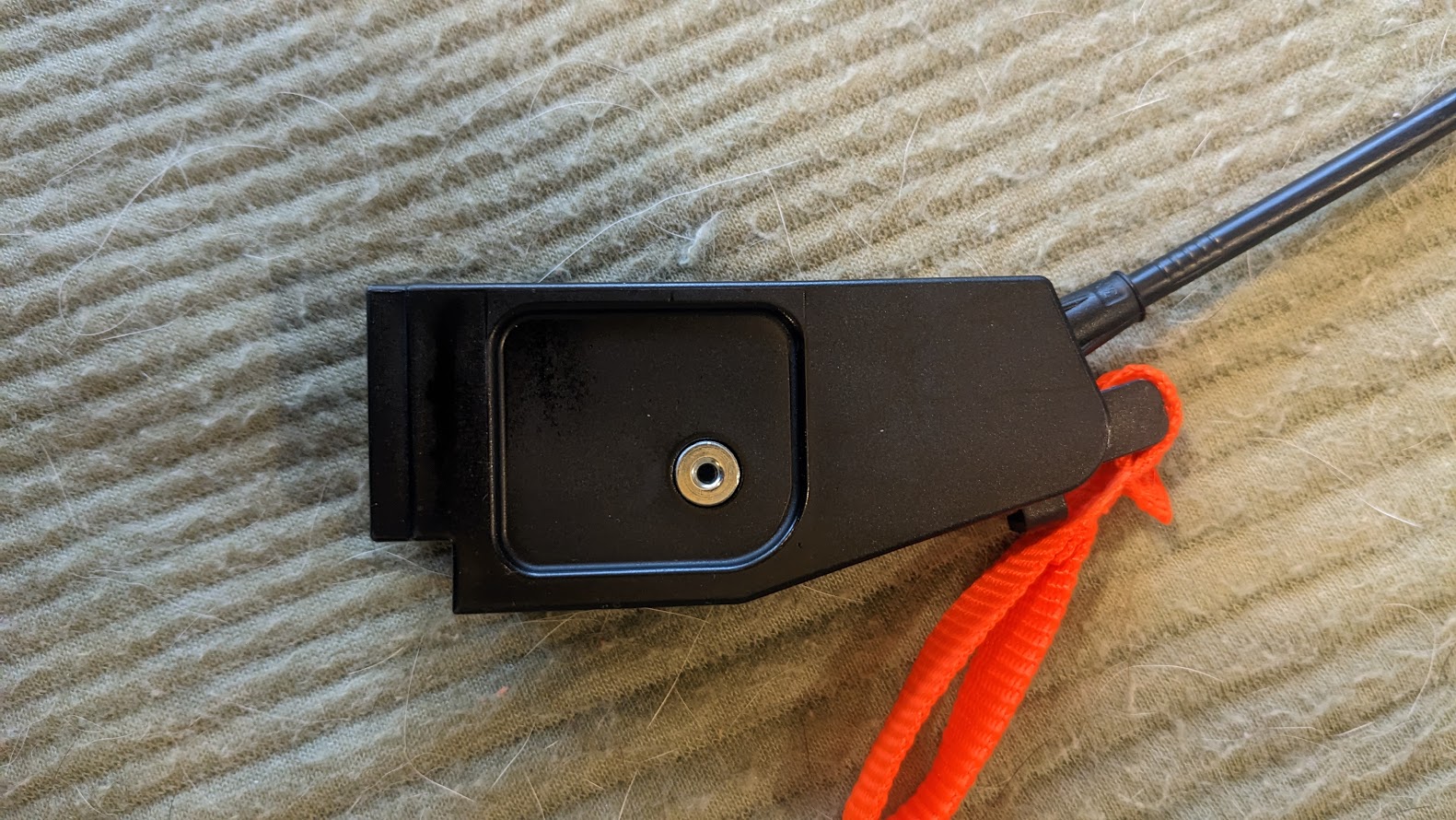

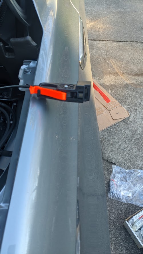

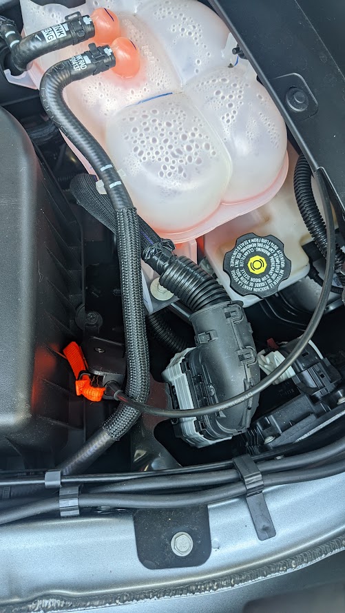

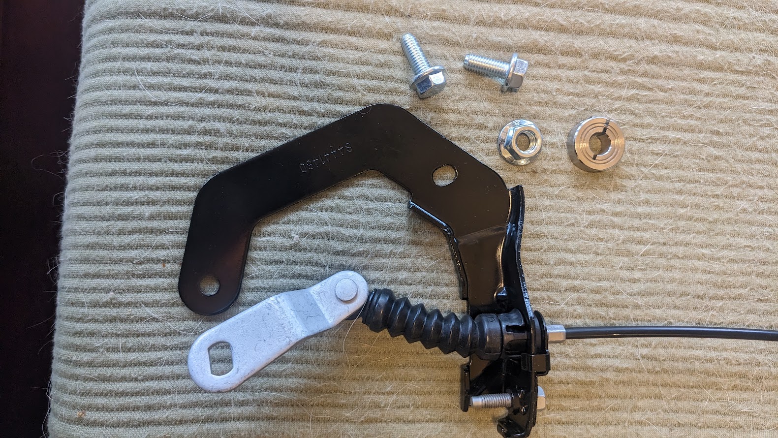

Update!!
So today while it was warmer out I installed the Manual Park Release tool in the truck. I should have put the truck up on ramps, but had a slight dip in the driveway where the truck was parked. I was able to crawl under and instal the braket on the transmission, this is pretty easy. The tricky part is some transmissions may have a threaded shaft, mine did not, so there is a locking collar with a 2.5mm hex head screw that clamps the collar on the shaft on the transmisson. The issue is the bracket that slides on the shaft floats and there is not a good way to make sure the bracket is tight the way things are designed. I installed 3 flat washers I had laying around to take up some of the space so the bracket was not wobbeling around as much. I think I need to find and add a wave washer to preload the bracket slightly, but the washers helped quite a bit.
Routed the cable up under the hood for the time being, it may stay there, not sure. So for now I just need to pop the hood and pull the loose end of the cable up so I have access to the handle to release the parking brake.
I still need to come up with a full process on how to get the vehicle in Neutral without trigger the parking brake. I have some ideas other than unplugging the connectors on the rear calipers. I did a quick test and when the cable handle was pulled the transmission selector Neutral light was blinking and the dash display indicated N.
I did get a pop up message to Service Transmission on the dash display, it did seem to clear once I released the Park Release handle, but I will need to follow up and see if there are any permanent OBDII transmission codes. I actually did have the SES/CEL/MIL light on after starting and driving the truck. 2 codes, P0700 Transmission Control Malfunction and P187E Transmission Park Valve Stuck Off. These are expected unless the battery is disconnected prior to using the Manual Park Release. The codes would also not likely be triggered if the ignition is not turned on. I turned the ignition on to see if I could get the parking brake to release, did not have luck, but need to try a few other things to see what happens. These codes and the SES/CEL/MIL should clear on their own after 10-20 start cycles, or should be able to be cleared with a standard OBDII scan tool or App and interface. I have not had a chance to clear the codes yet, probably try to do this in the next few days.
At least I now have a Park Override installed in the truck if I need it for any reason.
