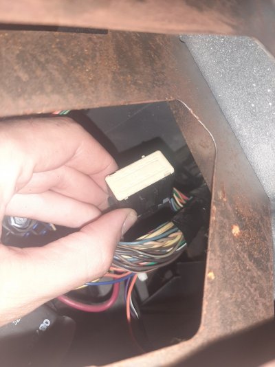

Well, I tested it with the scope with the hvac plugged back in and everything was responding properly with no reduced engine power.
I think the fix could have been the grounds I fixed and cleaned, upgraded to a LED flasher relay (do this if you upgraded any lights to LED), and I updated all modules with pass thru tool and Acdelco sps2.
I will post another update if that message pops up again. Thanks to everyone and good luck with your projects!

Turns out it wasn't the HVAC. Pretty sure just grounds and the Flasher Relay. Electronic throttle module, brake module, and stoplamps are connected to the Flasher Relay. I installed a bunch of interior LEDs and I think it caused some issues with the stock Flasher Relay. It also had aftermarket LED headlights that I think caused the U0107 communication code originally, but since it was only two LEDs that got upgraded it didn't mess up the stock Flasher Relay, I think.
i bought Uscope from AESwave.com, sorry I couldn't post link atm. Website is being weird. The Uscope works great tho! glad I have it

UPDATE. No more reduced engine power after all the work I did.
"Service stability system" message is popping up only. I'm sure I have to maintenance the ABS module but she's rolling!
