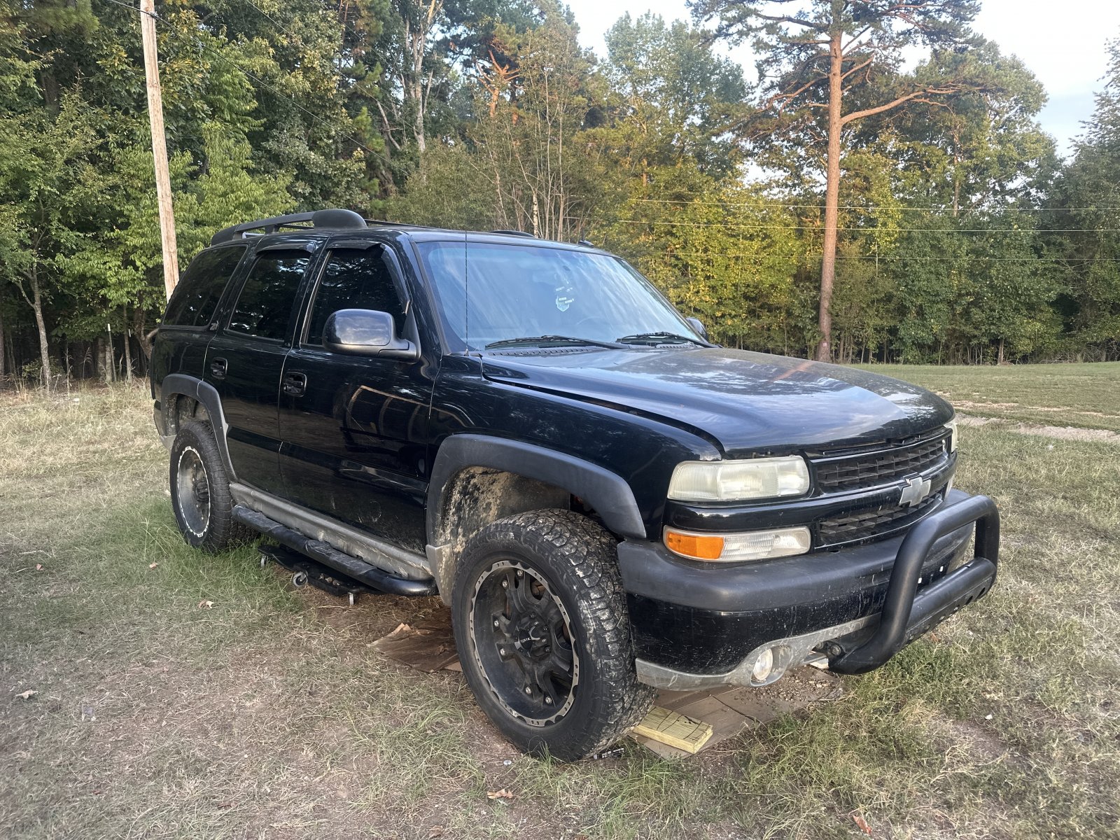

Pics of the truck, please.
You are already receiving clarifying questions and sage advice from the knowledgeable folks on this Forum.
