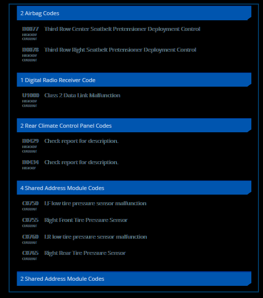

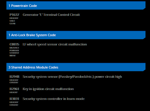

I was driving home from 4th of July celebrations this morning and got ABS + TC warning lights on the dash of my 04 LT. I have an OBD-II scanner module installed, cranked up the app, ran a scan for all available codes and got error codes for these two issues. Plus a laundry list of other problems that I hadn't seen before today. I have tools to use. At least enough to do minor to intermediate repairs myself. But, I'm a novice mechanic, at best. So I wouldn't know where even to begin with diagnosing these issues, on my own. I'd at least like a severity-level based on the data so I know what to tackle first. Are there any issues here that I'd absolutely need to take to a shop for proper repair? Any advice would be greatly appreciated. Thanking the group in advance, for any help.
P.S., Sorry if the images are hard to read I couldn't figure out how to make them clearer on the app. I can clarify the data if anyone needs it.

The code pics are unreadable, so post up better pics of them, or just list them in a post. If using a phone for the app, perhaps a screen shot would be clearer.
