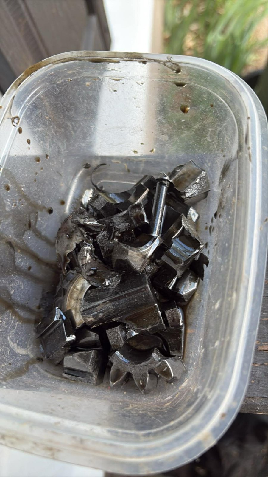

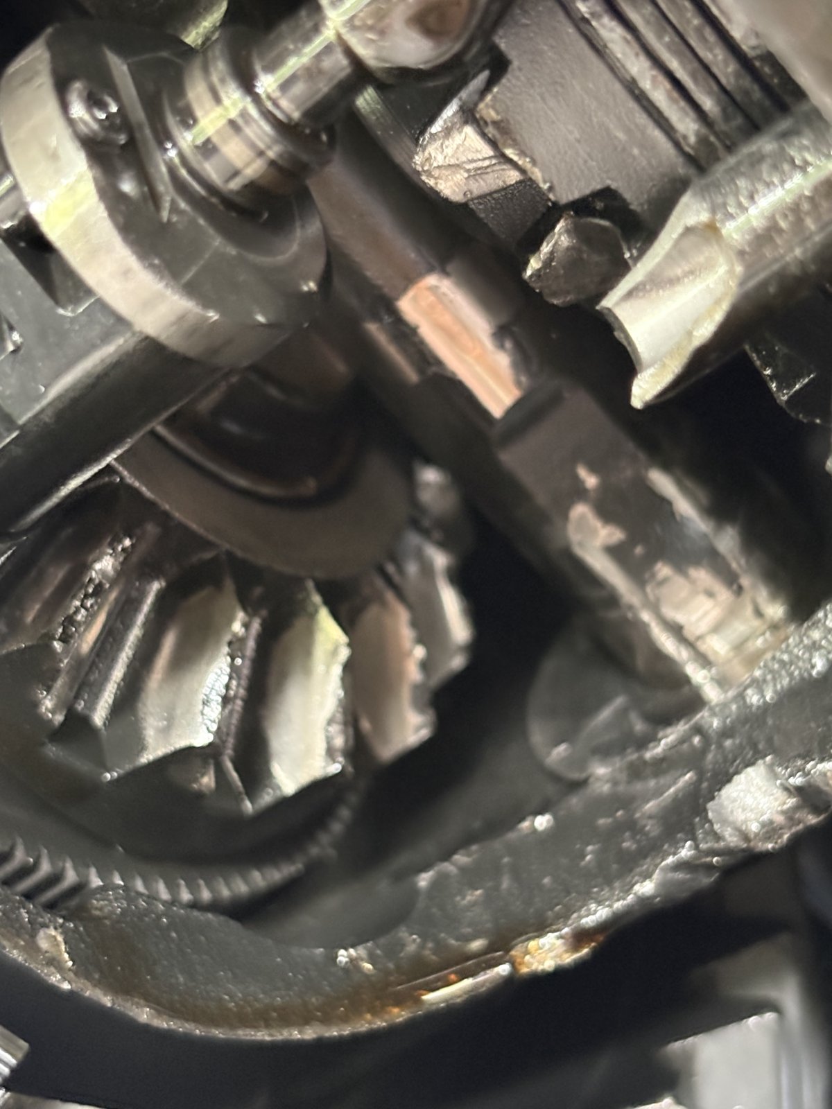

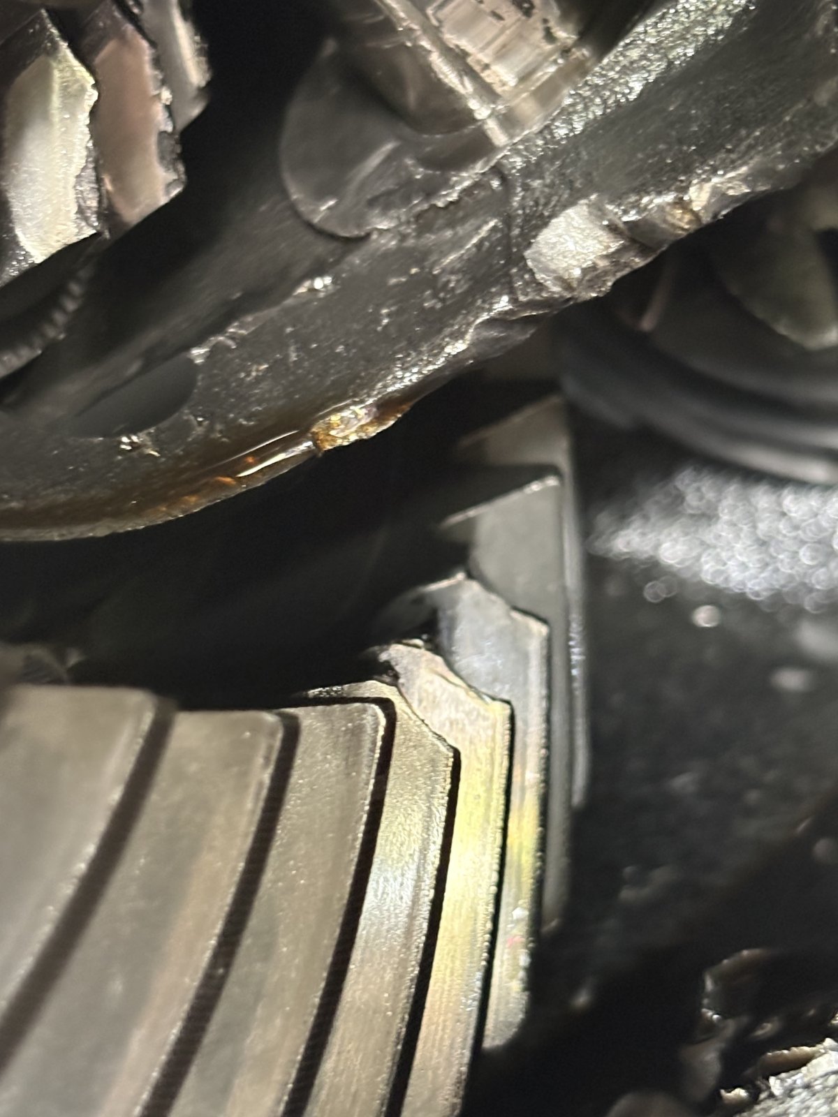

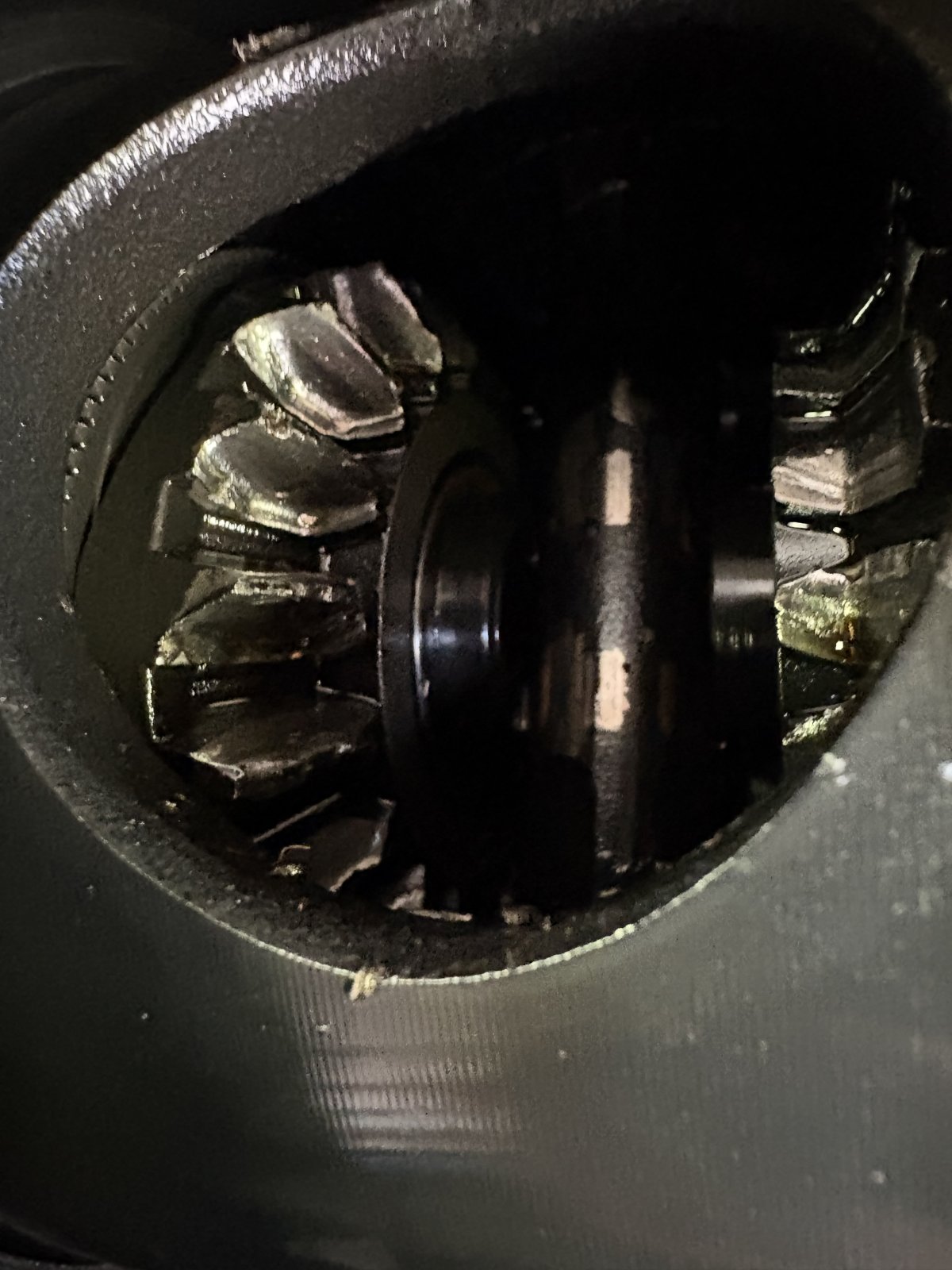

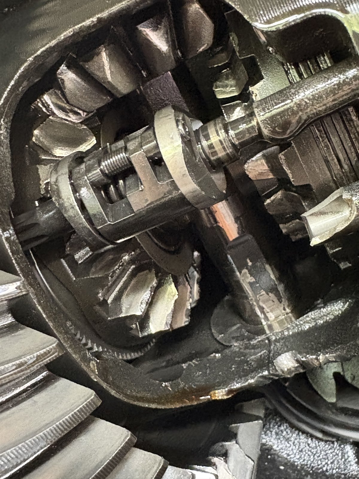

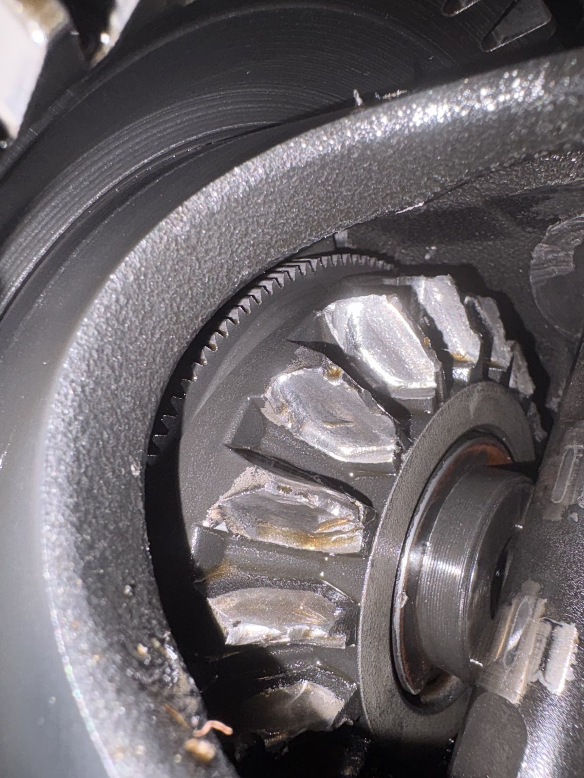

2005 Tahoe Z71 Alright as the title suggests my G80 decided to grenade itself. I finally got around to fixing the rest of the issues on this thing after letting it sit for a year in the driveway. Drove it to the job site with no noise whatsoever, went to leave and all of a sudden it acted like the diff was locked. Kept going and eventually it stopped, pulled into the courthouse parking lot to go renew tags and the whole truck just jerked all over. Get to my house, which is right around the corner from where I was and then it grenades completely. Now here’s the question, what’s a bolt up replacement that’s better than what came in it? I’d rather just bolt up a newer rear end and modify some stuff if needed so I don’t need to worry again. I know people will say put an Eaton or Detroit in it but with how cheap I can get a complete rear end I’d rather go that route. Debated putting a mini spool in but worried about snapping an axle.

I guess I should add that what I meant by it feeling locked was that it had the locker engaged, not that it wouldn't move and I just forced it. lol
