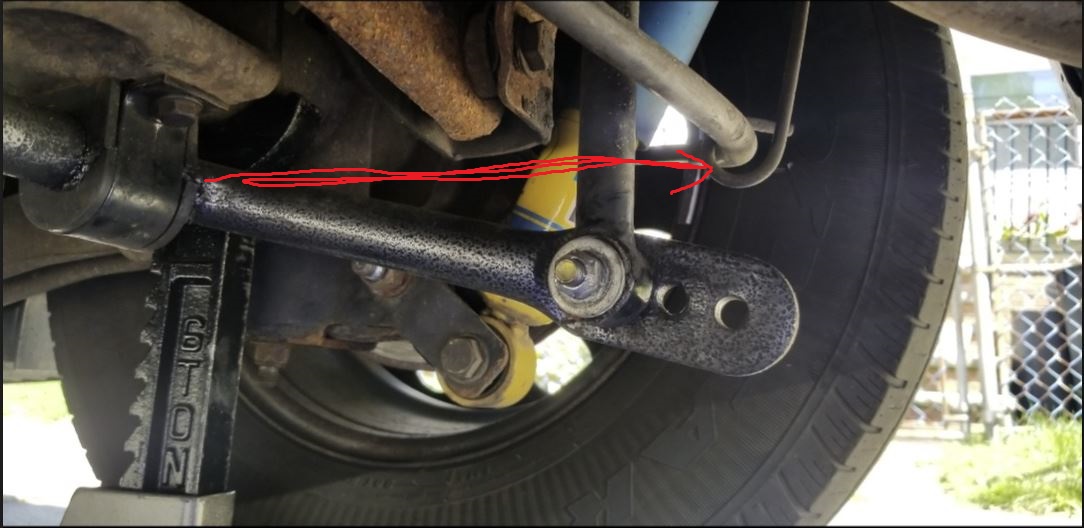

Isn't this one the most aggressive? That's where mine is.View attachment 415592
yes but it's not level where it should be, bar should be even with the body, not tilted down. adjust the endlink shorter
