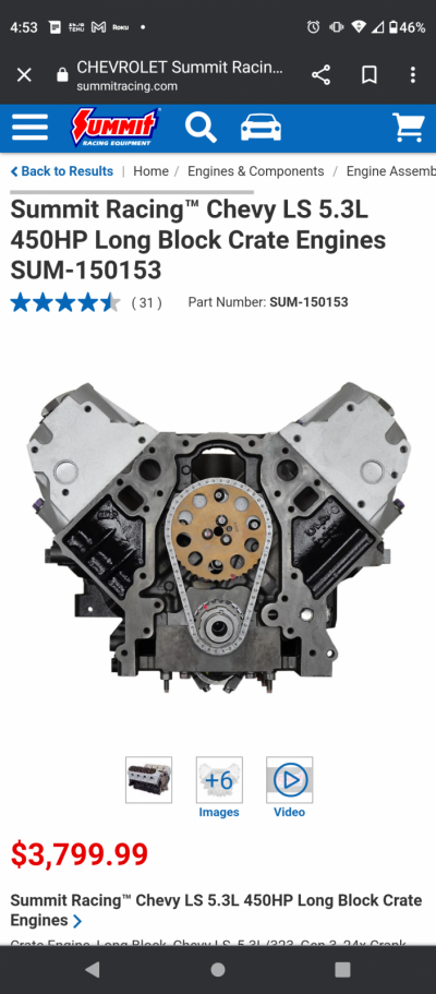

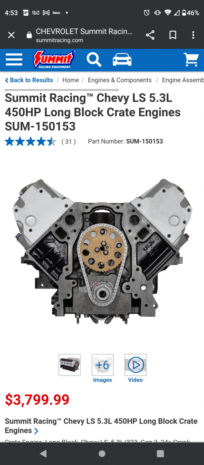

This is the motor I'm looking at, just for reference. If I choose this route, what would be the next thing to look at? And when you say upgraded rear end, are you talking about the rear suspension??
Sorry for all the questions but also, now I've heard the 4l60e are trash, would a rebuild kit be able to handle the power from the motor? Or should I do a tranny swap with something more reliable?
Last question, would anything need to be done to the rear axle? Will the change in power and torque be a problem for it? I know I'll spend a good bit of money either way
the 4l60 can be upgraded to handle more power, as for the rear end you could add a eaton detroit tru-trac those are fairly indestructible
you wouldn't need to worry about pinion ratio unless you wanted to be able to do burnouts down the whole block, but changing the ratio affects top end and possibly mpg.

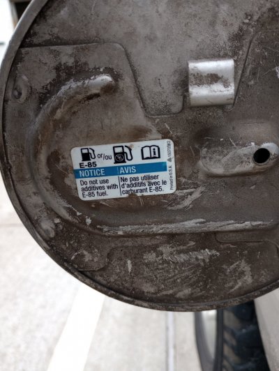

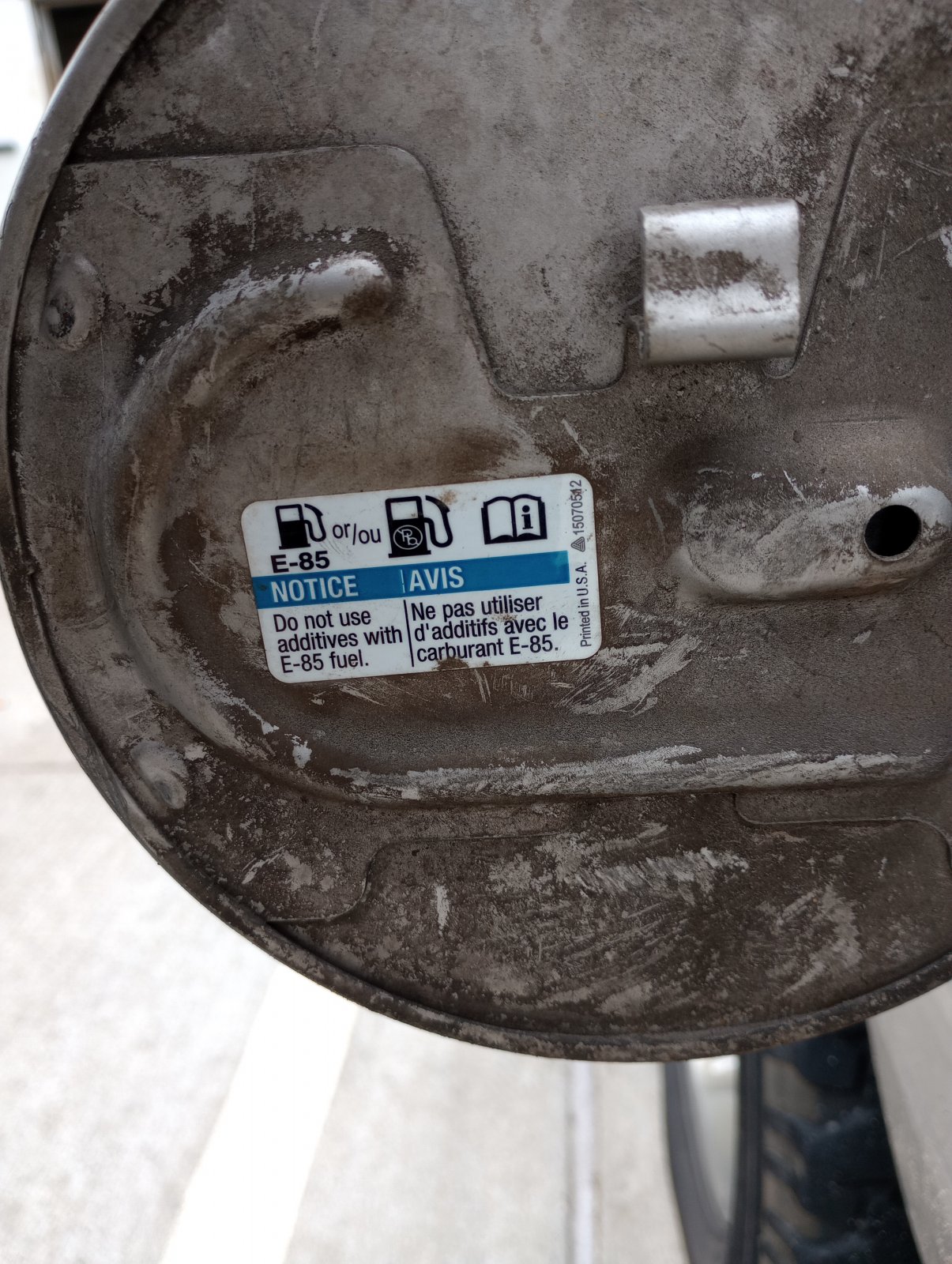

Not doubting you, but why would your Yukon with a "Z" engine not be a FF? If the 8th character of your VIN is "Z", you should have an RPO code (white sticker inside glovebox lid) that says "L59". For engine swap purposes, it's irrelevant if you never run Ethanol fuel, at least, nothing higher than E10. But, I had to mention it if you're looking at engine options. It'd be nice to have the FF intake manifold, or at least the injectors, since they can support more power, as with more cubes.
An LM7 would work fine. No power difference, though. As for the Summit one you linked to in your reply to Wes, I wouldn't go that route. It's not just about the numbers. Looking at the basic cam specs they listed, that engine could make those power figures, but they'd be all mid- to upper-end gains. Having a fullsize SUV, and the XL version at that, it'd be weaker accelerating from a stop and normal city cruising. It'd pull hard when flooring it to pass someone while already going highway speeds, though. But, how often are you high-speed racing your Yukon XL? You do a lot more accelerating from stops. Do any towing? You can do some things to help, such as a looser torque converter and lower rear end gearing. The engine already has 10:1 compression which helps power across the board. For about the same money, I'd get a rebuilt 6.0 with a well-designed cam. You can maintain and increase power across the whole RPM range and not sacrifice any in the usable/needed ranges. The key is to have the whole package work together- engine, cam, converter, trans and rear end gearing.

vin z is flex, look at the inside of the gas tank cap flip cover, there is a white sticker stating it is flexfluel as well as the rpo code list in the glovebox as dub already mentioned
These are what I found, honestly I've only been putting 87 in the tank

ya that just says not use to use additives with e85 (ethanol) because additives are made for gasoline
Ya but I don't see anything saying it's flexfuel. I might be over looking, or just don't know what to look for, I see the L59 on the glovebox sticker though

LOL, it say's right on the sticker e85 or gas, that's what flex fuel is, you can use both or one or the other
And my dumbass moment has arrived, hahaha, but like I said that's why I'm here, so I can get knowledge and not **** this truck up.
