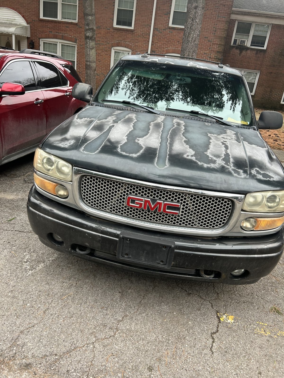

Looks...well...fair...I'm assuming the frame and metals are not rusted to hell? Where are located?
I would personally take some money aside and get the roof and hood painted. Will make that truck look almost new again.
I've got a project 2004 Suburban 2500 I've been slowly working on. The hood was smashed and both it and the roof were peeling badly. I'm learning the auto refinishing craft, but have decided I'll only own and drive old trucks if the paint can be halfway decent looking...our Texas sun alway destroys the hood/roofs. SMH.
So I installed a used hood and painted it along with the roof. To my surprise, I've already gotten 2 guys (my brother's acquiantances) asking if I'm selling...

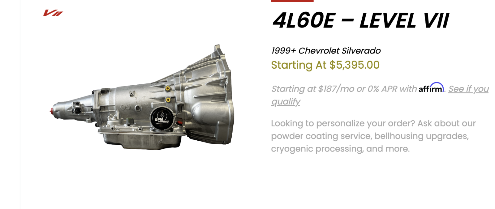

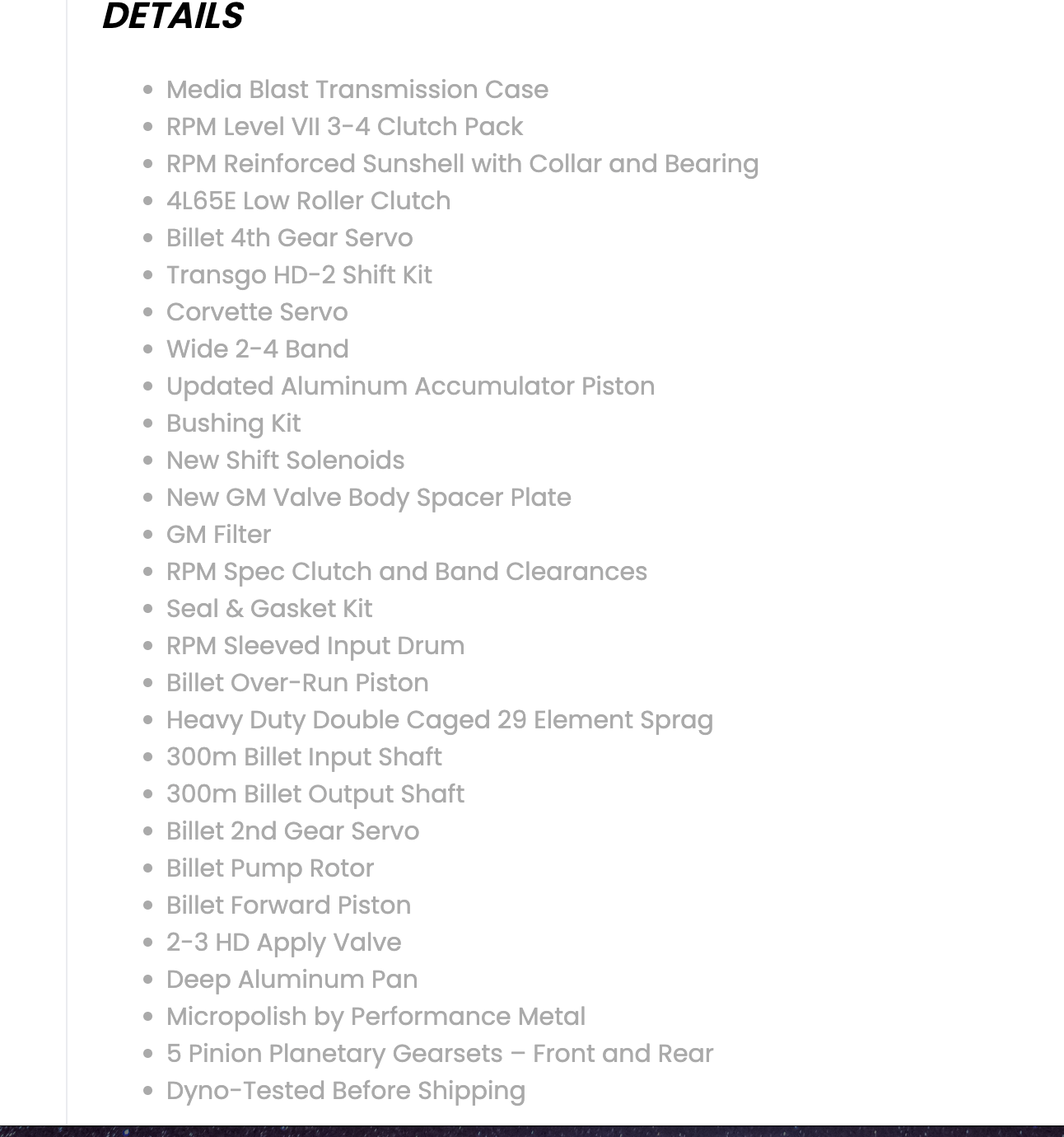

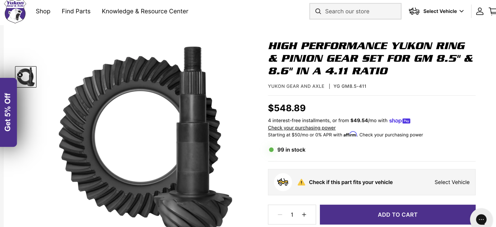

Thanks, guys, for all the comments and feedback. One thing I'm gathering from most of the comments is switching to 4:10 gearing. My new air ride system and brakes arrived yesterday, and will be getting installed over the weekend. I'm now looking into getting the gearing and a new trans. My mechanic recommended the parts he currently runs in his own Denali ( see photos ). Have you guys ever heard of or used these, and are there any others that you might recommend? As always, all comments are greatly appreciated, and thank you in advance.
PS I changed my own seprintine belt yesterday.
View attachment 475013View attachment 475014View attachment 475015
I went with Performabuilt ‘s level 3 “invincible” 4l60 and a 3-disc billet FTI torque converter for my 02. They sell a black edition 4l60 for about $7400 that they claim hasn’t been broken by anybody yet. They manufacture their own parts in-house and modify OEM parts with a full machine shop.

I just completed the gear change from 3.42 to 4.10 in my all-wheel drive Denali. I also went with a Truetrac rear end gear set versus the standard G80.
Total cost for parts and labor for both units was $4,400.
After catching my breath (could buy another decent-ish GMT800 suv for $4000), the questions I'll ask instead of freakin out is:
How much of that $4400 was changing to a TrueTrac? How much of that was labor?
You know, I don't really care.
Was asking for everyone else too, not just me; no insult intended, glad you're enjoying it.
