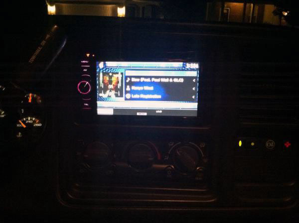

Well, it took me around 4 - 5 hours but I finally got my Double DIN installed into my 2001 Suburban!

very nice! did you use the 03+ radio basket? how does the climate stuff fit?
Thanks! I did use the 03-06 Bezel and Radio cage. It was more difficult than I had anticipated. It fits ok, it's a little "off" but no one can tell unless it's pointed out to them.

Looks good.
If you have a space issue, you can cut the back of the cage for more room for adjustment.
