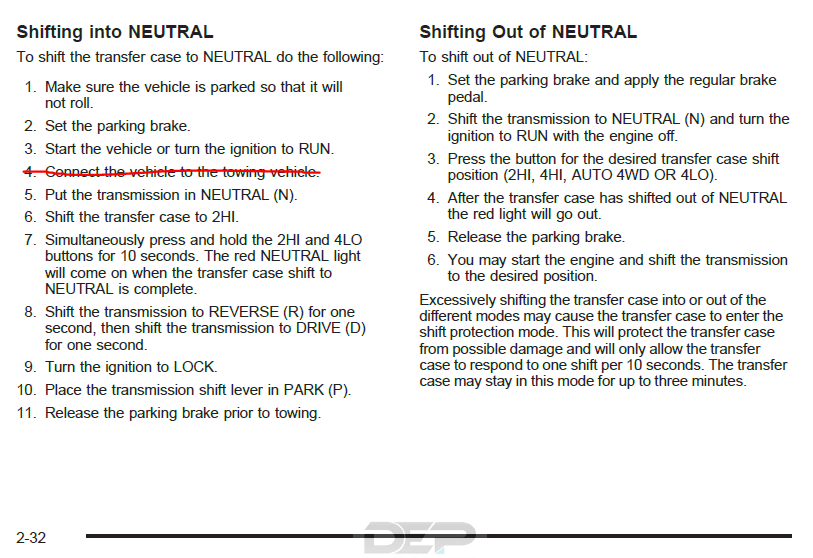

Can you put your TC in neutral? Wonder if it makes the same sound when it's in Neutral? (Be sure to set parking brake and chock the wheels.)
Guess that explains why there's two speed sensors right? I've never driven it in Auto, or put it in Neutral. I'll try that but 1st I think I should refill it with fluid. I'll try to pick some up tomorrow. And it makes sense the front shaft would turn while rolling. I had the "Service 4 Wheel Drive" warning on but I believed that was because I had the ABS Fuse pulled so we could drive it. Otherwise it "self corrected". That was until I replaced the Steering Wheel Position Sensor. After that was replaced and I put the ABS Fuse back in and cleared all the codes it ran fine. Other than my wife smoking the rotors and brake pads. LOL!

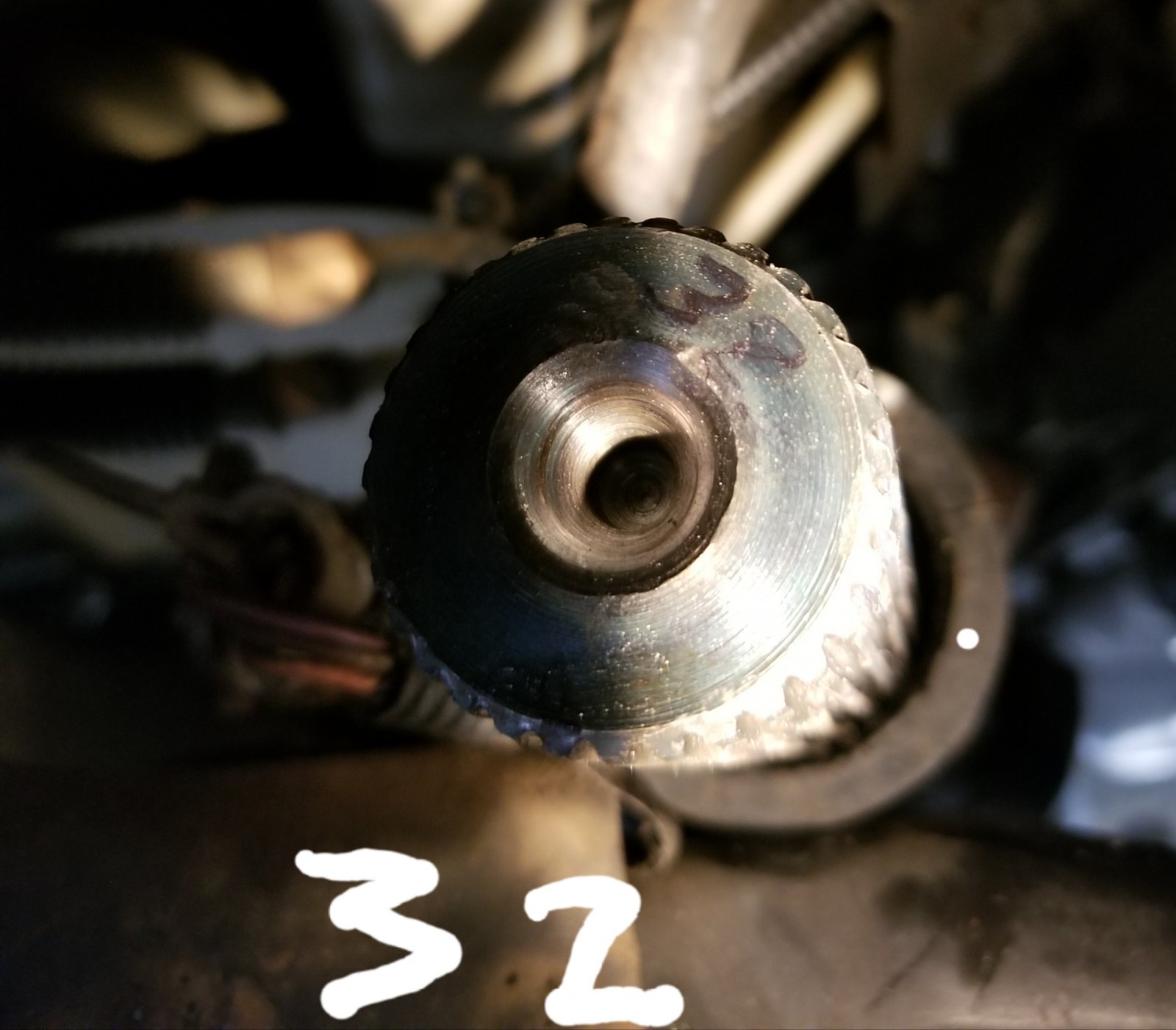

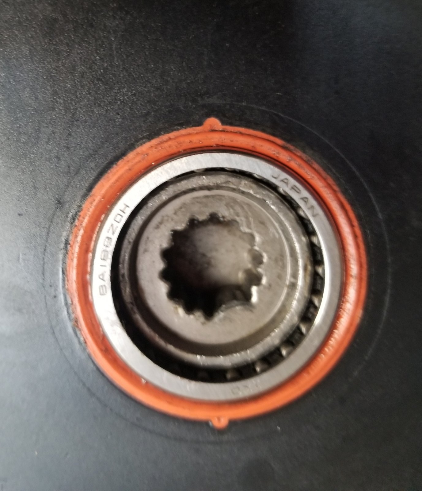

Good luck! And don't actuate the encoder motor while it's off the T/C. You can also manually attempt to change the T/C mode (2wd, neutral, etc.) using a pliers or channel lock on the shaft, but return it back to where you started from when you were removing the encoder motor. You may have to wiggle the rear propshaft to take the tension off of it while manually changing modes.
Also curious about the shape of the shaft -- is it two flats or a splined shaft? Believe these later model NBSes to be a splined shaft.
Thanks Fless! I'd be dumb enough to hold the encoder in my hand to see if it cycled! LOL! I'll update.

Okay guys, here's what I did. Found AC Delco Auto -Trak II fluid at my local Napa Auto Parts for under $10 qt. Refilled the TC. Switched it into Neutral, pulled the front prop shaft, and then removed the Encoder Motor. Started it and thought I heard something for a split second. Crawled back under and with a small pair of pliers in the widest adjustment, rotated the shaft counterclockwise. Real easy to move. Fless, you can move the shaft manually, and the encoder if it's plugged in by pushing whatever button you want. You just have to make sure they both are in the same position when reinstalling. By moving the shaft manually I believe one direction is 4 high and the other is 4 low. Started it back up and sure enough it was making the same noise. Put it all back together after realigning the shaft to the Neutral position and dropped it to the ground. Tested it in all the gears. It goes into all the gears great. Auto 4x4, 2 wheel, 4 high, Neutral, and 4 Low. Drives but makes that noise briefly in every gear. So I'm not going to drive it. The noise sounds like it's coming from the front shaft output inside the TC. I now don't believe this guy that told me the chain and pump don't move unless it's in 4x4 mode. How else could it be making this noise? Angry, tired, and disappointed. Guess it's gotta come out. I appreciate everyone's input and will welcome more if you have any!20210811_095342.jpg20210811_095228.jpg20210811_095158.jpg
