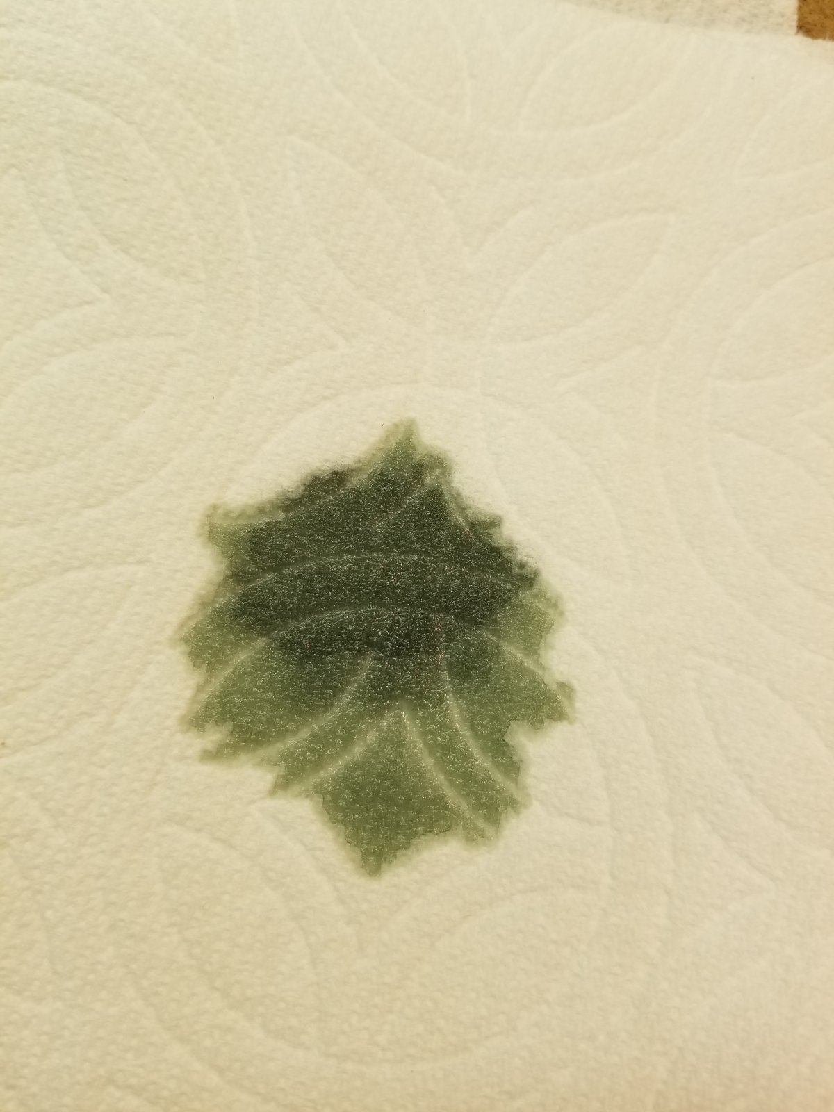

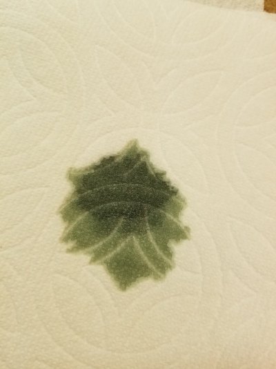

Could it be making noise because it's dry?
Not dry. Actually the fluid looks pretty good, no metal either. I expect they probably changed it when they did the transmission 7100 miles ago?

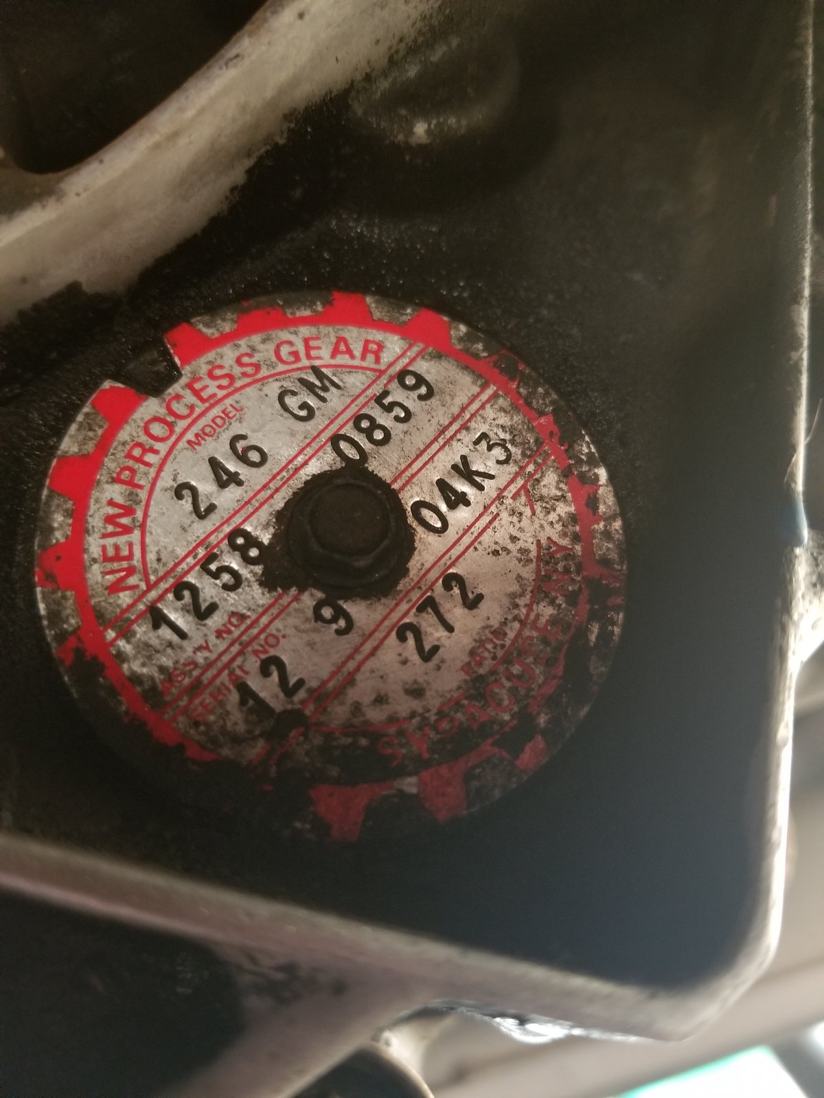

Was the fluid blue? Those 246 cases take Auto-Trak II fluid, not ATF.
EDIT: if it wasn't blue fluid, check the badge on the TC to verify that it's the NVG 246.

Okay so is the green fluid correct then? Would I be better off buying a Remanufactured TC or having this one rebuilt? Any online recommendations?

I wouldn't use anything other than OE Auto-Trak II fluid. It takes only 2 quarts, and it's blue.
I had mine rebuilt locally and have no online recommendations. I can't even recommend the shop that did mine since they're out of business now. :( But I'd do local again if I found a shop that has been around doing these, and has a good warranty. I want labor included in the warranty.

I'll start searching around. I watched the video you attached and noticed the fluid in that one was green too. But, going forward I'll go with what is OEM recommended. Guess I won't really know what the cause of the noise is until it's out and torn apart. But again depends on whether or not this one goes back in or just gets swapped. I'd rather do cams in a Harley right now after seeing that video. LOL! But it's just foreign right now. Anything can be learned.

It is a candidate for pump rub, and that should be protected by the upgraded part. Apparently it hasn't rubbed through since it appears no fluid was leaking from the outside of the case at the common pump rub site. He drained nearly a full 2 quarts. Richard talks about it in the video I posted.
