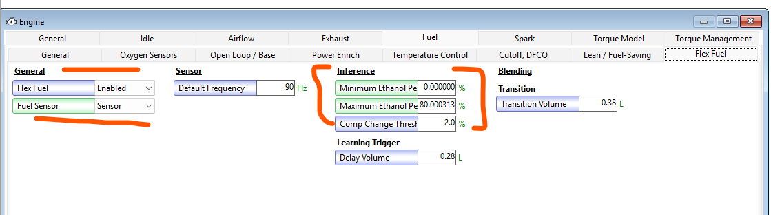

Things I have done.
Engine side:
1. Enable the flex fuel sensor.
2. Ethanol content min and max values adjusted to 0-80%.

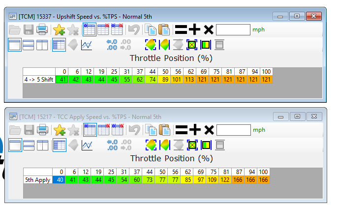

Transmission side:
I have adjusted the shift speeds and scheduling.
TCC apply speeds adjusted so they are 1mph after a gear change.
Pressure bumped from 26 to 31psi.
SLip reduced by 50%.

I have done some very basic work on my transmission:
No TCC in 1/4.
Reducing slip by 75-90%.
Turn off DFM.
I have been toying with the idea of some more changes, but somewhat held back by ignorance.
You mentioned that you changed the TCC to lock 1 mph after the shift point. It is my understanding that once it locks, it stays locked until it hits a release point (even through shifts) So only the first lock point has any effect unless you happen to hit a release first. Is that your understanding and observation? I would have thought it would unlock between shifts, but that doesn’t seem to be the case as far as I can tell.
Also do you know how you can access the TCC table for the “M” mode? I would like to prevent any TCC lock in M mode if possible.

So it does not matter that much. OEM say the APPLY in 5th gear was 37mph across... but the shift was set at 40mph so even though it says lock at 37 until you actually get into the 5th gear it wont lock but what I like is a shift feel into 5th gear and slightly after you can feel the TCC lock. In other calibrations I had it lock 5mph after the shift and you feel a rubber band effect where it does pull less with same throttle until the lock occurs and then you feel bump into more power because you remove that slip and in 5th gear sometimes under load you could be doing 400-500rpm slip which is that rubber band effect im talking about.
As far as the M mode, that references the tap up tap down tables under TCC Apply Release, if you set those to high numbers the TCC in M mode wont enable.
Pattern A and B those I think are the tow haul buttons.
You may have to change one at a time and watch for slip on a log and see which one exactly is the one that does it. Because you can have TOW HAUL ON and in M mode and OFF and in M mode and depending on that it will lock or not lock.
You can also let it lock up until say 25% throttle and then unlock after that. If it slips like mine does aka Shudder its above that threshold so I just let it rip until throttle gets reduced and then relocks.
Also keep some slip, I find it that if you set it to 0rpm, the system is PWM so as soon as it reaches zero it reduces pressure then it slips then it cranks the pressure. I found on healthy TCC I keep it at something like 10rpm for lower RPM and then 5rpm slip at higher rpm and if you watch it on a gauge (SCANGAUGE3) on highway cruise it would hold it pretty darn good. If you set to 0 then it bounces from 0 to 10-15 sometimes more RPM so its all over the place.

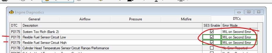

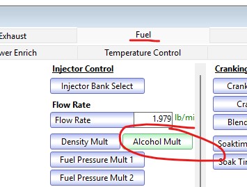

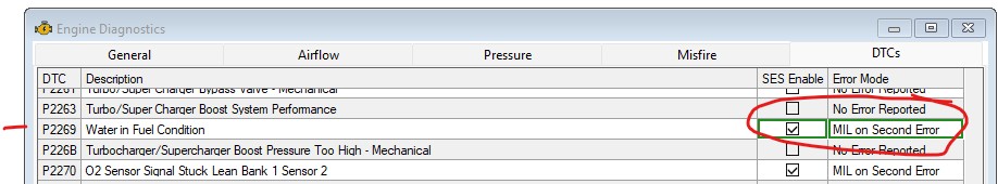

If you've added the FF sensor and are running FF, there are a few other things you need to change.
Under - Fuel System>Diagnostics
Under - Engine Diag>DTCs
Finally, this is a little deeper and not talked about much, so I'm not going into detail here to explain. In short, check your Alcohol Multiplier table for the injector flow rate... it may not be right. A tell-tale sign it's not right is: After you've dialed in your Airflow (Fuel Trims) on gasoline, when you switch over to ethanol, and the fuel trims are off... you'll need to adjust this table. Otherwise, you'll be chasing your tail. General best practice is to get your airflow/fuel trims dialed in on gas first. Once you have that, then start adjusting the FF stuff.
Under - Fuel>General
Once you get the wideband installed, you'll then be able to dial in the PE for both Gas and Alcohol.

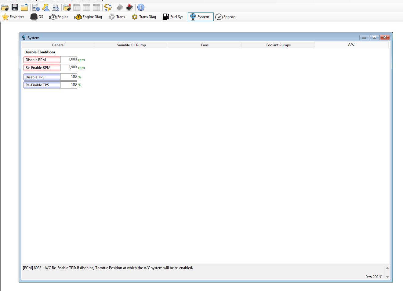

If you want to remove some engine load from the AC systme during heavy accelaration you can set the AC Disable speed to say 3000rpm.
The AC will not function above that RPM, and will re-enable under the next setting which in my case is 2900RPM.
This may not seem like much but it will allow you to gain some lost power that is used to run the AC compressor.

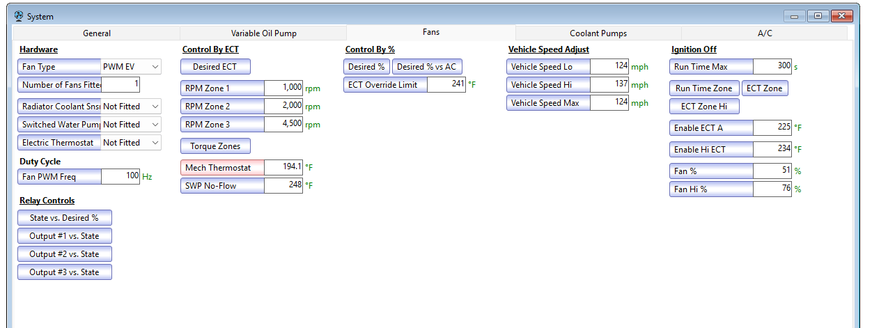

If you change your thermostat to a lower temperature make sure you correclty tell the ECU what you got in there so its not trying to fight a lower temp thermostat.
For example. I went from 203F OEM thermostat to a 194F and that change is set in the calibration.
Older 9C1 calibrations simply disabled the AC compressor clutch over, about 90%TPS, and reenabled the AC compressor clutch under about 85%,
which is to say, sooner than a civilian calibration that was otherwise similar.
It doesn't just free up power, it also protects the AC compressor from excessive RpM.
