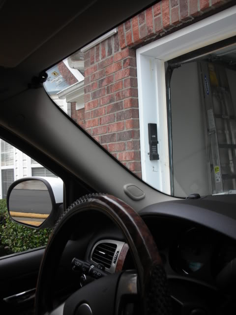

Here is a picture of my cabin after install
Mike and gps antenna installed on driver side top left corner pillar and dashboard respectively. ipod input installed on glove compartment.
