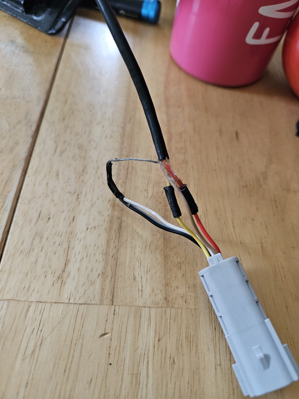

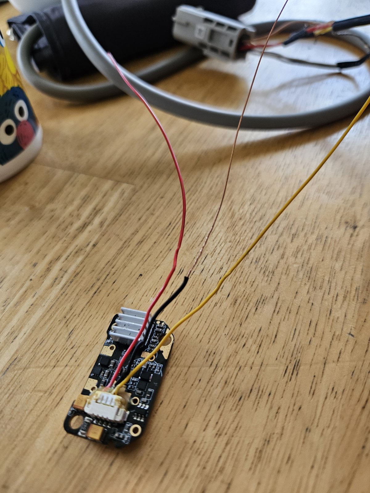

Photo of the aftermarket camera wiring:
Photo of oem camera wiring:
fatmonk8
fatmonk8
Mar 16, 2023
242
78
On the auxiliary camera I assume
Red - 12v
Yellow - video +
Black - video - (ground?)
On the oem I assume
Yellow - video +
Grey - video -

yellow is usually for video as far a/v goes, red & black and are power/ground
what the other wires are for no idea might be trigger wire's
you need to test yellow for video feed (while camera is activated)
then determine if power or ground is cut when the camera is switched off
that then tell's you which to use for the rear view video trigger on the mirror
then before final install, test with everything connected to be sure it's not going to cause a unexpected error

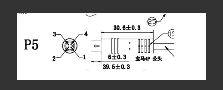

So I actually got the company to send me a diagram. Not sure why they don't give me colors, but by the placement of the wiring in comparison to the keyed plug I can see that my guess was right. My only issue is that the power is 5v not 12v.
"Here is the photo of the 4pin extension cable wires in the plug and the respective functions.
#1 is AHD signal, #2 is the ground , #3 is 5v power #4 is the back up signal trigger."
fatmonk8
fatmonk8
Mar 16, 2023
242
78
So after thinking about it,
I should omit wire #3 as the oem ca.era does not need power ran to it from the mirror system.
I should only use wire #1, #2, and #4. The the trigger wire should be hooked up the the cameras constant power I assume?
