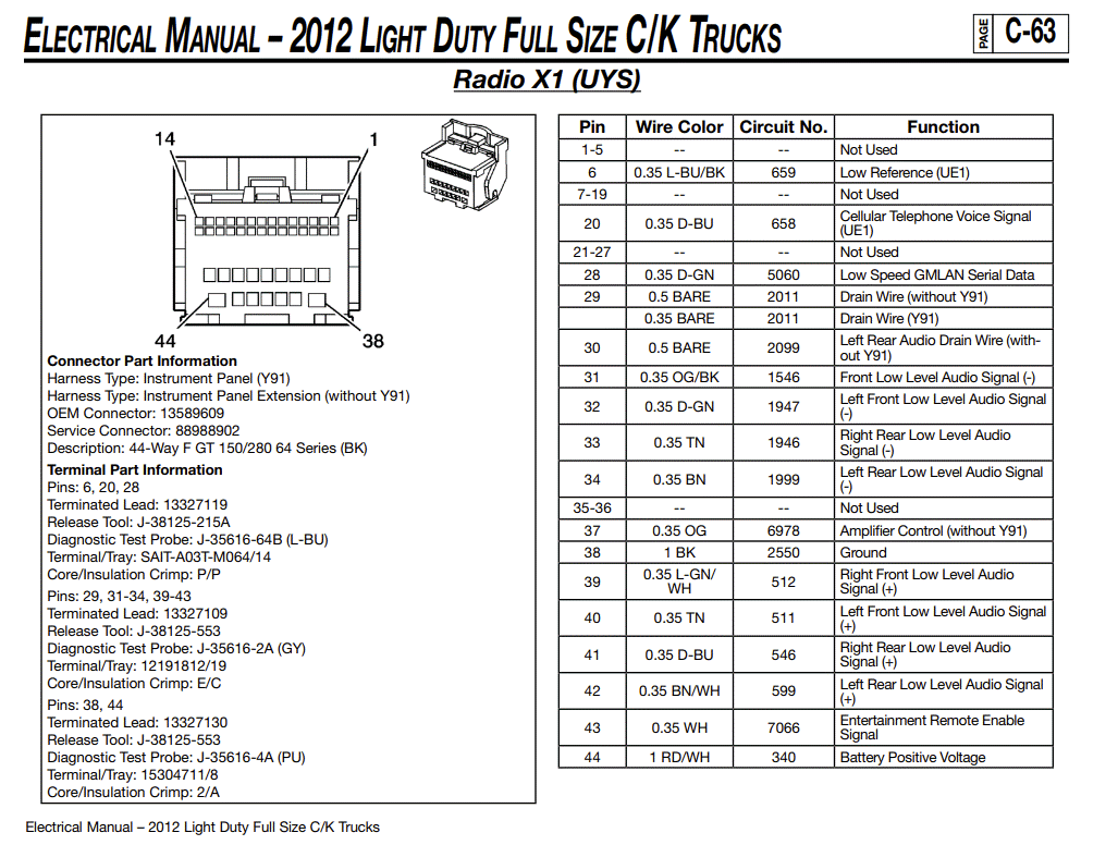

2012 Bose Nav with the 44 pin connector. 13 inch Android 13 HU installed. SWC working, back up cam working. NO SOUND
Where , which harness / pin has the Bose amp turn on enable wire? I just want the amp on for the android head unit.

the 2012 bose amp turn on signal is digital, you need a adapter/module to make it work.
