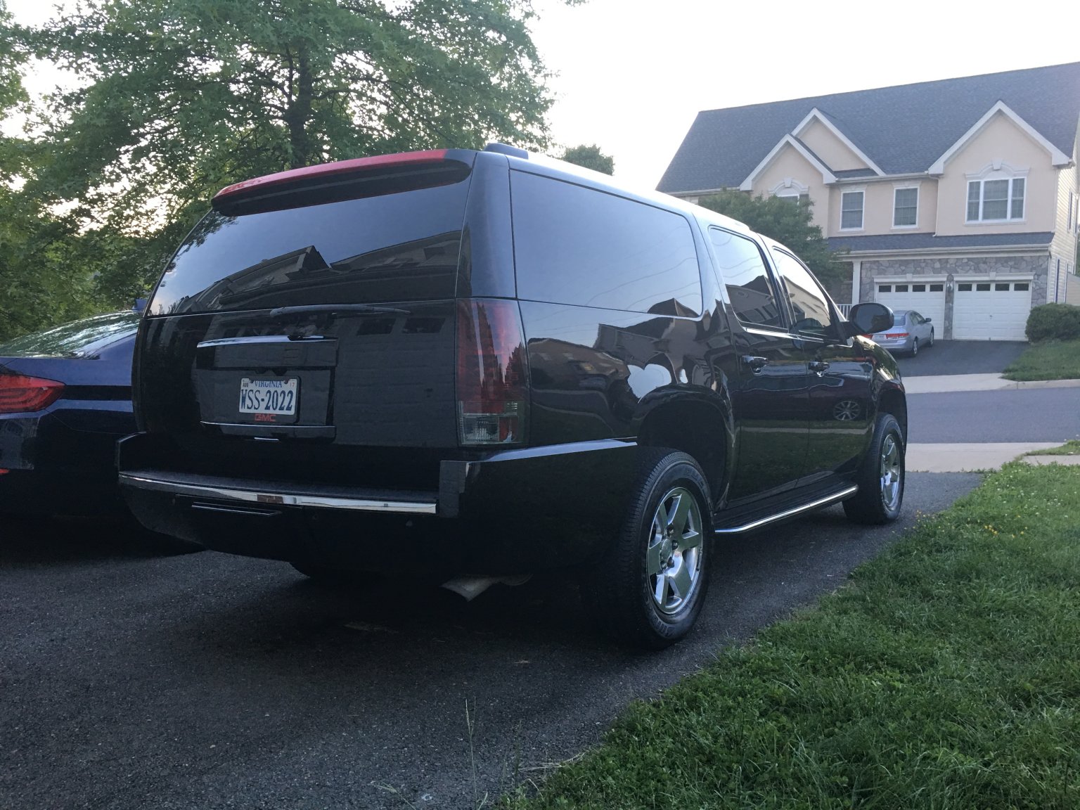

Just did mine Yesterday after getting bored with just a smoked Yukon 3rd brake light, Much happier now... considering g4 or g5 Taillights next.

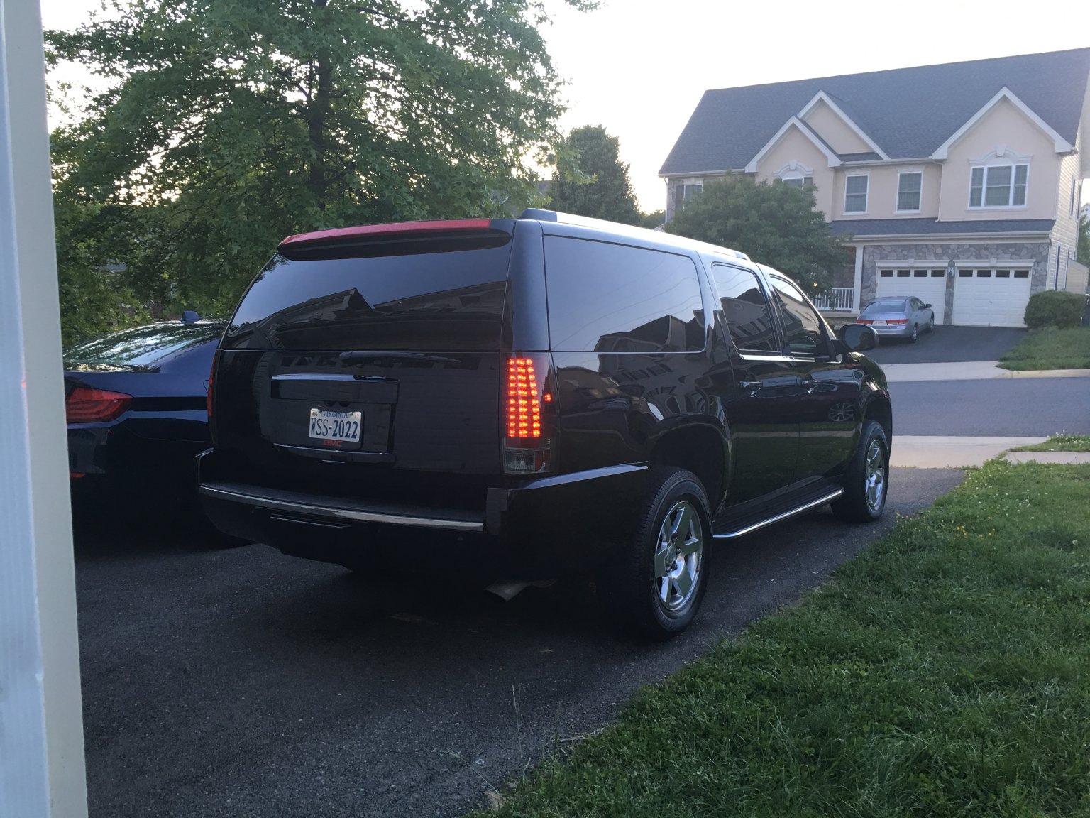

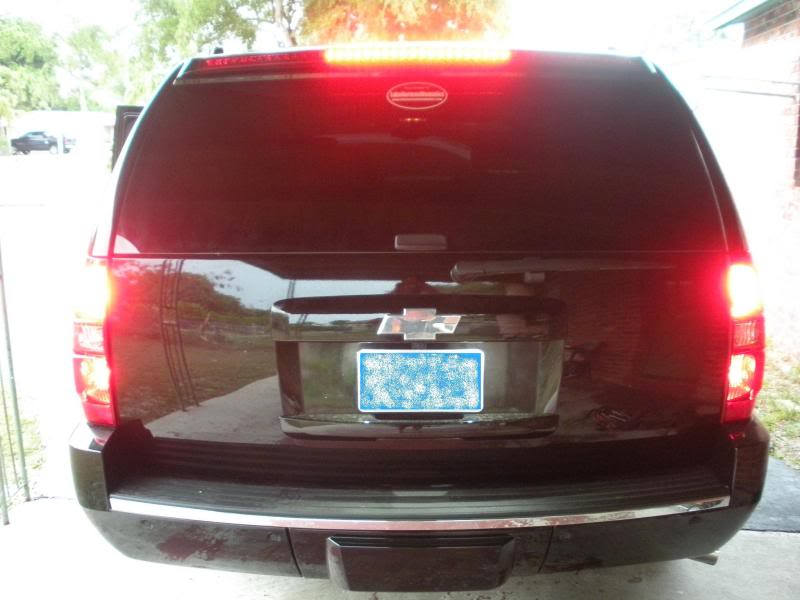

Here's mine wth G4s and full Esky LED mod.
@delightskinned1
View attachment 81531 View attachment 81532
Yea that's exactly what I'm looking for, unless I can find a set of black g5 appliques cheap... Is your 3rd brake light smoked or red? I noticed the LED go all the way across... aftermarket or custom?
Fosscore
Apr 16, 2014
10,885
19,845
3rd brake is all red.
OEM Esky.
Fully modded by Vegas Chris. He has done other TYF members as well. Cost is $200 plus shipping is your cost to Las Vegas.
I did a full write up in the last few pages of my build thread.
Pics tell the tale. Looks great. Should have been OEM all the way across, but alas now it is a unique mod for the TYF crowd. Love it though.

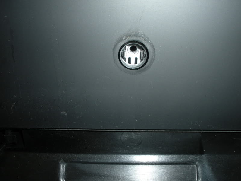

I don't know either.... I do know that they require a T25 torx bit... which explains why they stripped using an allen wrench... lol
I feel like I been lie to. Ally life, I have this Tset of bits (what I used that I stripped the screw) I always thought they where allenwrenches 4 a drill lol! God I'm dumb. I'll tKe a pic tomorrow to Show ya

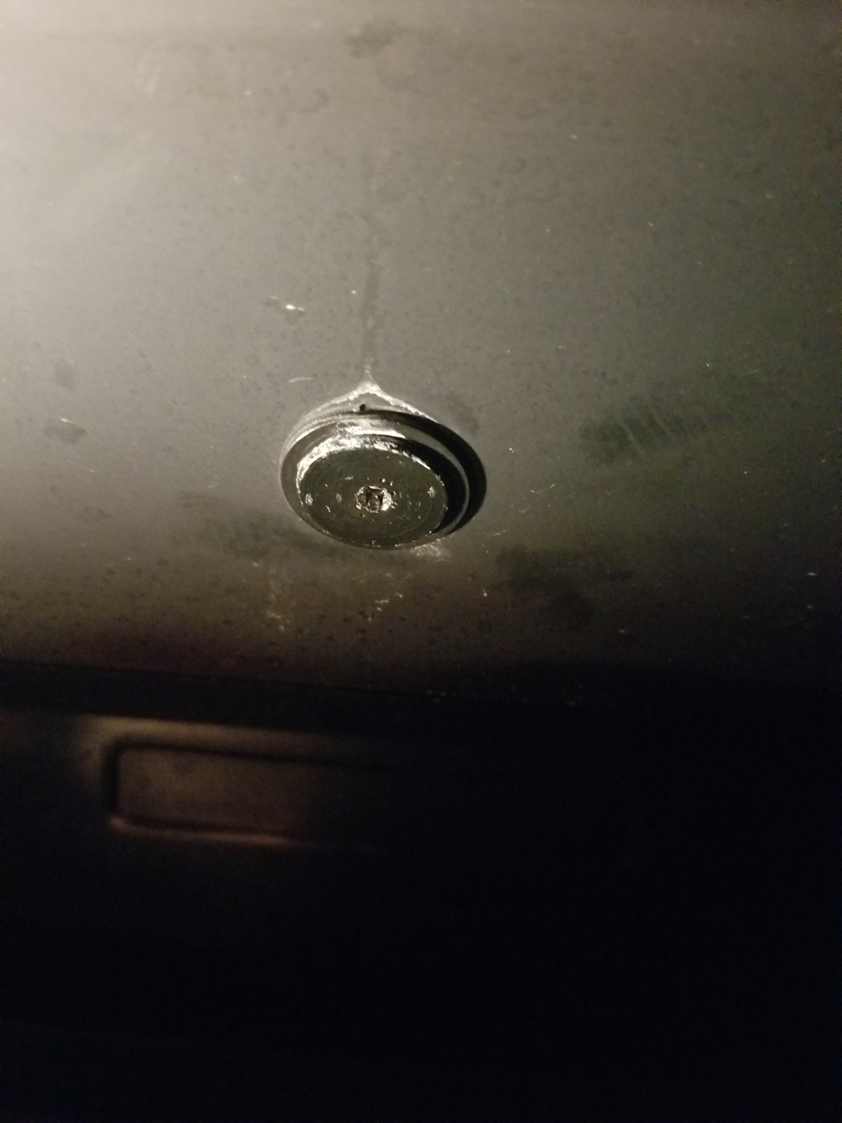

But how can I get those out any recommendation on what do you replace it with

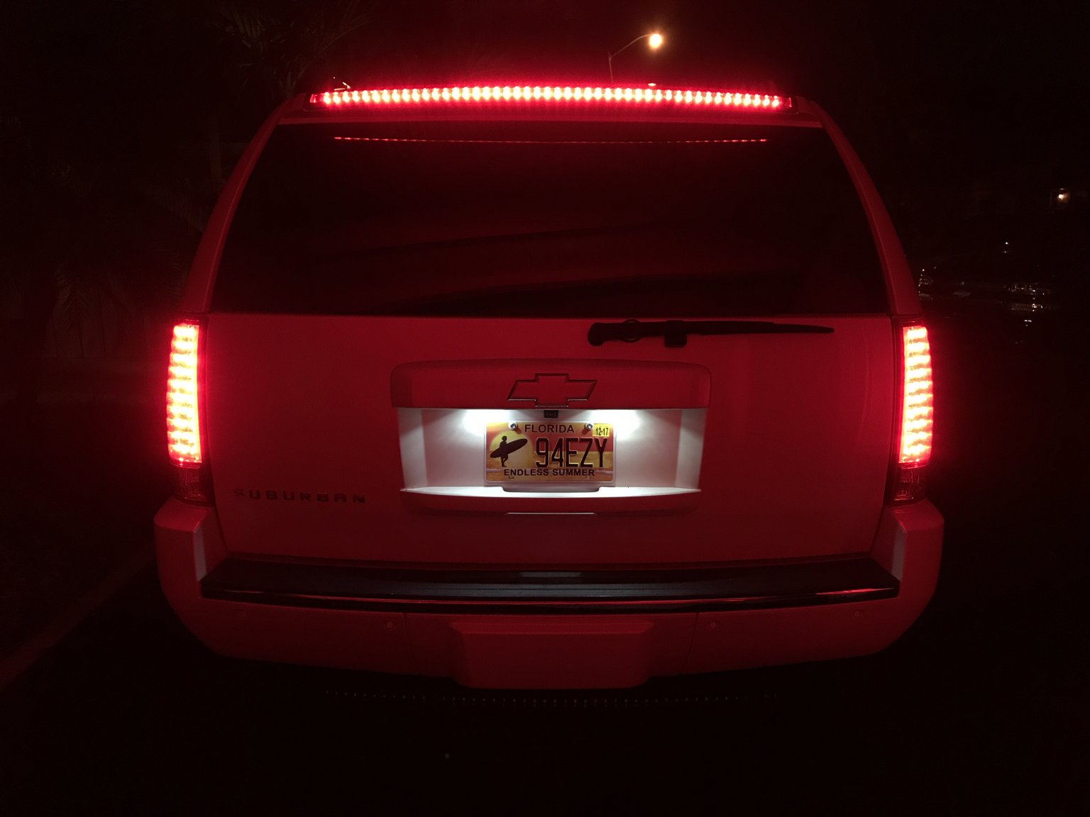

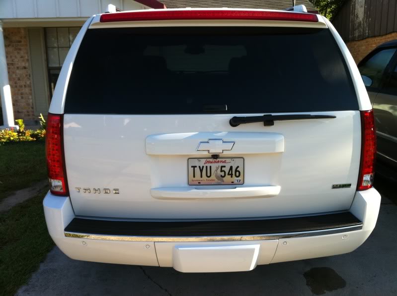

Didn't see a write-up on this so figured I would contribute something to this place. This is a VERY easy mod, takes literally 10 minutes if that.
With the help of Sumo, I was able to score an already painted black Escalade 3rd brake light from a 2008 Escalade, all complete, for $102.50.
Got it in the mail today and put it on immediately. Here's the how to:

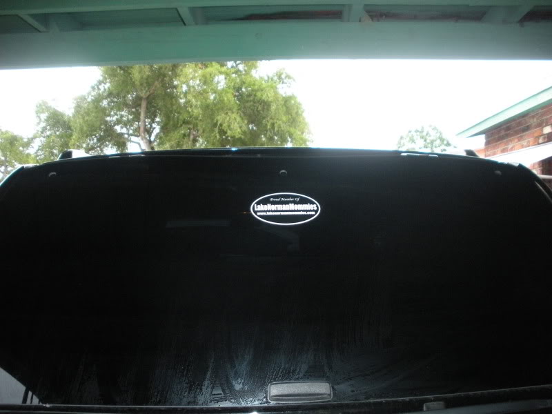

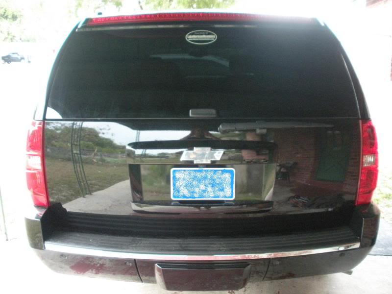

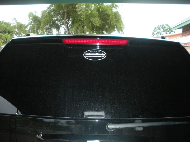

This is what your stock 3rd brake light on the 07+ Tahoe, Suburban, Denali, and Yukon's would look like..

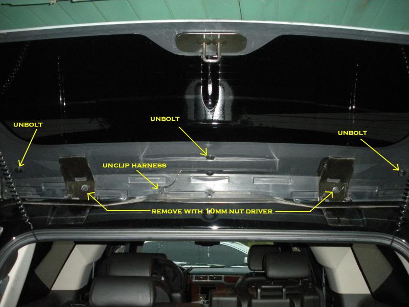

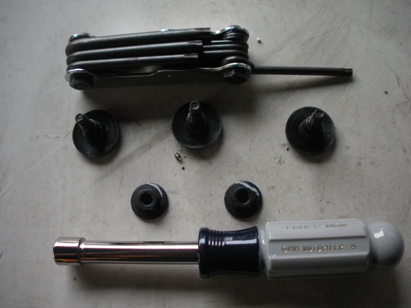

These are the tools you'll need: 10mm nut driver and a small star-bit. The two nuts and three bolts seen in this pic will be removed through this process and reinstalled with the new brake light.

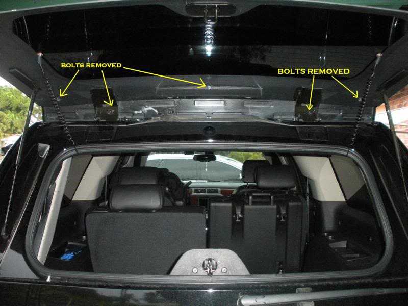

Open up the glass and remove the two 10mm nuts from the hinges which attaches to the brake light housing (as seen in the pic). Also using the appropriate star-bit, remove the three bolts as pictured. They should all come out fairly easy, with very little resistance. You can also reach in and loosen the harness in the picture, but don't attempt to remove it just yet!
This is what it all looks like removed:

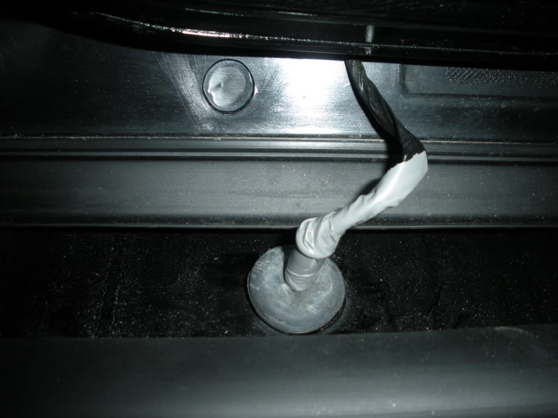

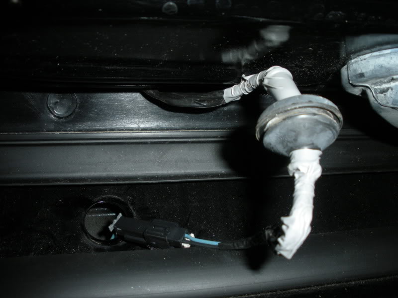

Now, open the liftgate up which will give you access to the wire harness. Remove the rubber grommet and pull a few inches of the wire out, it will come out freely without resistance. This will eventually expose the clip. Use a small screwdriver and pop the clip.
Now, close the lift gate gently, slowly lower the glass, and gently remove the old stock 3rd brake light.

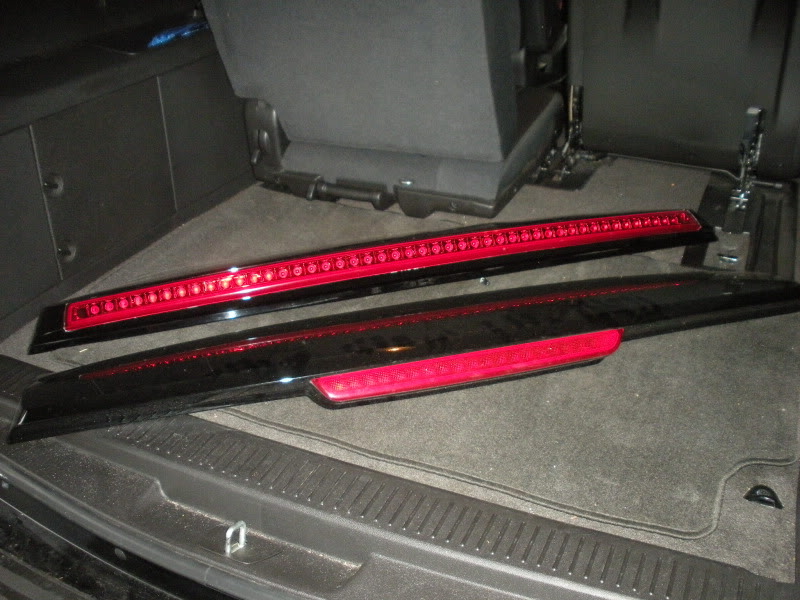

Wallah!
Here is the old next to the new!

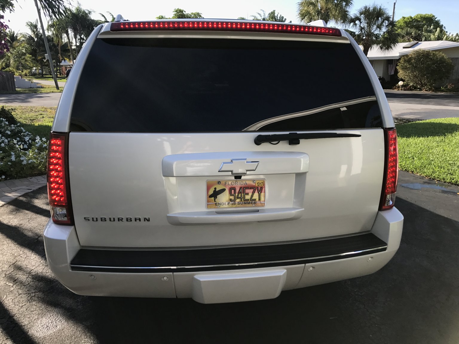

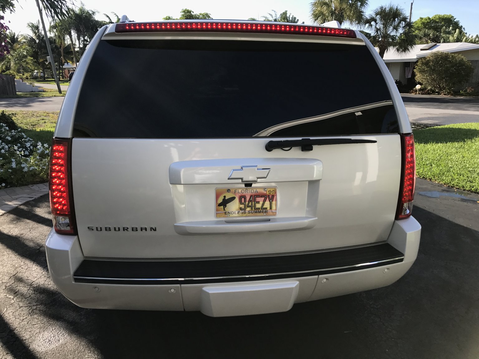

Now, do everything you just did in reverse! Here is the outcome!
Next up will be the Escalade tail light conversion. :Handshake:
