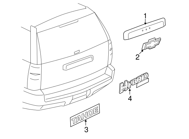

what does the applique have to do with the tail lights
you referring to part#1 on the image correct?
No sir I was talking about the piece above the tail. It’s got a hard body line that starts in the light and runs upward into it. Makes sense about the leds and all. I like the smoother clean look of the Escalades and think the oems looks lumpy.

oh the "d"

oh the "d"
Pillar
there is enough red ontop for that not to be an issue
try to correct me all you want and push your negativity but gm calls them appliqués. If you don’t like the escalade lights then don’t buy them. It must not be too big of a problem being too bright since it’s a factory part.
