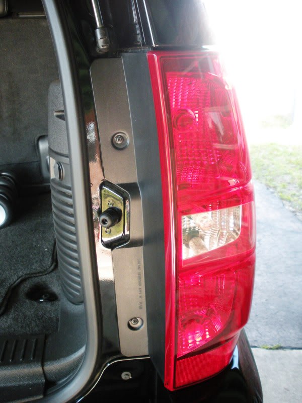

Remove your stock tail lights by using a Phillips head screw driver and unscrewing the two screws you see in the pic below. With gentle pressure, the tail light will pop out towards you after the screws are removed. Follow the harness down under the truck and you will see where it is attached to bottom. Unclip it and remove the tail light and harness assembly. Set aside.

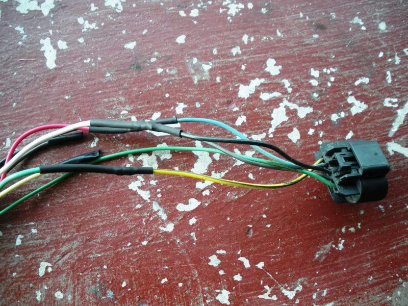

We're going to start modifying and splicing the Escalade Harness first. Peel back the wireloom until you get right about to the reverse lamp bulb. Cut the actual harness off about 4" behind the main plug, as pictured. Set the harness aside.
(pic below are both Escalade harnesses to show you how far to cut back)
Using this schematic, you are going to want to make connections between the Escalade Harness and the 4-wire side of the Hopkins Harness:
I cut the wires labeled "not used" till they were about 3" long, wrapped the tips with electrical tape, and kept them hanging loose until it was time to finish the harness, like so:

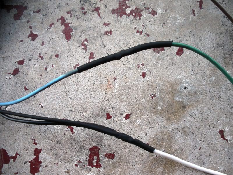

Now, on the Escalade harness, there are two black wires that are crimped down into one. I cut the crimp off to expose both wires, yanked about 1/2" of plastic off to expose the wire, and twisted them together while matching them up to the appropriate colored wire on the trailer harness.
I put the black from the Escalade harness with the White of the trailer harness, and the blue of the Escalade harness with the Green of the Trailer harness. Twisted them together like so:
Then Soldered them together:
And Hit them with the heatshrink:

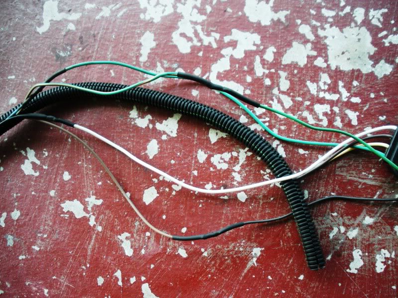

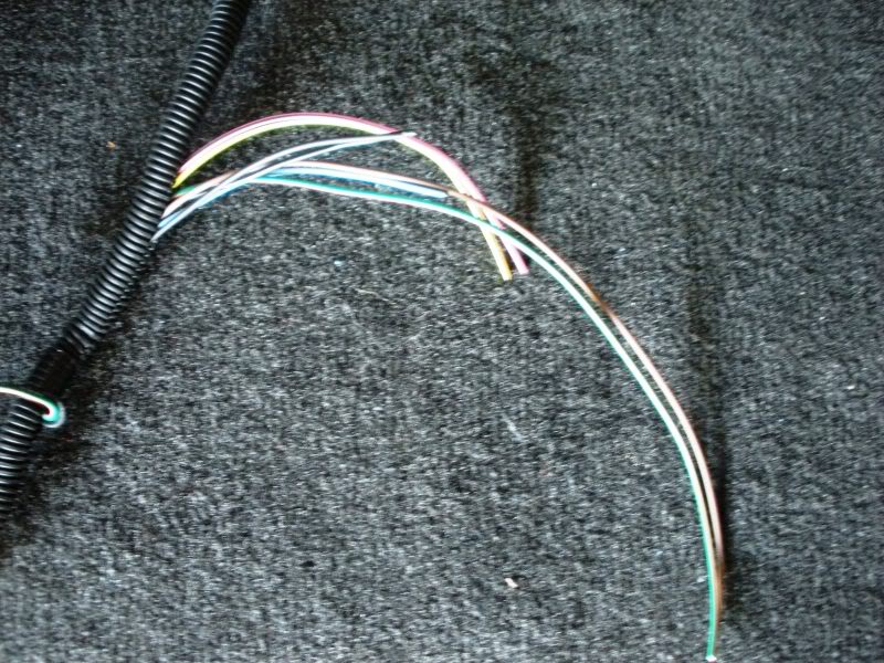

Now, time for the Tahoe harness. I pealed back the wire loom off the tahoe harness as far back as I could until I got to the first light, that's where I cut.
I left the brown and green wires as long as possible for now, and cut the remaining three wires (red, blue, and black) down to about 5" or so. The green and brown wires from the Escalade Harness get connected directly to the green and brown wires on the Tahoe Harness (do not wire through the trailer adapter!). Twist, solder, wrap, done.
Do the same with the remaining Red, Blue, and Black wires on the Tahoe harness. Utilize the schematic I posted above to show which wires those get attached to from the trailer harness. Twist, Solder, Wrap, Done!

Now, you should have a completed harness, except there are wires everywhere! Time for some organization! Use the wire loom and cut to appropriate lengths and tuck the wires away from sight. You should end up with this:
OEM looking, eh?

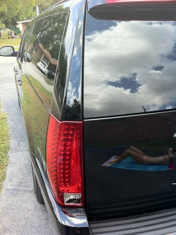

With that said... Here is your BEFORE:
And here is your AFTER:
NOTE: As you see, the Appliques above the Tail Lamps do not match up with the stock Tahoe ones. You need to purchase the Appliques from an Escalade and mount those in place of the Tahoe ones. I will be adding more to this thread as soon as I locate a set and install them. Until then, the tail lamp will stick out a tad past the tahoe applique, but it is hardly noticeable until you get close or physically look for the flaw.
I'll also be modifying the parts list to include hyperlinks of the exact parts I used.
6/4/11: UPDATE... Appliques are on and painted. Very easy to install, not even worth a HOW TO.... So, adding it to this thread. Completes the look!
