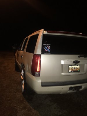

VLEDs doesn't sell the 6ohm/50w resistors anymore. You can google search and find the right ones.
You can put anything between them. Aluminum plate stock from Home Depot, for example.
I usually just space them out away from the Hopkins with zip ties.

PARTS LIST PRICES AND HYPERLINKS FOR PURCHASING:
Hopkins Harnesses (you need 2) at $9.42+shipping
http://www.amazon.com/Hopkins-48845..._1?ie=UTF8&s=automotive&qid=1306088173&sr=8-1
6ohm/50 watt Load Resistors (you need TWO of these at $6.99/pair, so 4 individual resistors. Total is $13.98+ship
http://www.v-leds.com/BlinkerWarning-Fix/Turn-Signal-Fix/6-OHM-50W-2-BULB-LED-p4783296-1-2.html
Mounting Plates (you dont NEED these, but I wouldn't do the install without them) $5.99/pr, only need one pair.
http://www.v-leds.com/BlinkerWarning-Fix/Turn-Signal-Fix/2-LOAD-RESISTOR-MOUNTING-p6841378-1-2.html
Tahoe Tail Lamp Harness (you don't NEED these unless you want to keep your stock harness) Roughly $40/ea (EBAY seller has them at $10+6 shipping per harness)
http://cgi.ebay.com/ebaymotors/07-T...294756QQ_trksidZp3286Q2em7QQitemZ260785044829
---------- Post added at 01:38 PM ---------- Previous post was at 01:21 PM ----------
PM for pricing :Handshake:
Thanks guys! Took awhile to get the harness down pat! Just glad I kept it clean and factory looking with the harness. Takes 5 minutes to swap back to the stock tail lamps if need be. :)

Since the OP isn't making or selling these any more I thought I'd throw up another option.
This only works if you have the trailer harness up by the spare tire or plugged into the back of the 7 way plug:
Buy this: CURT 56584 Custom Wiring Harness https://www.amazon.com/dp/B007EA6WQU/ref=cm_sw_r_cp_apa_i_JHO5AbWPJPPR0
Clip off the 5 pin plug and add two of these with associated pins and seals with some wire. You get a ground, reverse, brake/turn L/R and park.
https://m.delcity.net/store/GT-150--Male-Housing/p_810485.h_810490
Plug it in and go. Should cost less than $50 for everything brand new.
Only thing you would need to do is add a resistor to keep the blinkers from hyperflash.
I can assemble this for you if you don't like wiring stuff for a fee. Just thought I'd try to help whoever is still looking to do the mod.

Just did the swap tonight, the write up helped a lot thanks!
