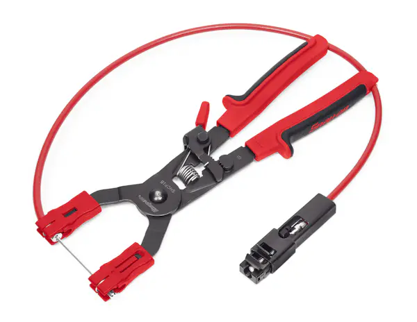

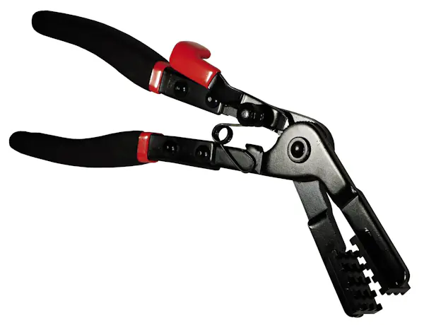

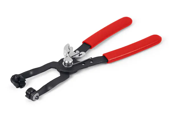

Those clamps are terrible--even though that's all I use. I like the constant pressure clamps that @OR VietVet always mentions. I actually need to get an assortment of various sizes of them. Glad everything turned out good, and your father had enough sense to shut it down immediately.
